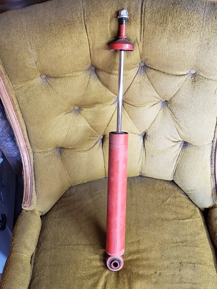

Bilstein shocks... whatchya gonna runnin??
I'm not a huge fan of the 5100.
Does the 5125 have pin top. I think it has universal mounts on both ends.
I'd be more likely to run kyb monomax on my xj than 5100s the mobo max is stiff shock that works very well off road and controls body roll on road.
Look at shock lengths for dodge pickups they have a pin top but do have a 9/16 lower so bar pin elimanators would need to be drilled out.
Picture is of a monomax I bought for my 2002 dodge 3500. It ended up on the jeep and worked extremely well.
It has about 8.5" of shock stroke.
I guess I should not talk bad about the 5100 because I only have experience with them on my pickup that is 9500 lbs with welder and tons of tools on it.
