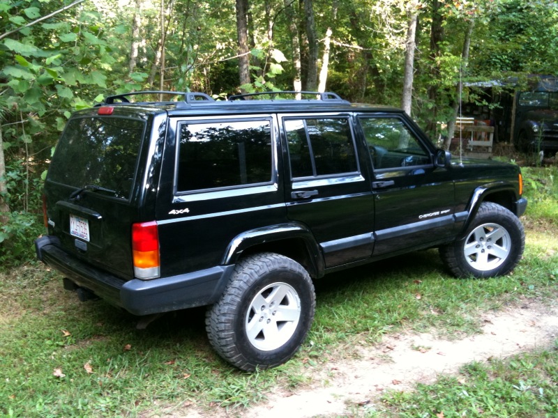

Thanks for all the input guys, I'm really looking forward to building this baby. Interestingly enough, you've inspired me on the high-pinion D30 point...
I'm planning on pulling a complete one from an XJ at LKQ this weekend (as well as another XJ front driveshaft and a 242 to begin rebuilding it and to get the SYE conversion out of the way). At this point, I'm hoping to do a bench build-up of these parts the coming months to give me time to buy all the other components and get the WJ brakes, new gears, and limited slip diff pre-installed (without impacting my ability to use the vehicle). I'm also considering doing an over-the-top conversion (from Rocky Road) to address possible suspension geometry issues (not sure since they only recommend it for 4" of lift or more). Doing the WJ brake conversion might pose some complications though, so this thought will require further research.
With the HP D30, will I run into exhaust clearance issues with 3.5" of lift? This axle will not be installed until the lift goes on. Remember this is a 2001 model, which from my understanding has a different exhaust system that warrants the LP D30 from the factory.
Does this sound like a good idea? I picked up my Moabs w/ MT/R's this past Friday, which has given me further determination to get this build going :D
