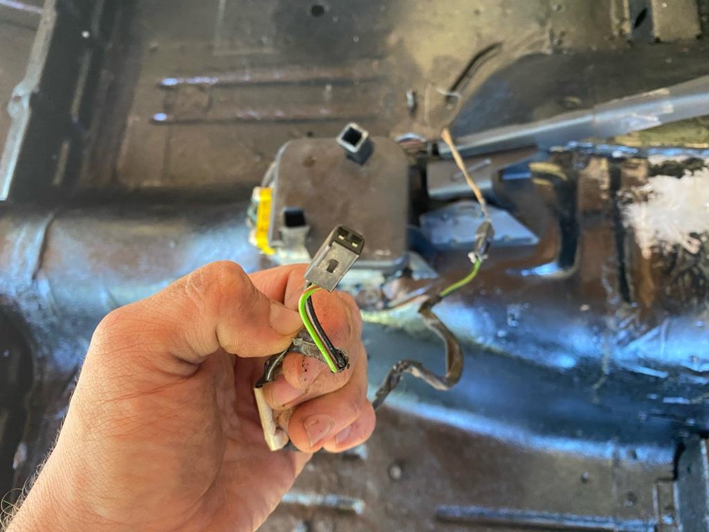

Welcome and congratulations on your new jeep! Did they keep the downstream 02 sensor on or was it cut off with the rest?

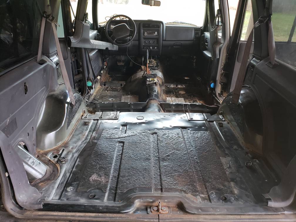

Pull the seats and console, remove the one piece carpet and haul it to a DIY car wash or use a pressure cleaner and a lot degreaser on it.
They usually clean up well and will smell a lot better.
Unless you are building an off road only toy, put the carpet back in for all the reasons already mentioned.

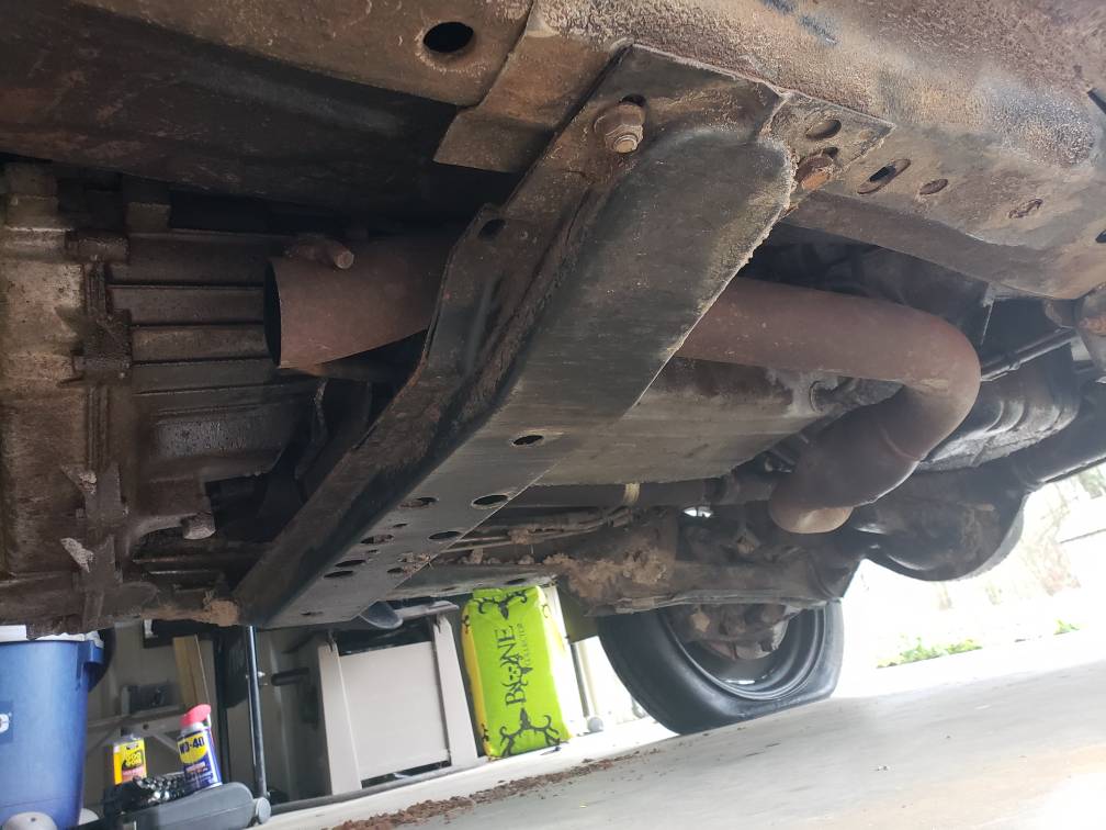

I took a picture of where the exhaust was cut off. Not sure where the 02 sensor is supposed to be, but I didnt see one so it's probably gone. Not sure why people feel the need to cut the pipe instead of just disconnecting it at the flange. Makes my life much harder.

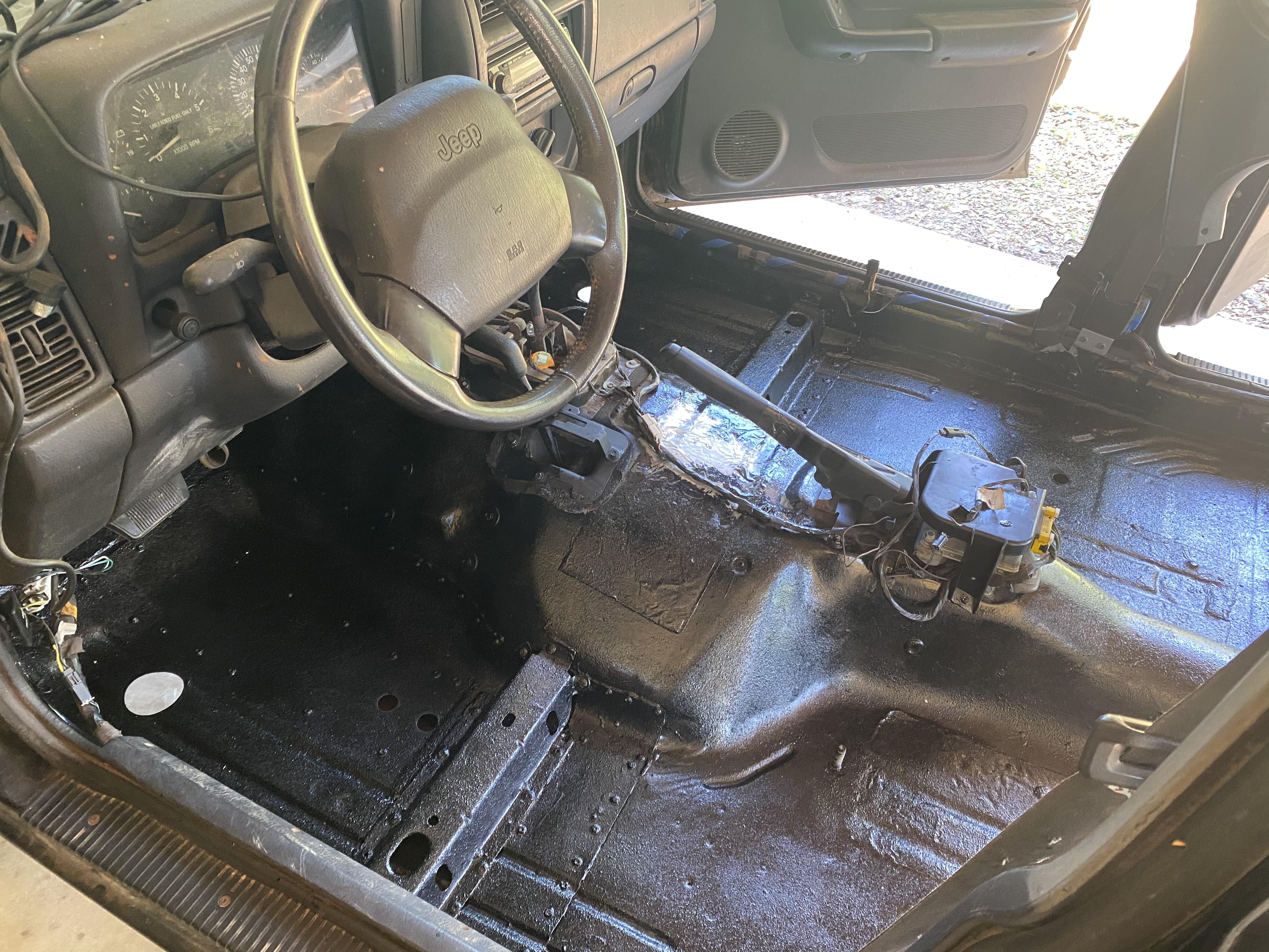

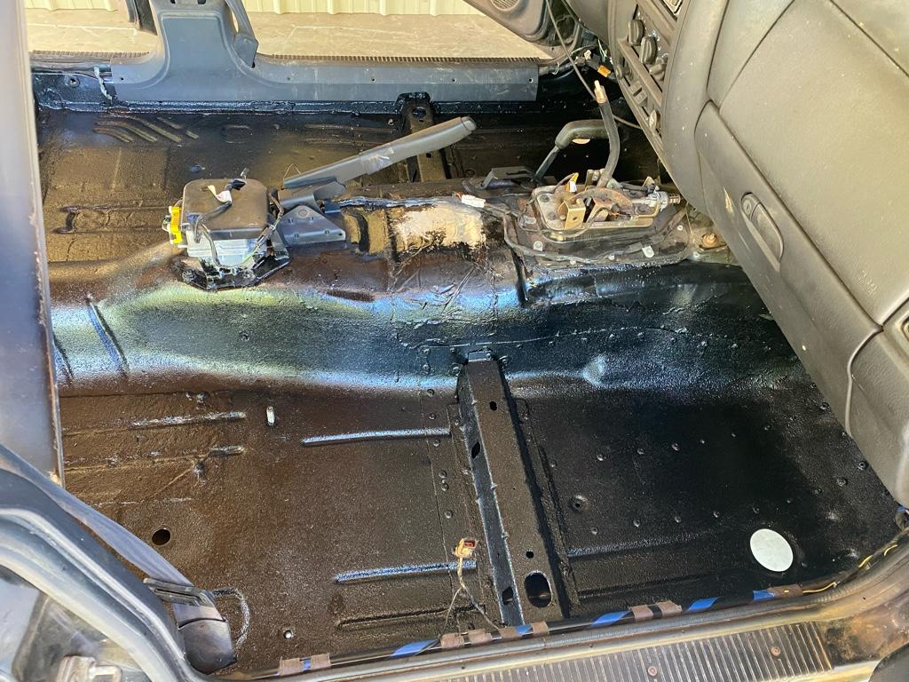

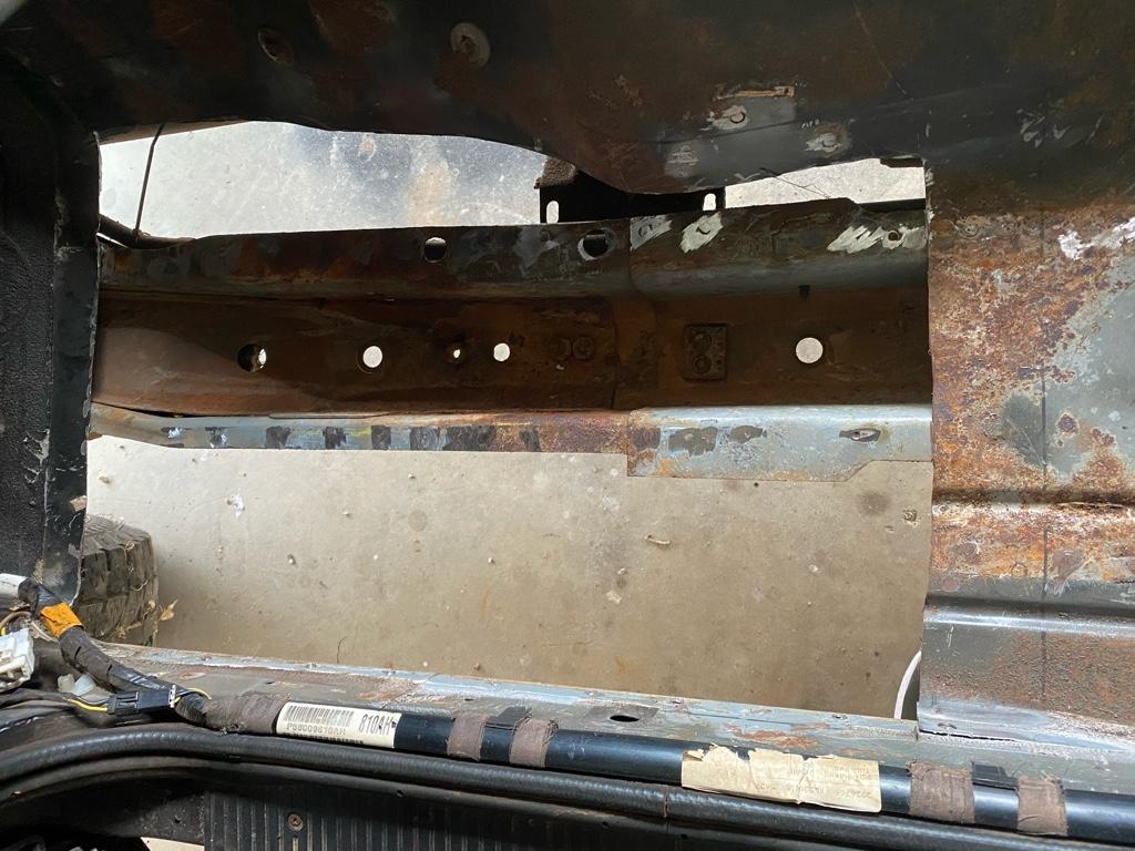

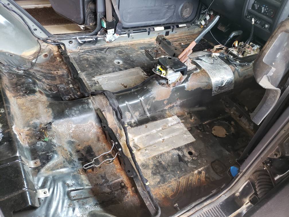

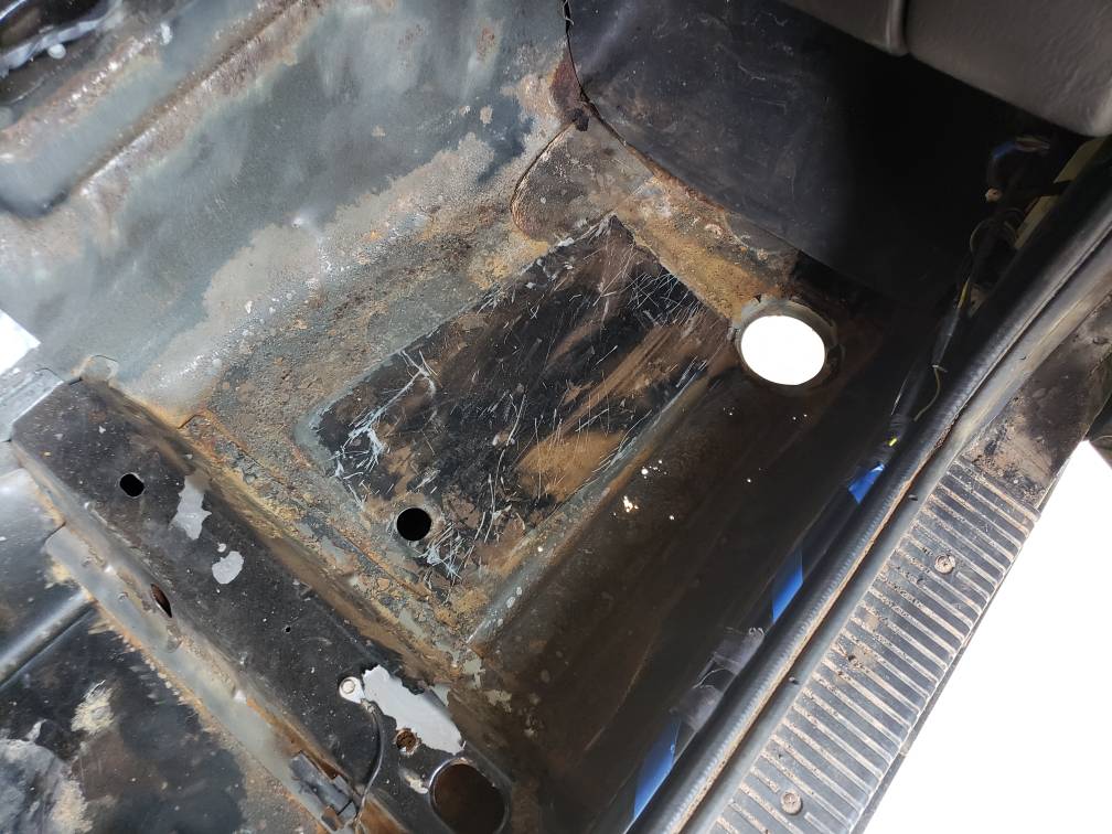

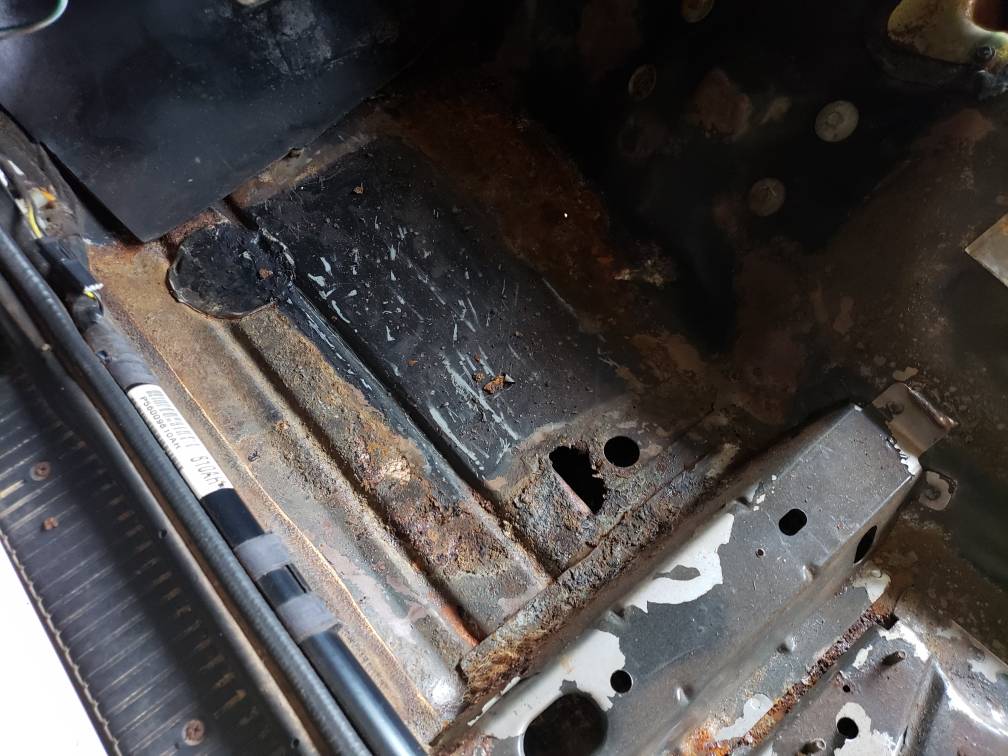

Got a chance to pull everything out of the inside and pulled the carpet. Sanded on the major rust spots with a wire brush some and hole started to appear in the front driver's floor pan and a few in the passenger. Everywhere else looks fine. Went ahead and ordered a driver's floor pan and am trying to decide whether to patch the passenger or just get one for it too. Got some pics of it as well.

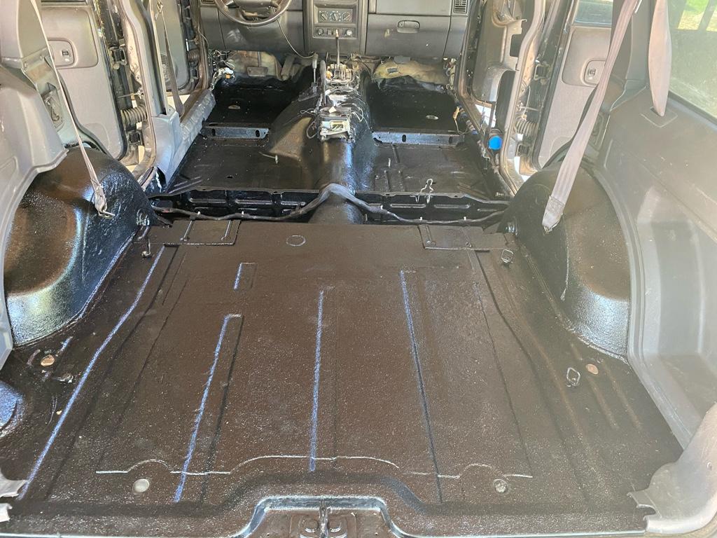

Yah I had already ordered chasis saver. I have used it in the past and liked it more than por-15. Also got the bedliner as well.
As for the leak, it is going to have to wait until I get the floors situation finished first. I will get my wife to use the water hose to target the common problem areas to attempt to figure out where it is coming from when I get to that.

I'd suggest lizard skin vs the bedliner route.
https://www.lizardskin.com/
It will give you some sound deadening and also helps with the heat. Most everyone that takes out carpet and drives more than on a trail regrets it. Check out DutchVdub on here. He put the lizard skin in his rig.

Those passenger side flooboard hole should br able to be epoxied or siliconed no problem

I wouldn’t put a new floor pan in with that little of damage
I’m thinking of using fiberglass and using the chassis saver as the resin
There is a post somewhere here where that was done with por15 — seemed to work great
There is more than this picture shows. There are pin holes com ok ng through on both sides along with the big hole and I am not done hitting it with the wire wheel yet. I figured it would be just as easy to just throw in a new floor pan and not have to worry about ok it its integrity.

There is more damage than what can be seen in this picture. There are pin holes on both sides and I havent finished sanding it with the wire wheel yet. I figured it would be worth it to just throw a new pan in there and not have to worry about it.
