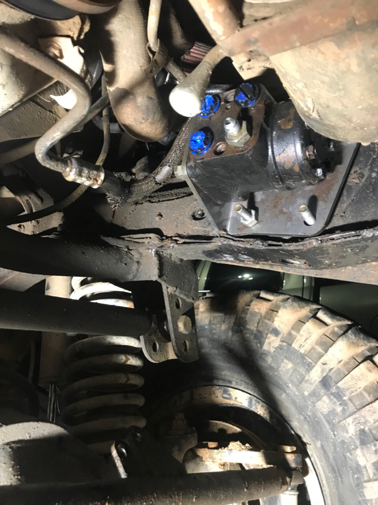

Okay so some update on the Jeep. Its been a good while since I've touched it, trying to get through the summer semester. I have 2 weeks coming up between the summer and fall semester that I' going to try to use to get this thing fixed up and hopefully with the help of another set of tires get it back on the road again for little trips here and there around town. Once I got it back from AOP I pulled the front bumper and steering box off, cleaned up all the gunk and inspected the extent of the damage. The crack starts right in front of the track bar mount about .5-.75" up wraps underneath and up the back side about .25-.5 up. Gonna order a driveshaft next week and hopefully a steer in brace then or shortly after. Then gonna get it over to the shop and start to fixing. Bought some steel plate to add to it over the crack once I weld it up and add a track bar brace as well. Hopefully all of that will fix it for a good while. Picked up a new hatch today, need to get it painted and on the Jeep. After all of that I should be good. Trying to have it done again before school starts in the fall so I won't have to worry about it then. Might go on a small trip or two during that time and trying to plan a bigger one at the end of the semester towards christmas but we'll see. I'll post more updates and pics as they come.

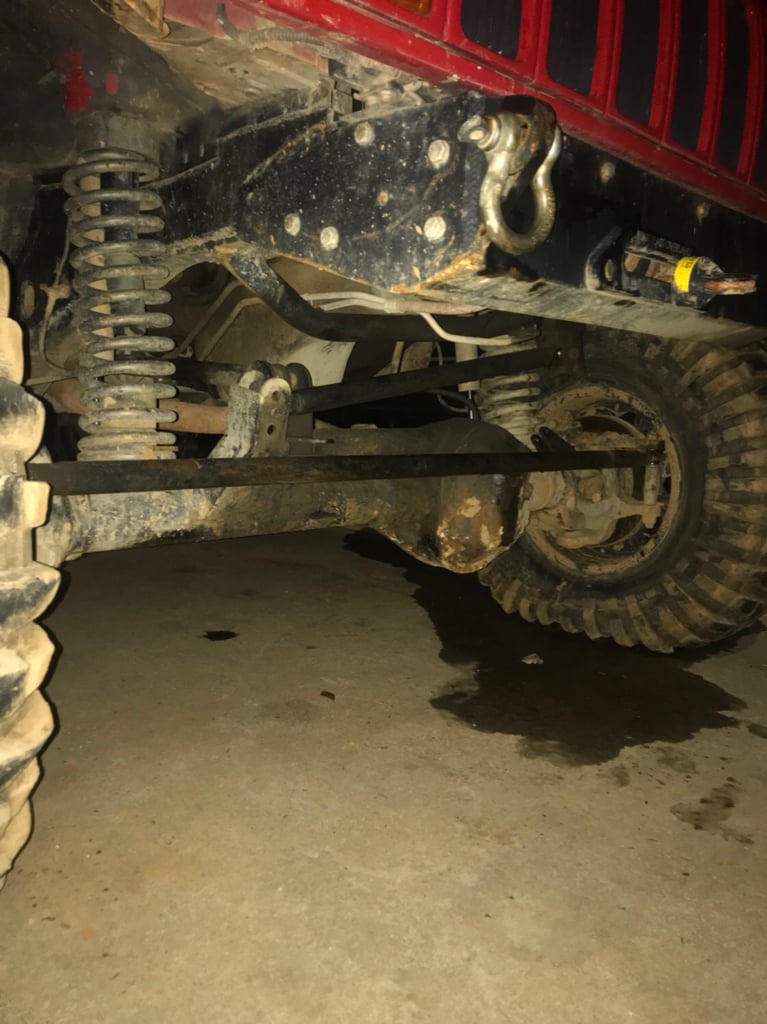

Got to work on the Jeep the other day.. Made some templates, cut some plate and got it all welded in. Luckily the frame doesn't move anymore but Im not stopping there. Still going to brace both the steering box and track bar to the other frame rail. Im still unsure how I am going to brace the track bar because everything is too tight to just run a piece of tube to the other side, but I'll figure something out.

You could probably mimic the 'iron man 4x4' style track bar brace
Or, with the right bends I bet you could squeeze a tube brace in.
I'm about to start mine, I have the same track bar frame side bracket, and same general track bar setup. I'll post some pics when I figure it out, if you don't build one before me.

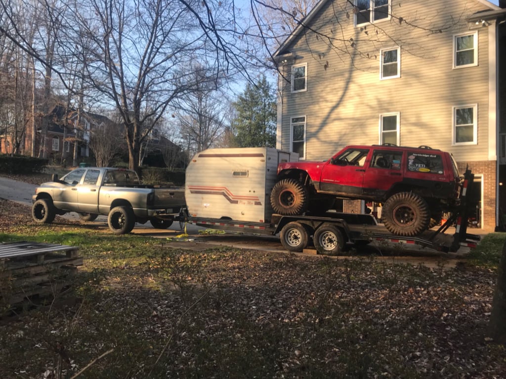

Few more updates. Got the Jeep pretty much done today and back home. Ordered a steering brace today so hopefully that should be here monday. Got a track bar brace made yesterday. Took it out and flexed it to the passenger side to see how much room I had. Surprisingly everything thing clears using 1.75 DOM. Got the ignition issue worked out also which turns out wasn't and ignition switch but a loose wire. Ran into another issue though. Bolting my bumper back up my winch doesn't seem to work anymore but that is the least of my worries right now. Will try to get the new hatch on tomorrow. I was gonna wait tip i got it painted but with all the rain we've been having I'm just gonna get it on and run it for a little while. At this point I am working on getting it back on the road. Need to have the rear end reset up and try to find some more street able tires but there is no rush on any of those so I'll just keep y'all posted..

Alright so been getting settled into another semester.. Got the new hatch on but I am picking up another one hopefully tomorrow but this one is red lol The rear end turned out not to be a rear end but a locked up caliber which was relieving. Also picked up some road tires for cheap. Some 37" Goodyear OZs with some random steel wheels. Took it for a spin but need to get some locking hubs so I don't mess up my wheel bearings because these isn't enough support for the stub shaft if I just take the slugs out. Finally I got the steering brace on. Heading to Gulches in the morning to see how she does since I fixed the frame.
