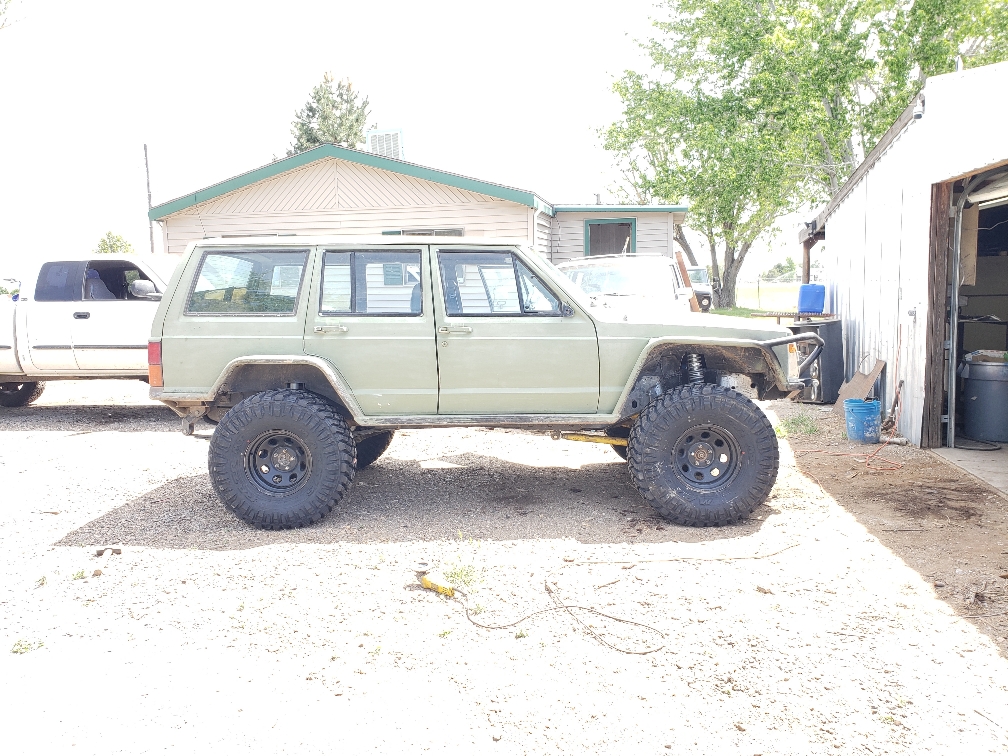

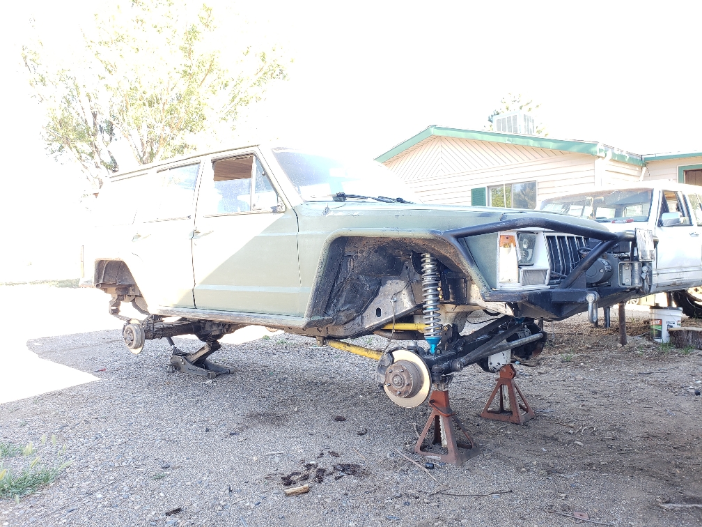

Today. Finished yanking axles out of my mockup rig. Then I wanted it off the ground for future mockup up.
My stands survived dragging it around

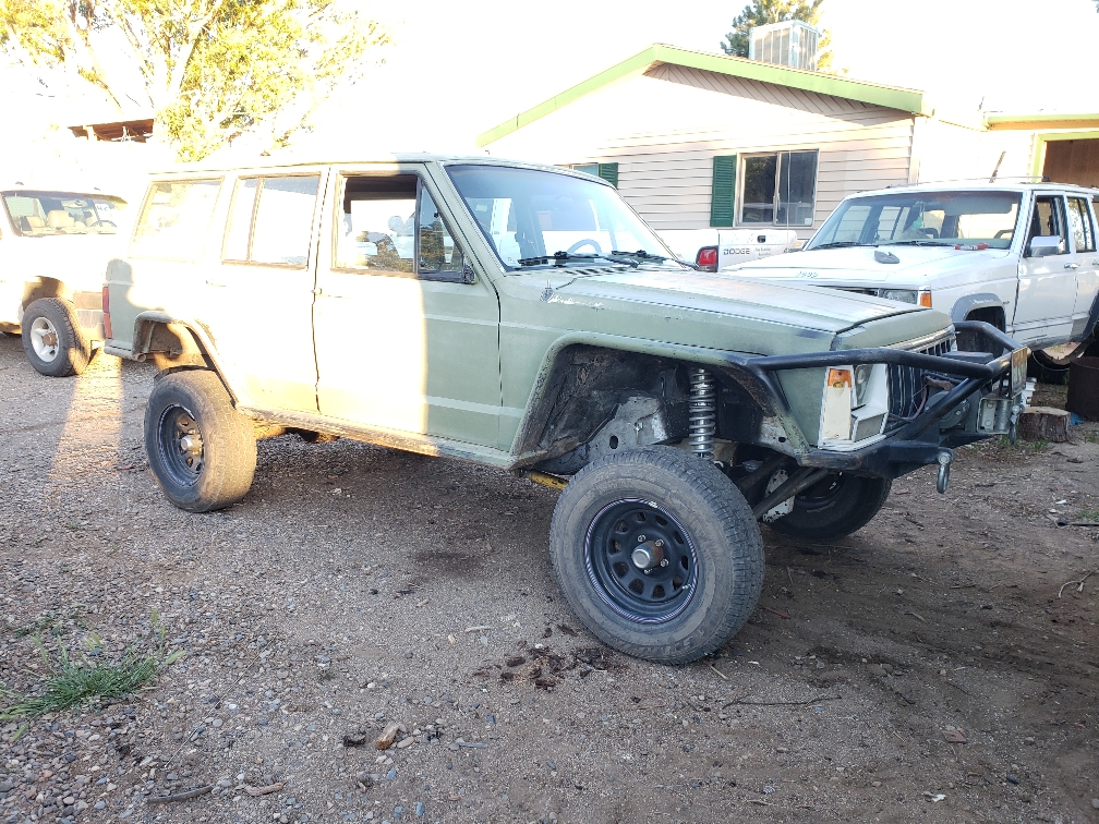

Here's the vid. Been 5months since I layed it on its side to pull transmission.
Yanked off uneeded lower portions of front fenders is now ready for bumper mock up.

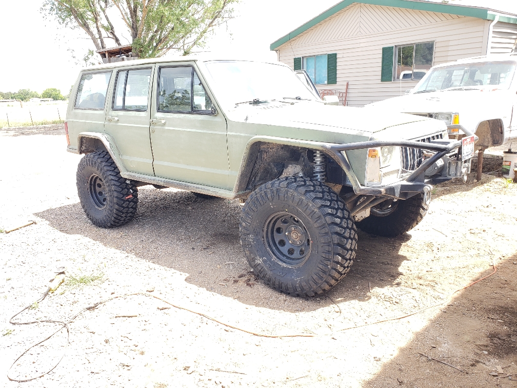

Here's the pics. Im sure it warped but I don't think its critical.
I cut the bender tabs and tried to clean up the burn through from the other side. Fully welded inside and out.
It's 3/16" plate not sure im crazy about that but I guess its going to work

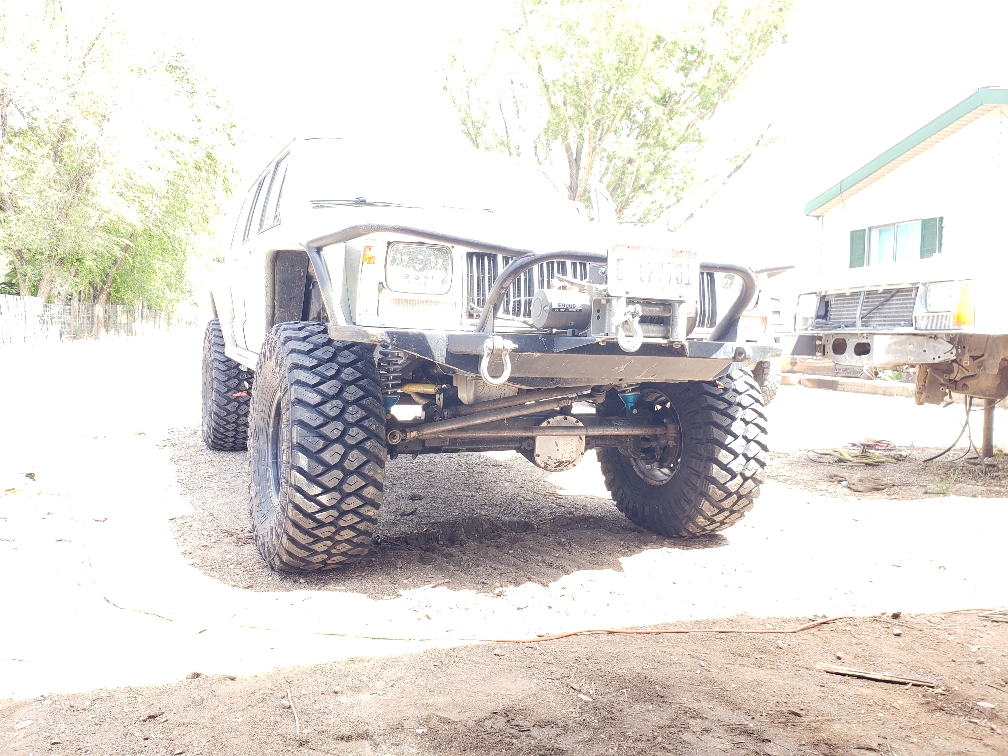

Test fit.
This sticks out about 1.5" farther then what I built on my jeep my winch is on the extreme top instead of the bottom like this one.
For all but the most extreme angles this one doesn't do to bad for approach angle.
Also surprised at the fitment. This is the 148$ ebay kit.
I did no mock up on the jeep only checked mounting width before burning winch box up.

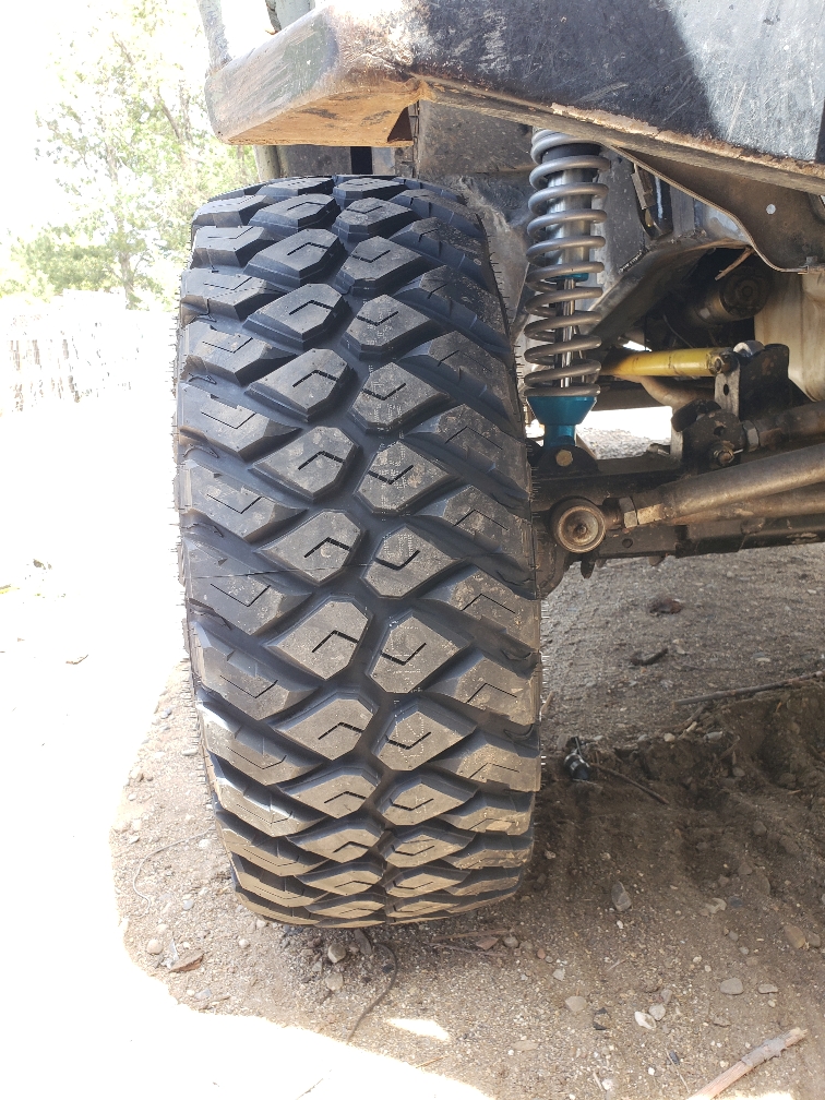

Been awhile since mines been in for work.
Decided I want to plant the front end alittle better. Made a upper arm bracket to raise it total of 1.75" in the upper hole and lower raises about .5" over where it is now.
This will give me an adjustment range of 7.5' 8.75 and 10 of axle seperation . Plan to run in the 8.75 spot. They lower arms have two positions thats how I get the 10". Ill save that for when if I go bigger than 33" tires.
This bracket at full stuff just barely clears frame and oil pan actually fits just between them. Going from 2 5/8 to 2" wide bracket to help this tight clearance and down to 1/4" whats in there now is 3/8" tabs at 2 5/8 inside width.
Picked up 40' of 6x1/4 plate so ive got material to play with
Can't decide if I make my own frame stiffners or just buy some then finish my frame side control arm brackets.
I thought I had a spare 7/8 heim with 2" wide misalignment but offcourse i can't find it so I'll have to order one before I hack the current off the truss.
