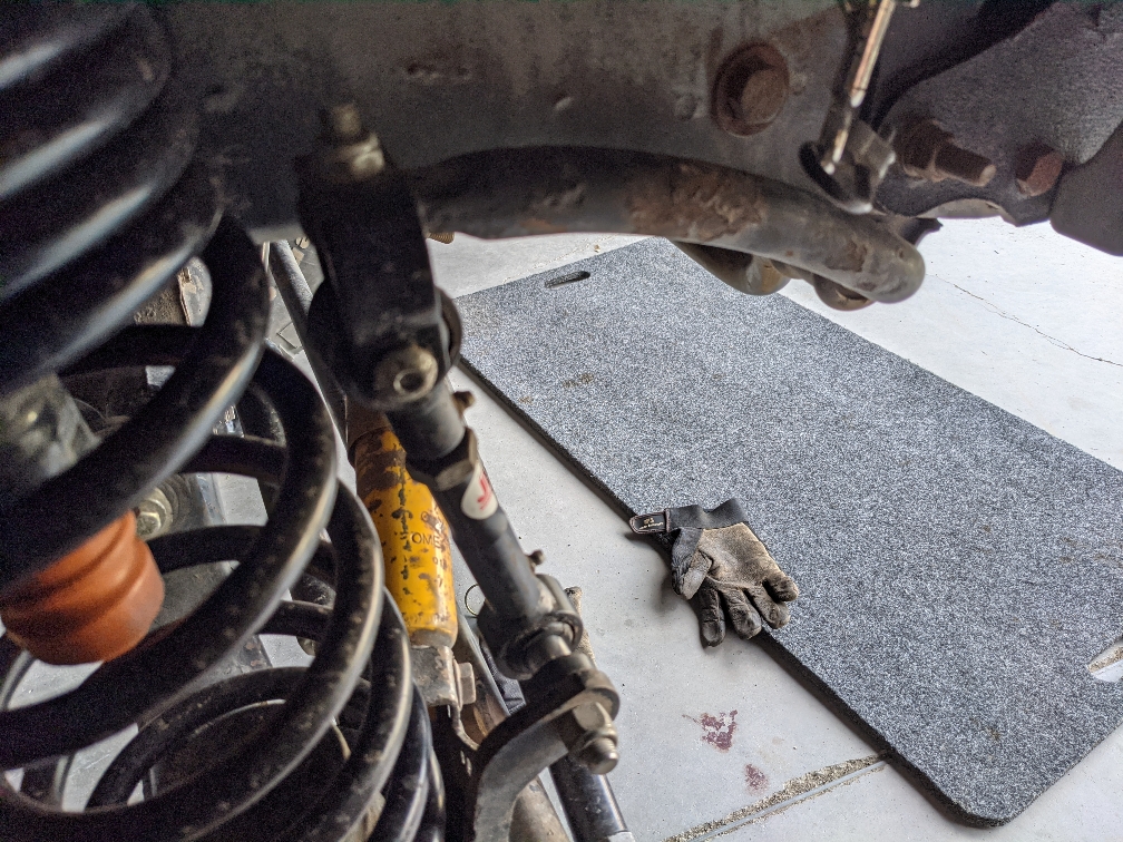

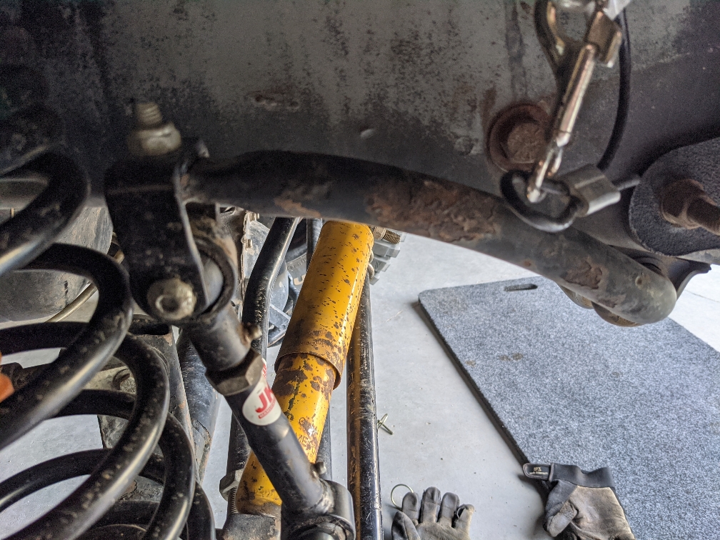

Is there an optimum/preferred angle for the swaybar? Have JKS discos and with new springs wonder if adjustment is needed.

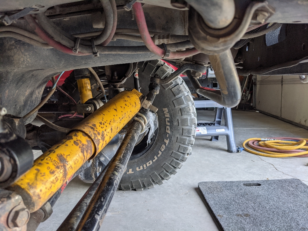

Your links are definitely to long and you need relocation brackets for the swaybar. The swaybar should be close to flat right at the link attachment point. No, if your want that much wheel travel with a connected swaybar you will have to go Currie anti-rock.

Looks like time for swaybar relocation brackets. I'm guessing the discos should be close to vertical; mine are at 16* and close to the springs.
The factory XJ swaybar is meant to have the ends of the bar horizontal when the vehicle is at ride height. Yours is not off by that much.
Swaybar relocation brackets are generally intended to move the bar down to allow using factory-length sway bar connects. Most are not designed to move the bar fore/aft. One exception is the RC relo bracket. Its slotted to allow fore/aft adjustment, but it also moves the bar down further than most.
I had to install swaybar relo brackets to allow my swaybar to clear my IronMan4x4 steering box brace. I also was having the same issue with you of having the swaybar come very close to the spring, so I slotted my BWE sway bar relo bracket. I think I was able to move the bar 1/4" further away from the spring which was plenty.
Anyhow, I'd say that if the sway bar is not hitting your springs, I'd leave it alone. However, if want your sway bar ends to be level, you might want to consider just hacking down the length of your JKS quick disconnects and rewelding. Or maybe JKS will sell you a shorter connector. It looks like they have a variety of lengths.
Re-reading JKS instructions online - they want 10 - 20* angle with 15* "Ideal". My first rough measurement was 16* so I'll check more closely with a straight-edge according to their drawing for better accuracy. Looks like I might have a little adjustment left to shorten slightly. With around 1/2" clearance to the spring and the ride just fine, I might call that good. Was no issue; I just wondered if there was an ideal.
