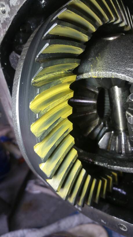

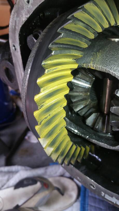

Hello,
Could I get some feedback one my gear pattern. Its a Dana 30 HP with 4.56 gears. Ill post backlash and shim specs later. Let me know if this looks good or if it can be better.

That's not a read-able pattern, needs more pressure(load) on the gears.

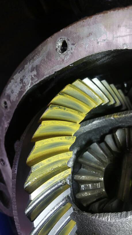

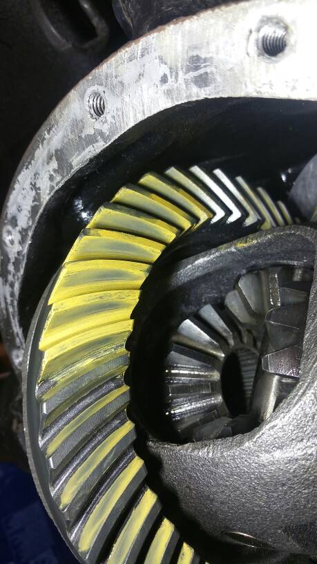

ok, so I get to fine tune my pattern and this is what I got.
NRG= .0785
RG= .02055
BS=.008
Pinion shims=.059

Too deep. Try adding less shims. Let us know if you need help, you can always send us a msg

Really deep. Pull. 009 out of the pinion shim and reset back lash

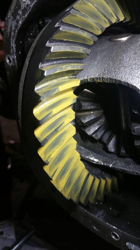

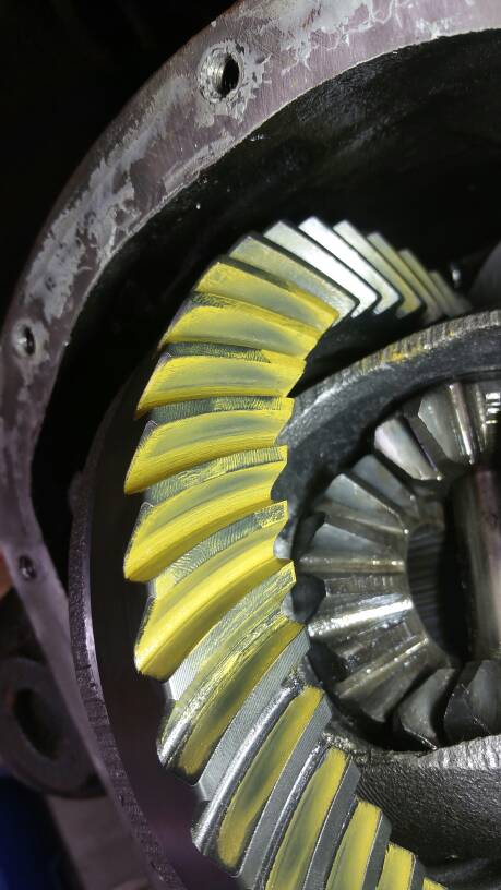

Thanks for the advice. My pattern looks way better. This is the best I have gotten in a while. It looks close but I think it could be better. Let me know what you guys think and any suggestions.
NRG= .05590
RG= .04165
Pinion= .0355, Add .0204 for the baffle
Backlash= 10

Tighten up the backlash and pull another pattern.

Dana 30 Pattern Check
Ok so two pics are with a backlash at 6 and the last two are at 9. Let me know which one is better.

Neither look perfect but your "patterns" are hard to read. What's your run-out on the ring gear? I always check that, with a full turn pattern under as load with as much pressure as I can apply. It looks like it wants .007-8" backlash!

Ring gear/carrier side to side movement(as in changes/variations) in thousandths! That's why I recommend a full ring gear pattern check.

Also don't try to read the drive and coast side at the same time.
