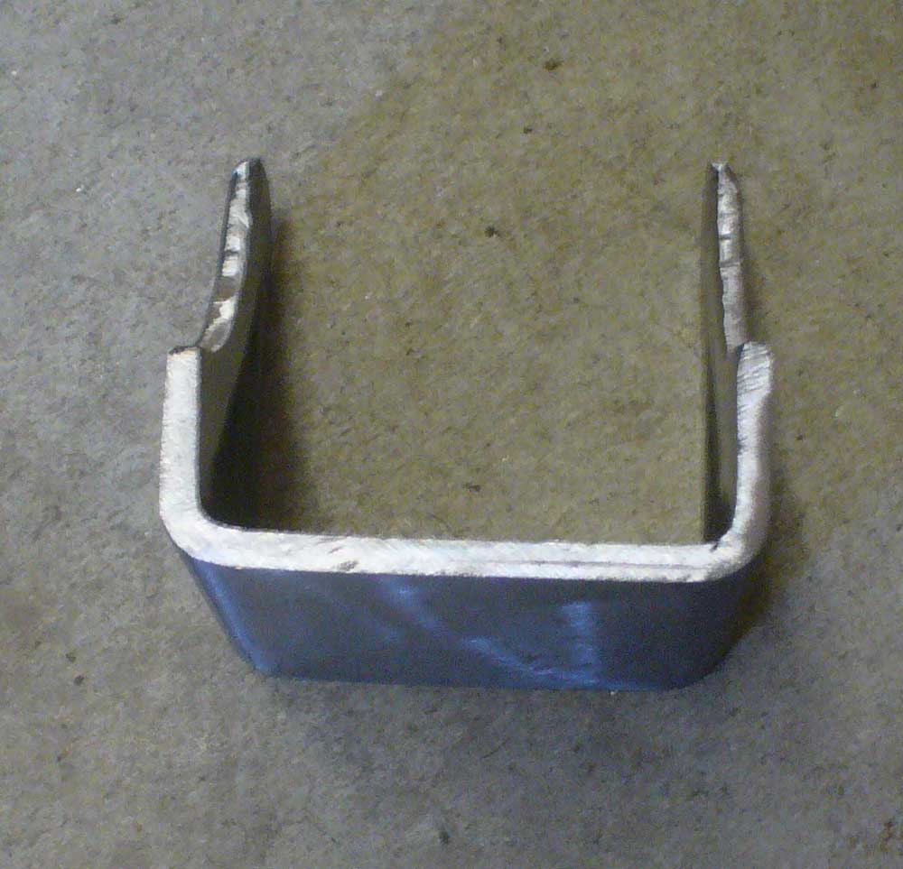

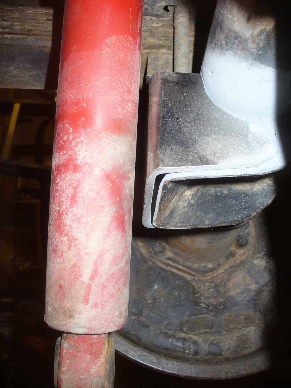

If you are up to making something like that, take some measurements and you may find that it is best to make that out of 3" square 1/4" wall tubing. The 2 1/2" inner dimension is a perfect fit over my factory brackets. A little persuasion from a hammer for fine tuning the location and no need for clamping challenges.
Bracket:
Fitment:
This will get the bolt/stud kit referenced above.
If you go this route make sure you leave room on the inside for the threads and nut of the stud. The factory bracket comes in at an angle on the inside. Put your stud down at the bottom and there is no room for the nut.
