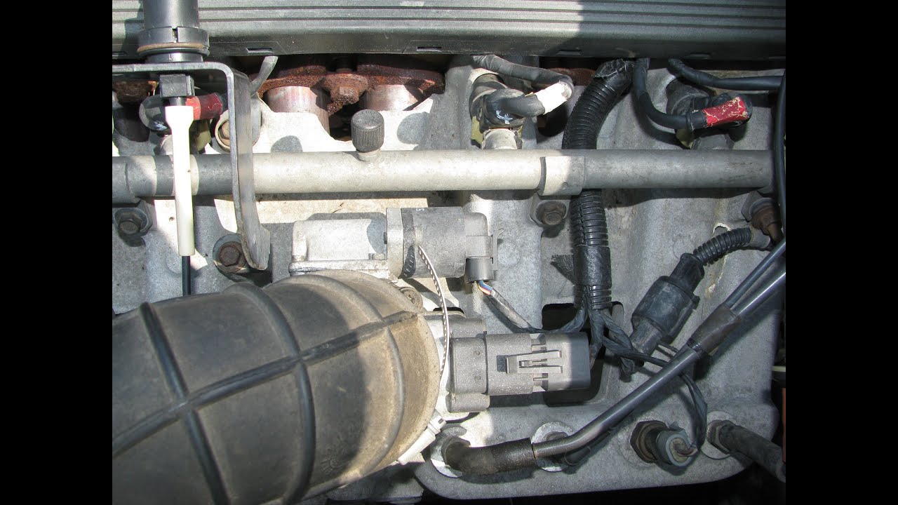

Here is a couple pictures with the offending connector on the right. Then a broader overview of the area of the harness.

Those fuel injector connectors look strange. I hate to keep harping on this but are you sure that harness came from a '99 XJ. Did you remove the harness from the '99 doner XJ?

NINJA EDIT.. Compared the injector connectors with an OBD1 YJ harness I have and they are the same. Then compared to a cut up TJ harness that a friend gave me and I do see a difference.

Yeah, I just looked at my rig (99 xj) and I dont have those wires in that area. I also checked a 97 FSM and there is no wires with that color in that area. Can you take a picture of the PDC that is attached to that harness?
Hope this helps to ID what in the heck I ended up with.........
Looking at the connectors and the PDC I have a feeling you grabbed a 96 XJ engine harness.
here is a 96 throttle body.
96 is a bastard year that used alot of early model sensors on a late model computer.
