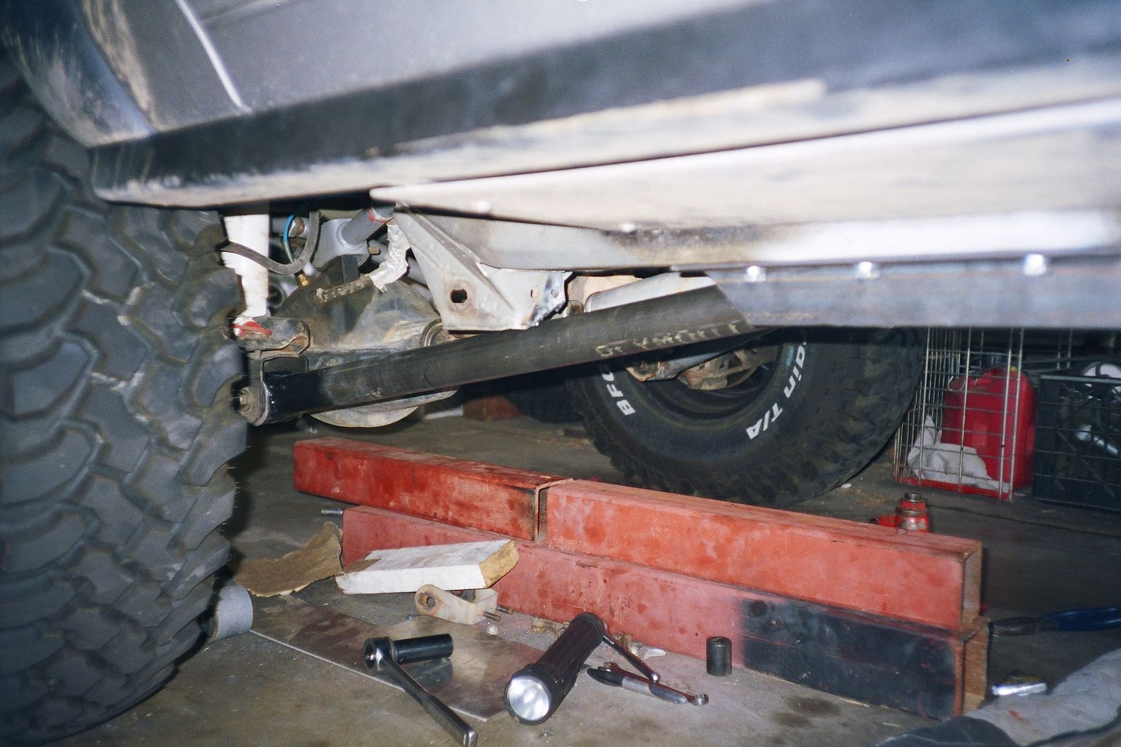

Rusty's use of hiems is one of many great reasons to keep looking at better LA options......there are much better joint solutions on the market. The Summit Machine joints that come with the TnT setup are rebuildable and I saw zero pivot ball wear in mine with 11yrs and over 100k miles logged on this setup. The Summit joints are Ultra4//KOH tested and will out perform a heim x 10.
For the budget conscious builder, one could buy the SFR brackets and crossmember and fab your own arms using Summit Machine joints and DOM tube.
Those seem very similar To The RE Superflex joints on my long arms. Going on 16yrs with no adjustment or re-building.
Similar, but better. The races in the Summit Machine joints have a grease groove machined into the cup, so when you grease the joint, it actually distributes lube evenly. There are Ultra4 rigs which have rolled multiple times at speed with zero damage to the Summit joints.
