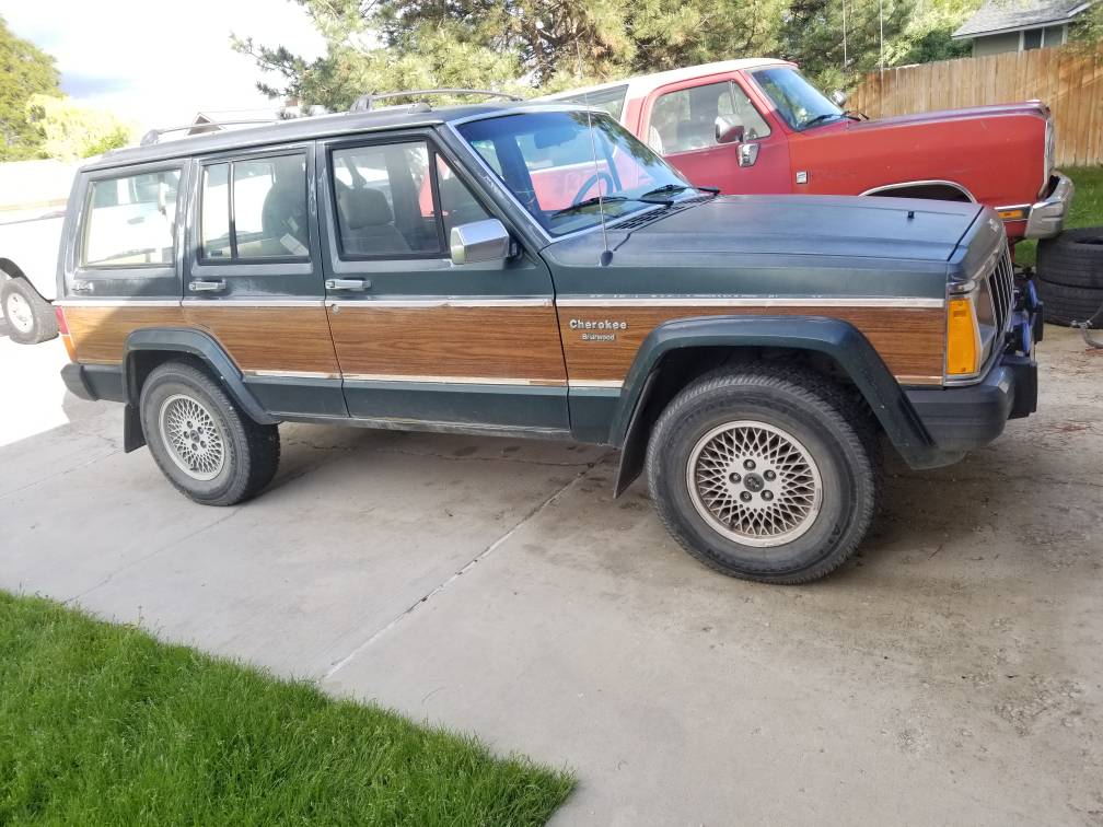

I am looking to get a complete kit to lift my 1992 briarwood 3-4 inches. Currently looking at the Rubicon Express super flex short arm( http://www.rubiconexpress.com/Suspen...Expre ss#tab3 ) . This bad mama is my daily driver so I have to be able to knock this whole dang ol deal out in one weekend.
My questions are:
1. Is there a complete list of every bolt and bushing and nut or anything else that I will need to accomplish this? I cant have the thing in pieces waiting on a part come Monday.
2. Is there a better more complete lift I should be looking at?
3. Do you have any recommendations for cheap steel wheels?
4. Anything else I should take care of while I'm in in there? This baby is bone stock except for custom cut length PVC pipe rear lift gate brace and a Bahama Breeze vent clip air freshener.
Sent from my SM-N950U using Tapatalk

RE1660 is the track bar. It says for 4" and up but their 3.5" sits a bit tall anyway.
Their U bolts should be long enough for their leaf packs as they're likely made specifically for it, but if you're worried you could buy the 10" long ones from Ruffstuff: https://www.ruffstuffspecialties.com/catalog/UB3.html
I'd go 8" wide on the wheel unless you're going really wide with the tire.

I did the RE 3.5 last year in mine. You can get the kits with track bar, different shock packages etc. I did the short arm super ride setup with quick disconnects also. You will probably need a SYE also. I have been very happy with mine and my use is similar to what you described.
