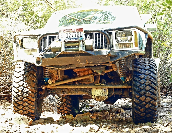

Ebay bumper is sitting gathering dust. Actually done a handful now and sold them
I have not done bump stops i dont have limiting straps. I dont care to much about my current shocks.
Still been talking to accutune I gota say they are great. What kicked this off was researching orie struts. Orie have built in bump stops. User stable spring rate ride heith firmness. Pretty much a bolt them on at bump stopped height air em up and go. At a cost of about 900ish minus the nitrogen charging bottle and hardware.
https://www.jensenbrosoffroad.com/products/stx-strut
https://www.polyperformance.com/ori-...rogen-fill-kit
Fox 2.0 factory series tuned by accutune spring rates set to your desired ride height me 5 up 7 down
https://accutuneoffroad.com/product/...-with-springs/
Then ad 400-500 for bump stops and make or buy limiting straps.
Ori od is 3.23"
Coils od on Fox 2.0 is roughly the same or alittle less than ori od. Wich is what started all my research. The ori I was thinking was easier to package but its not. In a way it is since it doesn't need a secondary bump stop.
All that and my jeeps still broke im having a hard time getting distracted. Been researching super duty front axles to. Shipped to me for 500-700 that includes shipping. Hmmmm

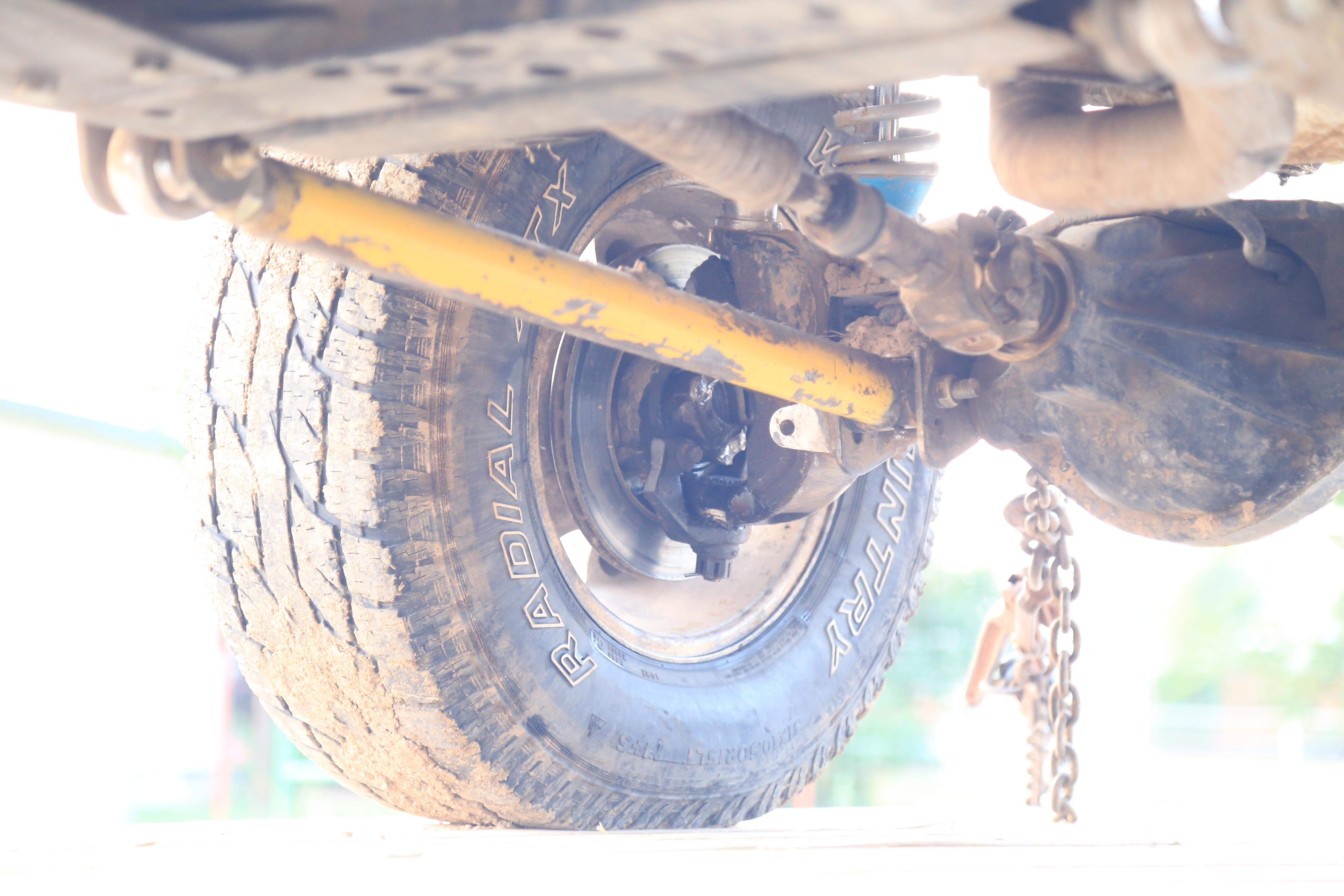

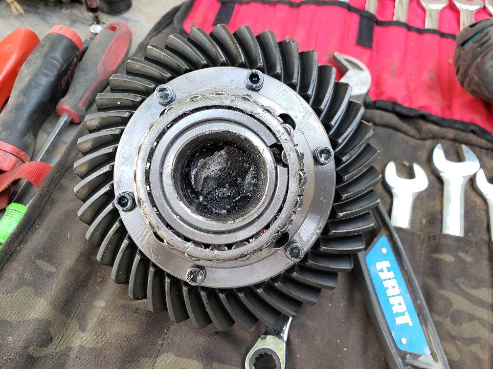

Yes. The red xj and me were only to rigs to complete the water fall runs. I did not have a spare. Pulled shaft and stuffed tube full of rags.
Yota took transfer case out on a rock .
Pretty hooked on slow technical vertical ledges and rocks. 5.13 gears would be nice.

Have also been thinking about rock crawler coils to firm up ride alittle and maybe bring about 1" of lift.
Factory in the cost of fox 2.0 shocks ive already decided are a must ad coil springs that probly won't work out how I like. And I'm damn near to what a set of coil overs cost tuned for my vehichle weight use and target ride height. Not to mention upper coil over mount or lower can easily have a couple inches of ride height built in without even thinking about touching coil adjustment on coiliver it self.
Coilover mounted in current coil location would go into the engine bay but pretty much anything I do from here is going in.
Cycling front with no shocks or coils 7" down is a shit ton of articulation and right about were track and 3link start limiting travel due to bind and track bar pulling to drivers side. 12" shock is plenty plenty.
I never got the last stimulus payment some ****er working the unemployment system got it instead im sure. Not to mention getting only 800 of almost 10 grand taken from my pay in taxes. I think this is the last year I pay taxes
Was counting on that to get bump stops. But am kinda glad I didn't because I hadn't yet talked myself into coil overs. Theyd be mounted in the way im sure

Broke inner AND outer axle shaft at the u joint? Ouch.

Yes. On or the other probably broke first then took out othere. Was unto take it out right away.
Yes made it up what owned the yota. A prior attempt with 3.55 gears and open front was a failed attempt. Literally walked right up with grizzly and 4.88s

Didn't catch both broke on that side. Really sucks
Don't ya love being locked?

Everyone bags on Doetsch Tech shocks but they have built in bumps as well. ORI or Orie? Completely different ballgame with coilovers but DT shocks are good.

I've heard good on them.
Ori
I really like the guys at accutune

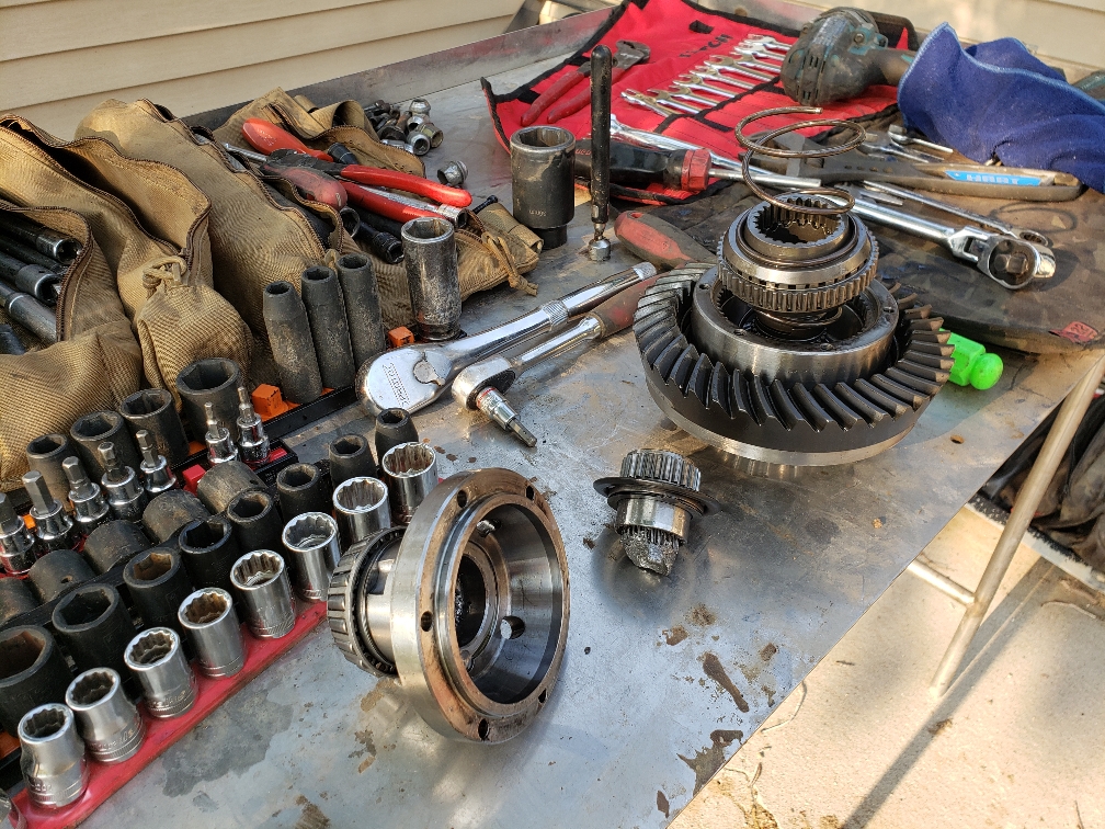

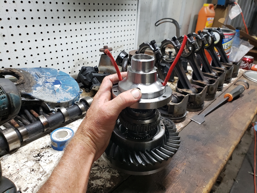

Joint upgrade day.
Pulled every shaft i could find even one with a bent inner due to a crash and a set from a 96 grand.
Then tracked down joints.
Now to work for a few hours. Then get shafts in tonight. Will remove tone rings and run spicers and have the skf for spares.
Hoping to hit the trail tomorrow on broke in gears but it didn't happen will have about 100 miles on rear gears going into carnage canyon.

Did you check to see what size axles you bought?
  #432
Old March 6th, 2021, 17:40
Evan03 Evan03 is offline
Join Date: Jun 2017
Location: Idaho
Posts: 937
5-760 size
Or are they 1310
A 93 xj had 260 joints to. All but one grand cherokee had cv's. I was after the big shaft.
Also went as far to test fit the grand shaft with tone ring on a xj.
Have alot of jointing when I get home

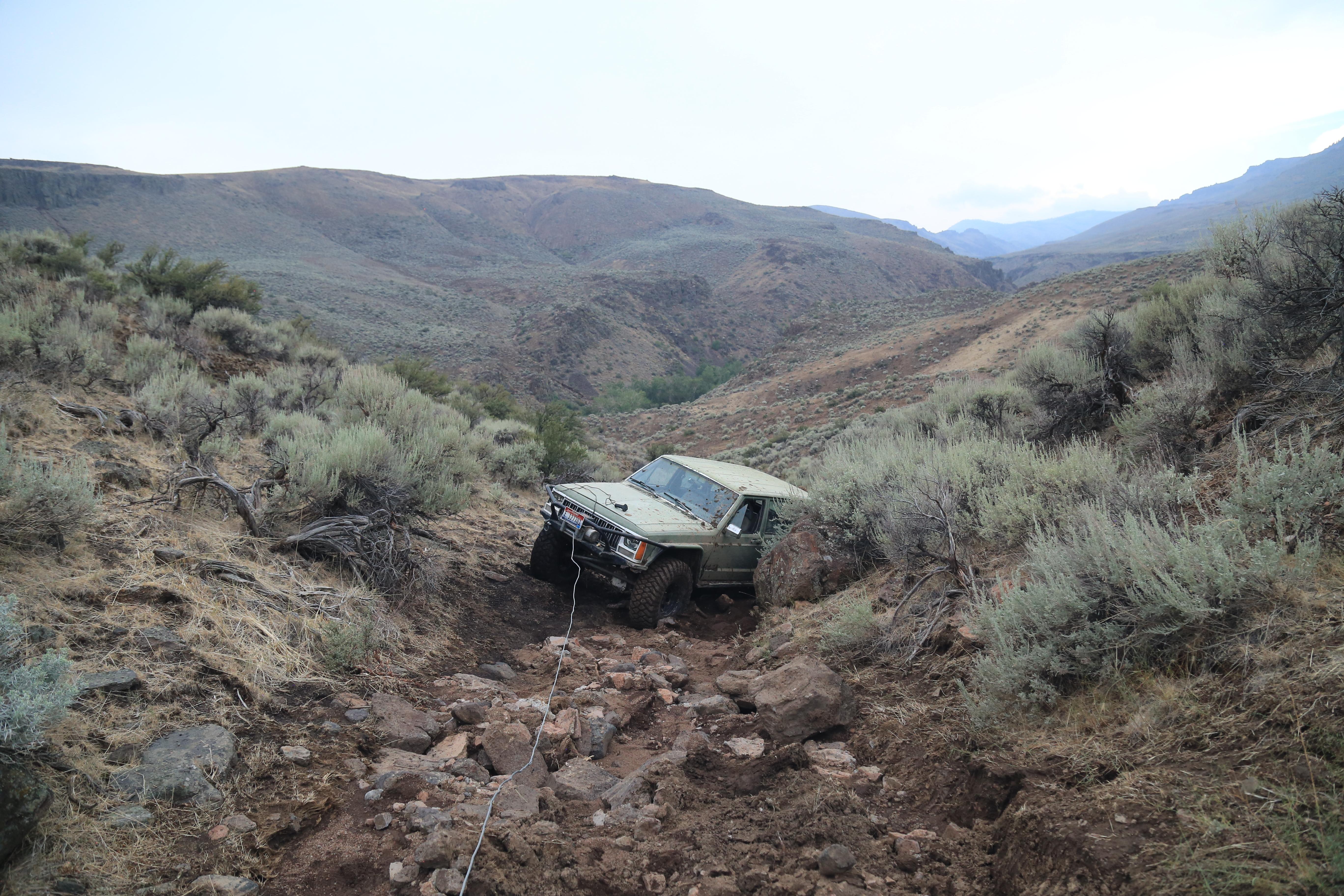

Front shafts survived a relaxing day.
Did do a trail working all fours snow mud running water clawing over rocks and through creeks had to turn around at a 5ft snow drift.
Fun stuff, the bigger shafts give alittle peice of mind though I know theyl still break. Have a the spares ready to go.

If anyone's curious ORI 14 AND 16" struts aren't available till August
I weighed my xj today. 4200lbs with spare fuel, tools and some trail parts.
Probly closer to 4400 actually trail read. Then potentially 4600-4700 with 2 occupants and stuff.
Front end weighs 2240
Will be contacting accutune for 14" coil overs ounce our mostly free money is deposited in my account. May swing for bump stops at the same time. Im undecided though I know I should do bump stops at tge same time
I can't wait till August.
I may double up the fox shocks on the rear and get crown HD leafs. But I may just run the 4 fox jeep shocks don't really want to spend money on leafs
Did some lifting deciding on up travel and stroke. These shocks are about 9" stroke. Im running 4.5" up travel and bump stopped there
14" coil overs will fit inside the hood. Ive worked out bump stop location and lower shock mount in my head.
Won't truly know whats going on under the hood till I get the shocks poked through minus springs and set to bump stop height.
Probly be a combination of tube with 1/4" plate. I envision a few inches of ride height adjustability built into the upper coil over mounts. Kinda starting to see that in my head.

https://youtu.be/JZMQOr6p1q8
Shitty vid. Still testing out the waters. 1310 ujoints holding up on the technical climbs. Starting to mangle her underside pretty good. Exhaust isn't surviving very good at all. Need to ramp all crossmembers. Can't have square edges.
