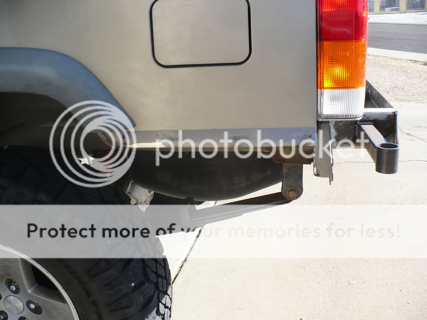

I called Eddie Motorsports and ordered a #236 one, they are exchangeable for a year to get the correct weight. They are only 7-1/2" ext w/ a 2-1/2" stroke so quite compact. I also got the returns fitted and tacked up but I also decided to make a adapter for my engine stand because this is getting bulky/heavy so final welding/painting will be easy!

I got the returns done and also the safety chain mounts. I have the top plate welded but haven't done the grinding yet but I got the backside all painted.

I got it done and painted(less a few issues). Yesterday I got the lift strut and am working on that as we speak, but unless I get better math I am short about 1/8" of stroke. Today I received my steel order to cut out the shackle/d-ring mounts and those still need welded. I just ordered a longer strut but it was at less weight, we'll see what happens between the 2. The bumper weight came in great at a 104 lbs but is stronger/lighter/higher/and tighter than any class 3 bumper/ hitch out there.

The tow rating on a stock XJ is #5000 and on a WJ is #6000, I exceed all those parametetrs.
They may look big in the picture but they are only made from 3/4" x 2" cold rolled/precision ground steel. I finished prepping them up today and will tack them on tomorrow and finish welding them at my son's work (300A machine). You cannot make recovery points to strong!
