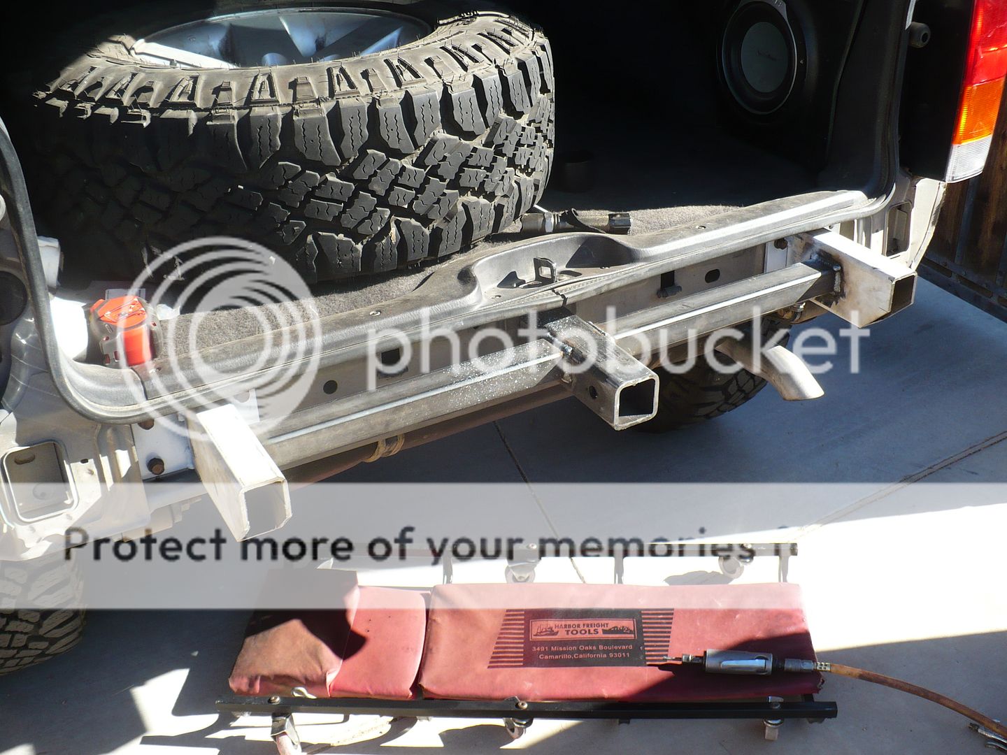

Like most things in life it didn't go exactly as planned. After complete look at what I was really dealing with it turned out a lot easier to make a couple of small "incisions" with the plasma cutter. It was actually a couple of fillet welds on opposite corners. I still have no idea what it's intended purpose for being there would be.
That thing was a PITA to remove. I first tried drilling out the attachment welds. I drilled one and found that I had to keep expanding the hole to remove the entire weld. I eventually decided that I didn't want to make another hole that big in the unibody rail to remove the other weld.
What ended up working really nicely was whacking the piece using a rod slid into the unibody rail from the rear of the vehicle. I think the rod was about 5/8" diameter steel by about 2 ft long, and I was able to shear the welds using a framing hammer. The weld closer to the front of the vehicle was about 80% removed already, but I'm pretty sure that I could have used this technique from the beginning, and it would have taken about 5 minutes total. A 2-3 lb hand sledge would have likely made this go really easy. Be ready for the piece to go shooting down the rail when it finally lets loose. You'll want something that can be used to retrieve it.

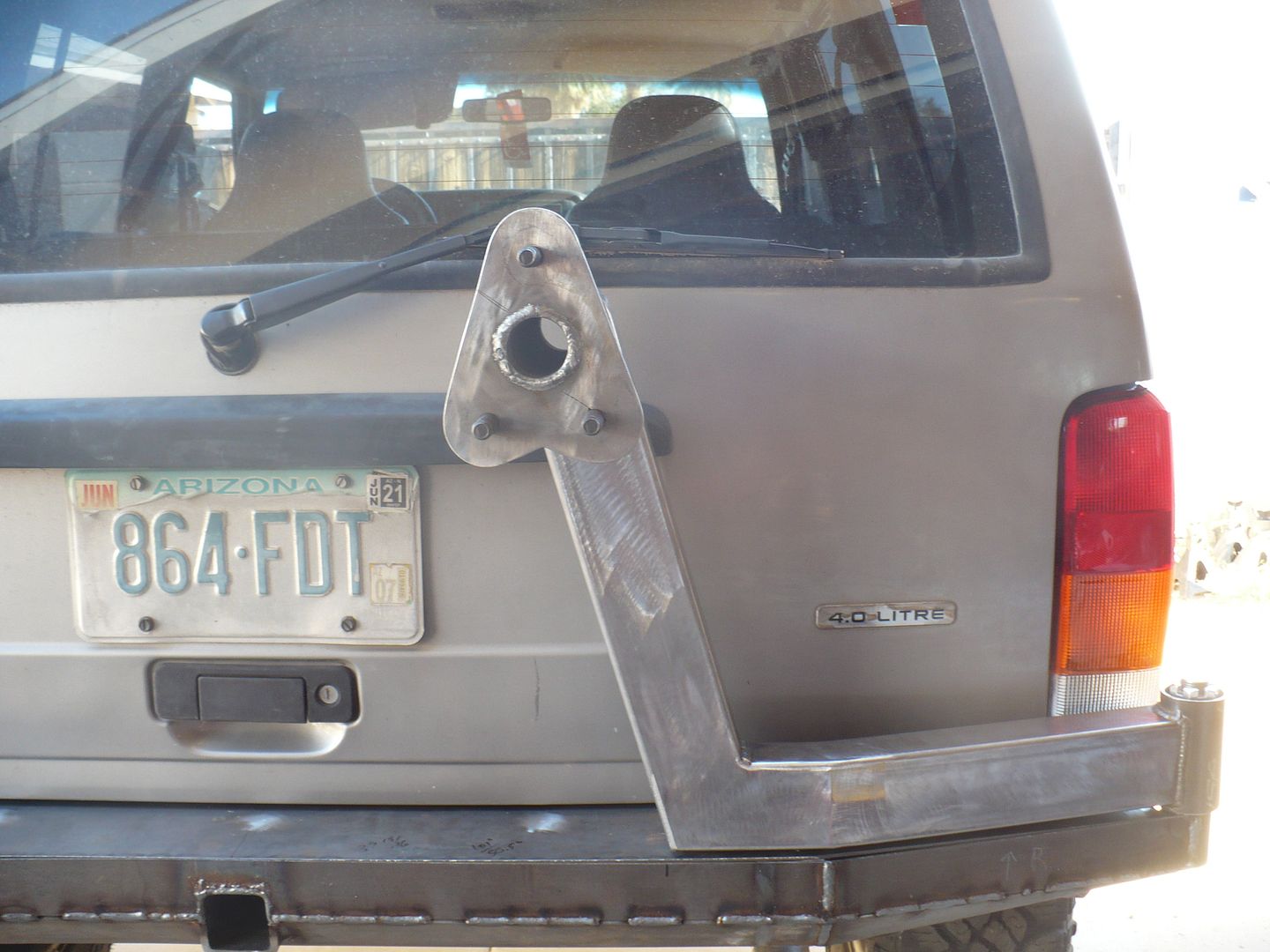

I just picked up this over-grown ball joint taper(approx 1-1/4" dia.) to use as my swing arm securing/retaining bolt. I do not want my tire moving around at all!

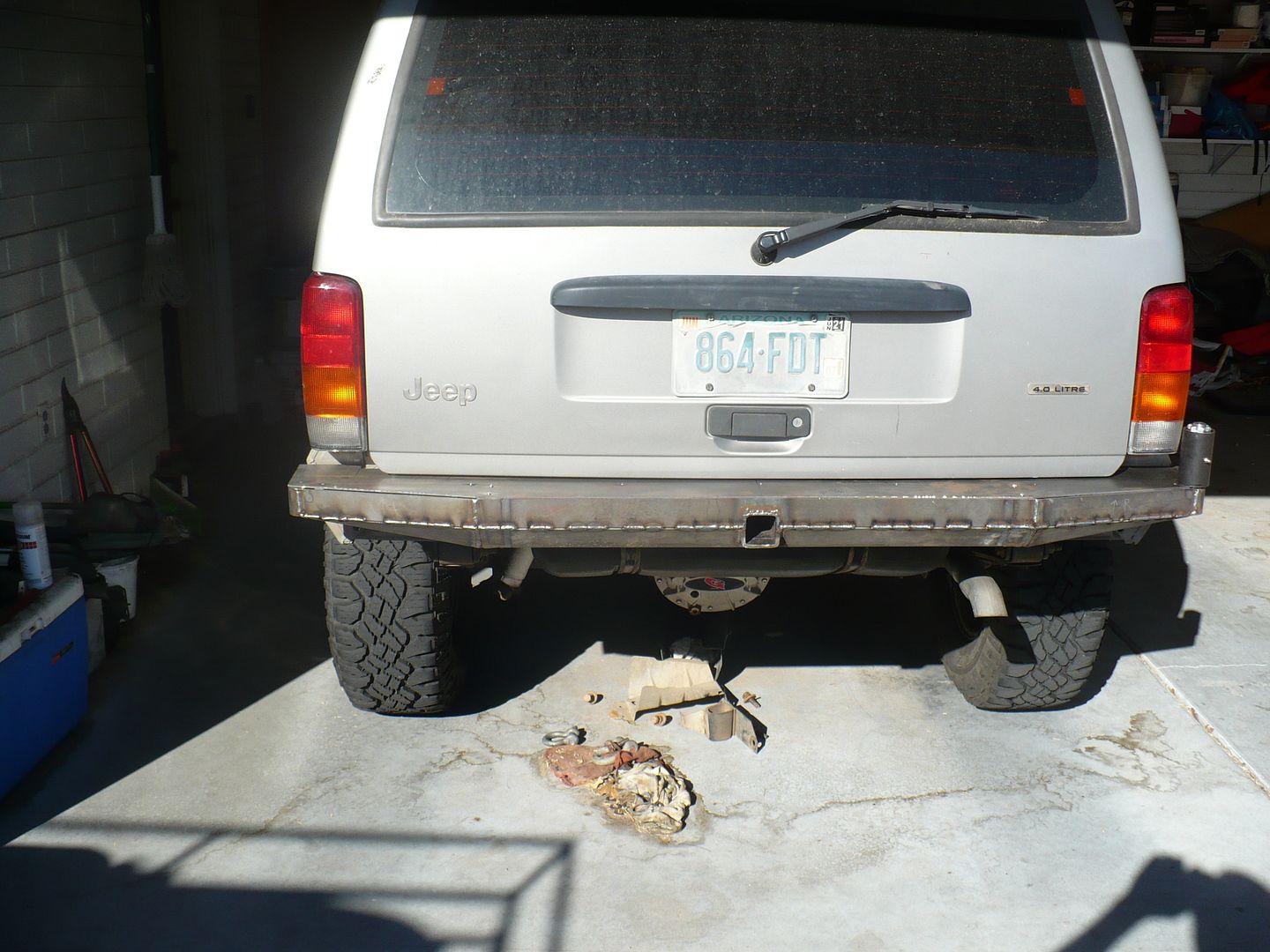

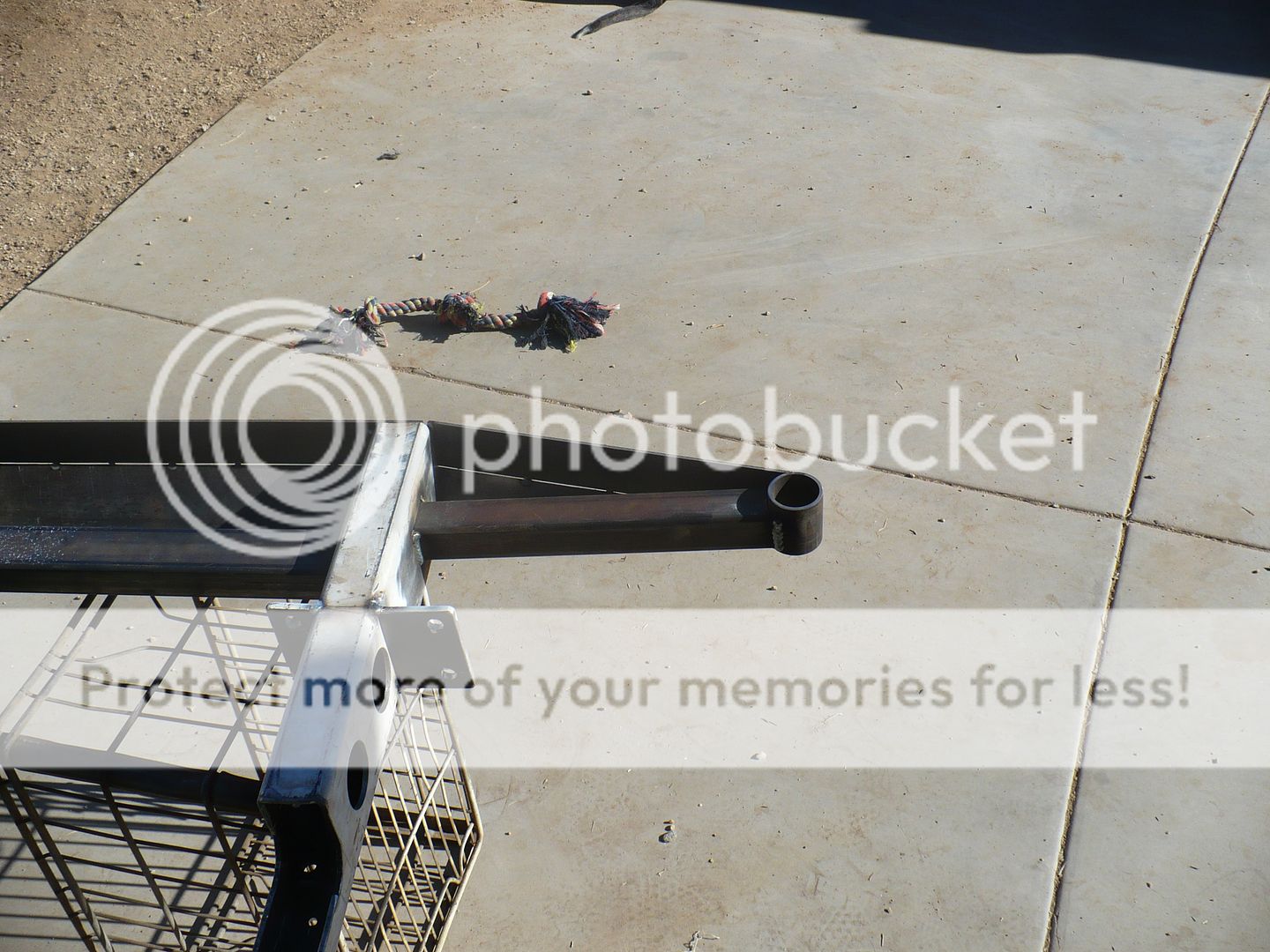

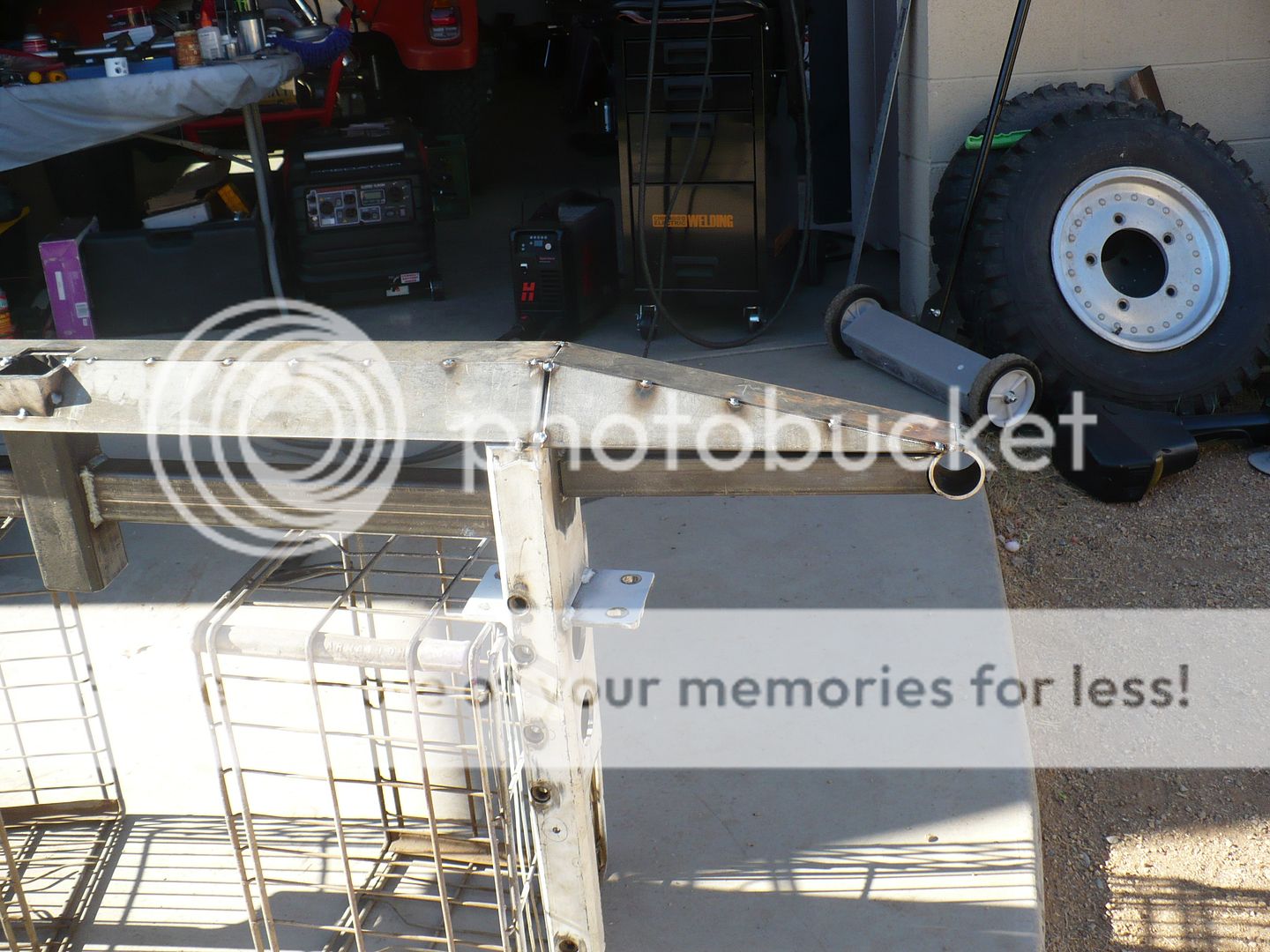

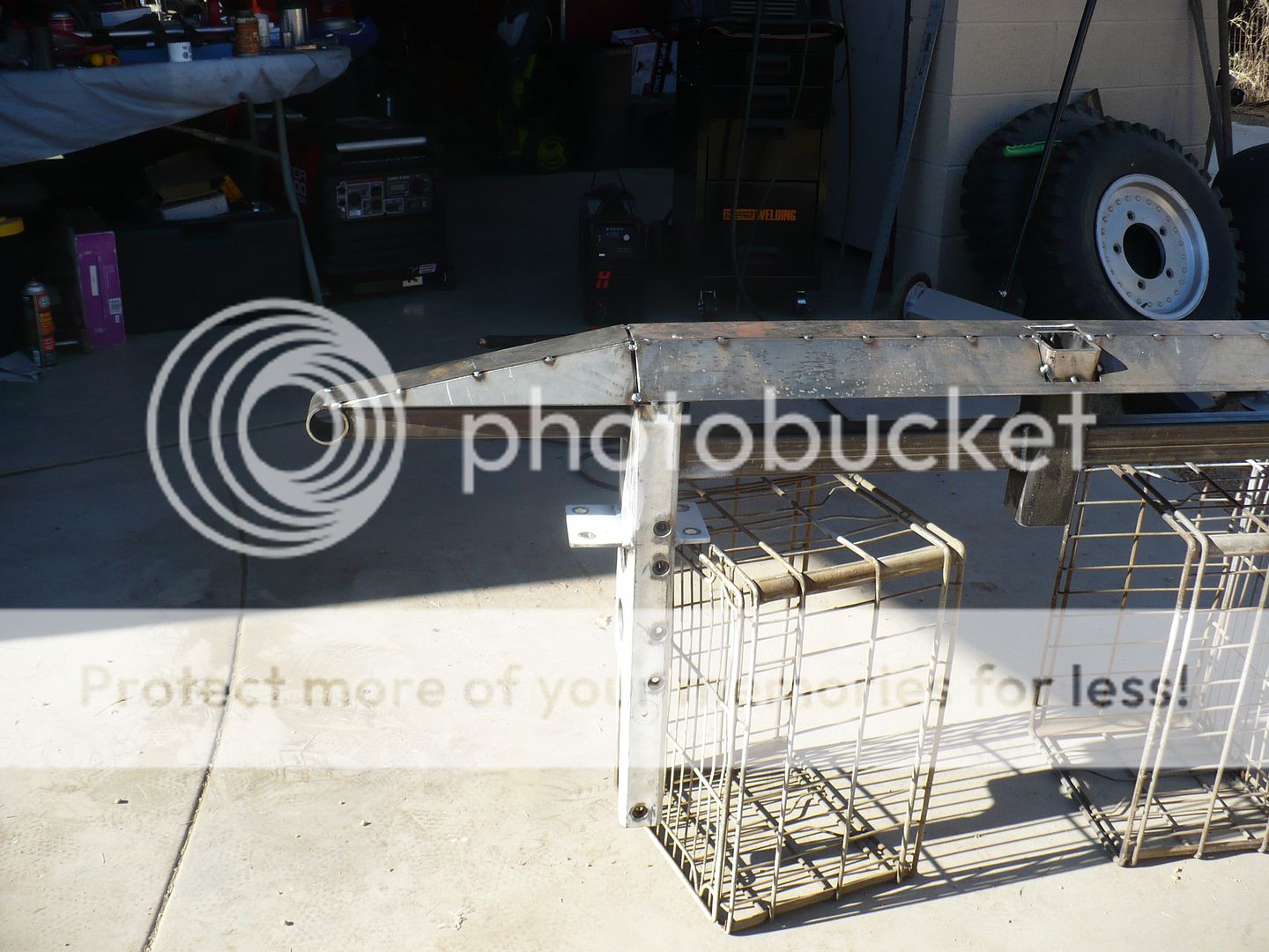

I got a little work done this week. I got the backbone cut and tacked together.

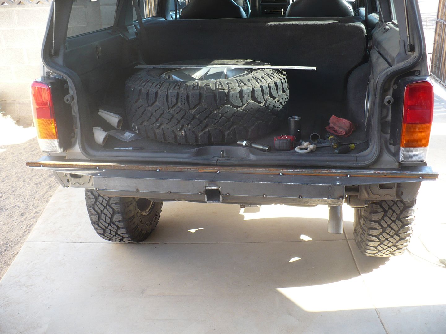

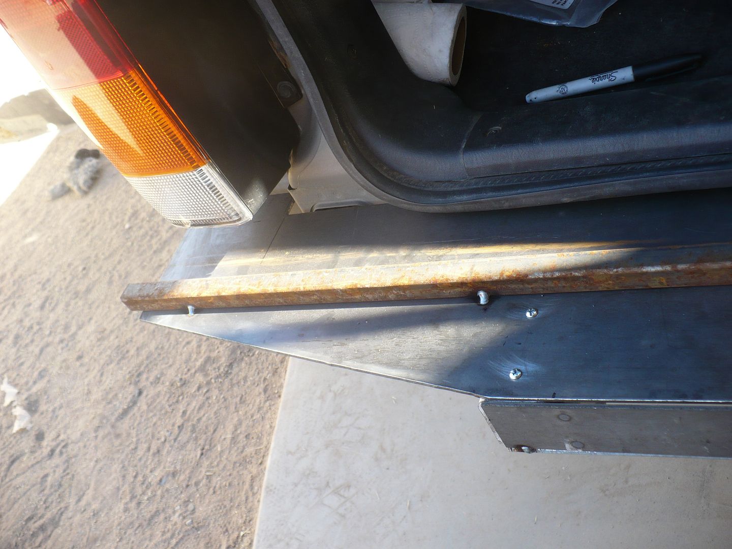

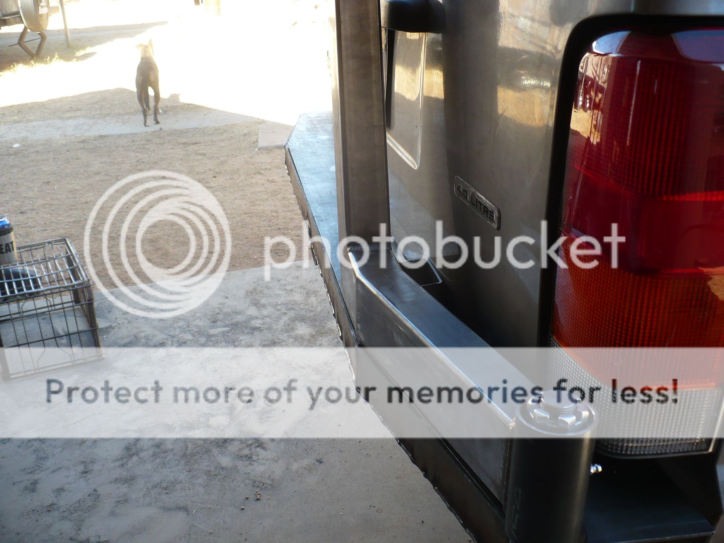

This is what I got done this weekend. Tie-in's cut to length and angle cut, full weld on the back-bone, trimmed the top plate to size/shape(bolted on for access to the welds for now), and started on the skinning. I've got some miter work to figure out now(last pic).

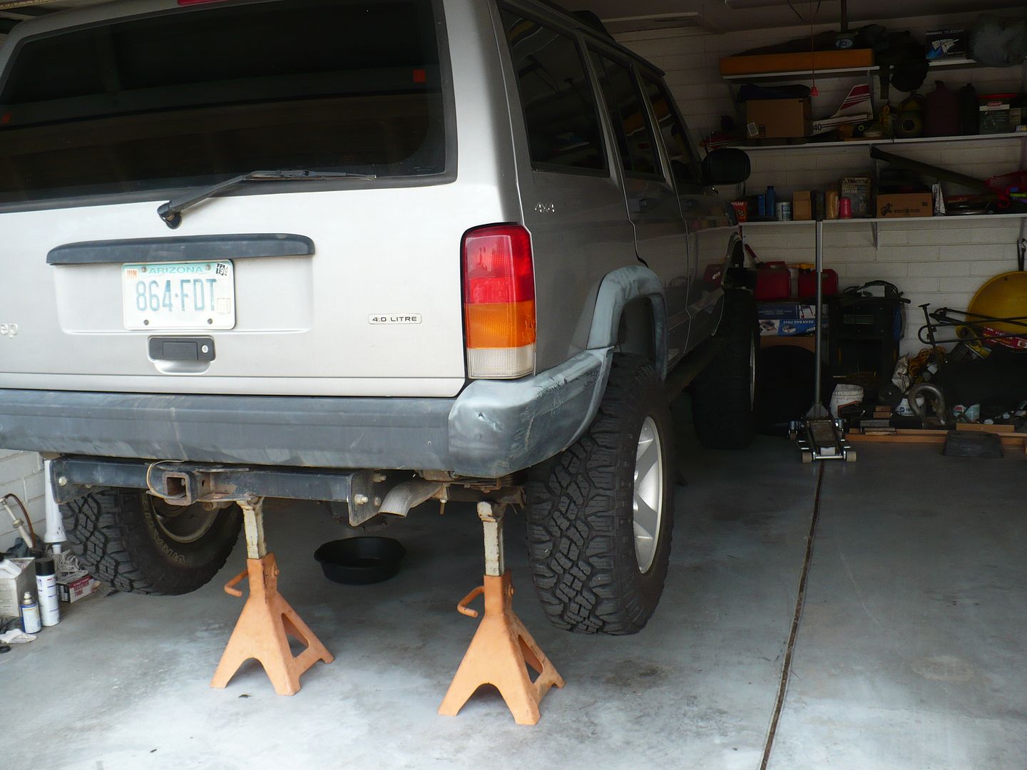

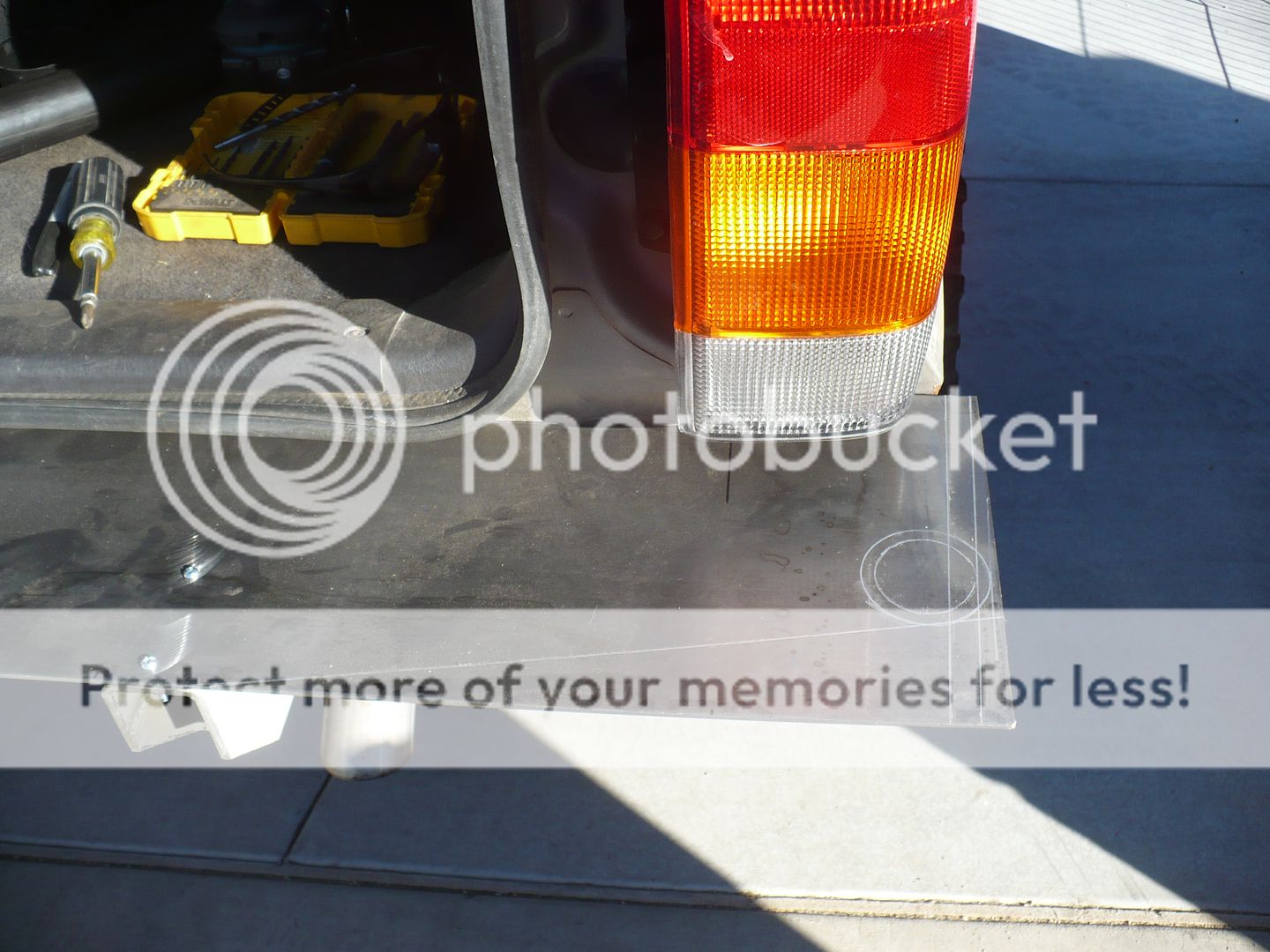

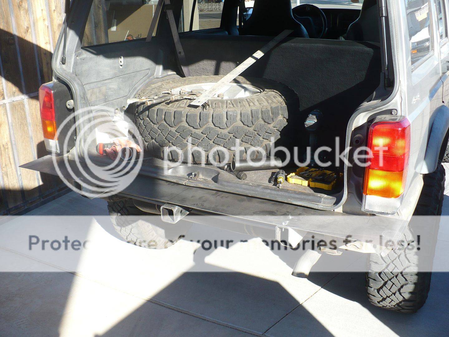

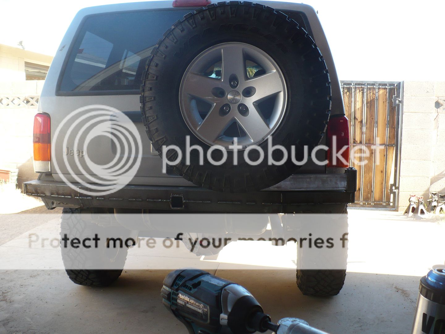

This was my factory bumper and a receiver I put on 20yrs ago, I have gained 5-1/2" in clearance overall.

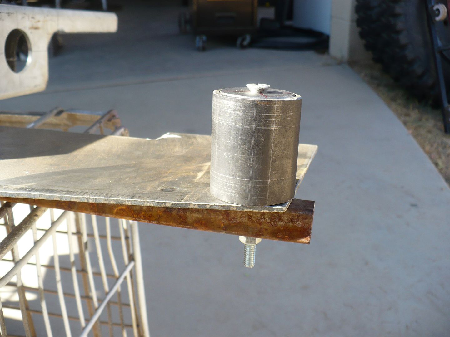

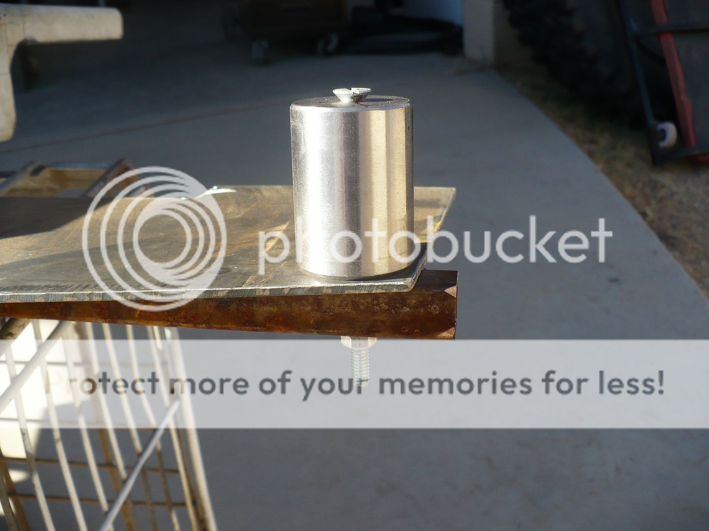

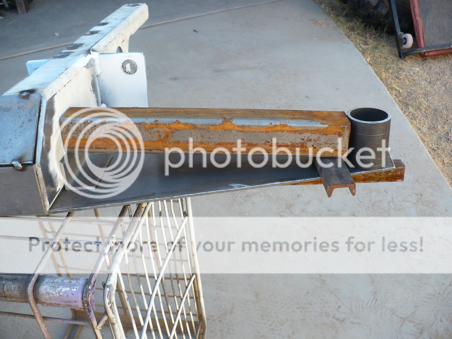

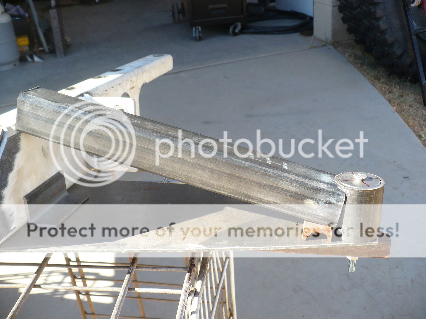

It turns out the build itself is it's own best jig for the miter's. I have the "fish-mouth" done (it was*4) so now I just have to fit the other end. I used a small cut from my Ruffstuff spindle as that's what I'm trying to keep straight.

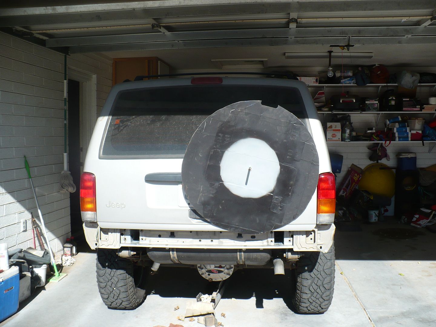

I'll add that the 1-1/2" solid spindle will help control heat/shrinkage/warpage. I am also working on mocking up the tire placement!
