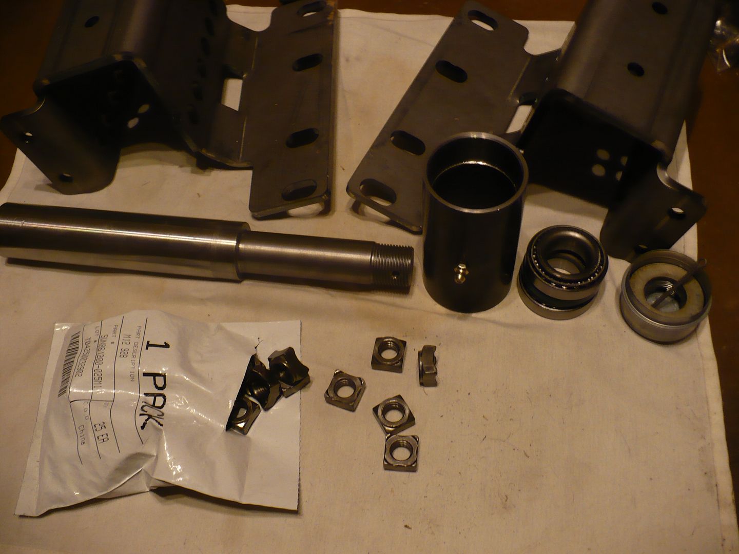

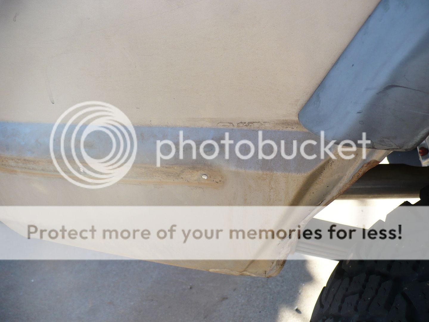

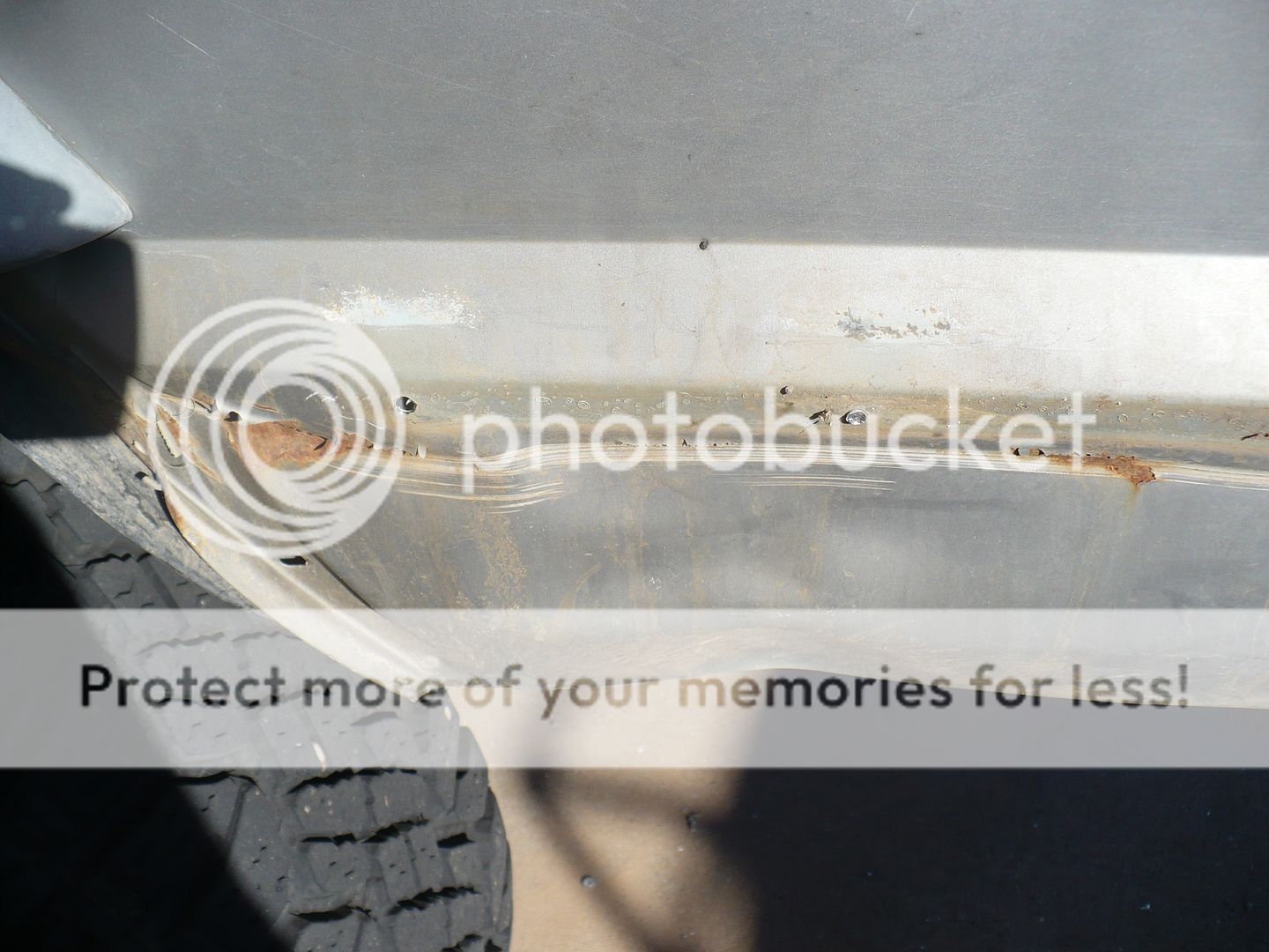

I need to build a new bumper to tow with, I want to start with a DIY Dirtbound and continue from there with extreme tie-ins and additional bracing to get to a class IV rating and finally a tire carrier. I got started this weekend yanking the bumper and gas tank skid off, along with drilling out all the rivets for the bumperettes and nut strips. I knew I had some old damage behind the bumperettes. Then I cut out the frame-rail holes, they will take 2"x4" tubing up to the filler neck. I bought the SFR boxes thinking the weld nut from the shackles actually passed into the frame rail! They don't, the next is the depth/height of the fuel filler hoses.

I received my chromoly plate today along with my SFR shackle boxes. Man those things are huge, I guess I never thought about it much but their pics didn't appear like that!

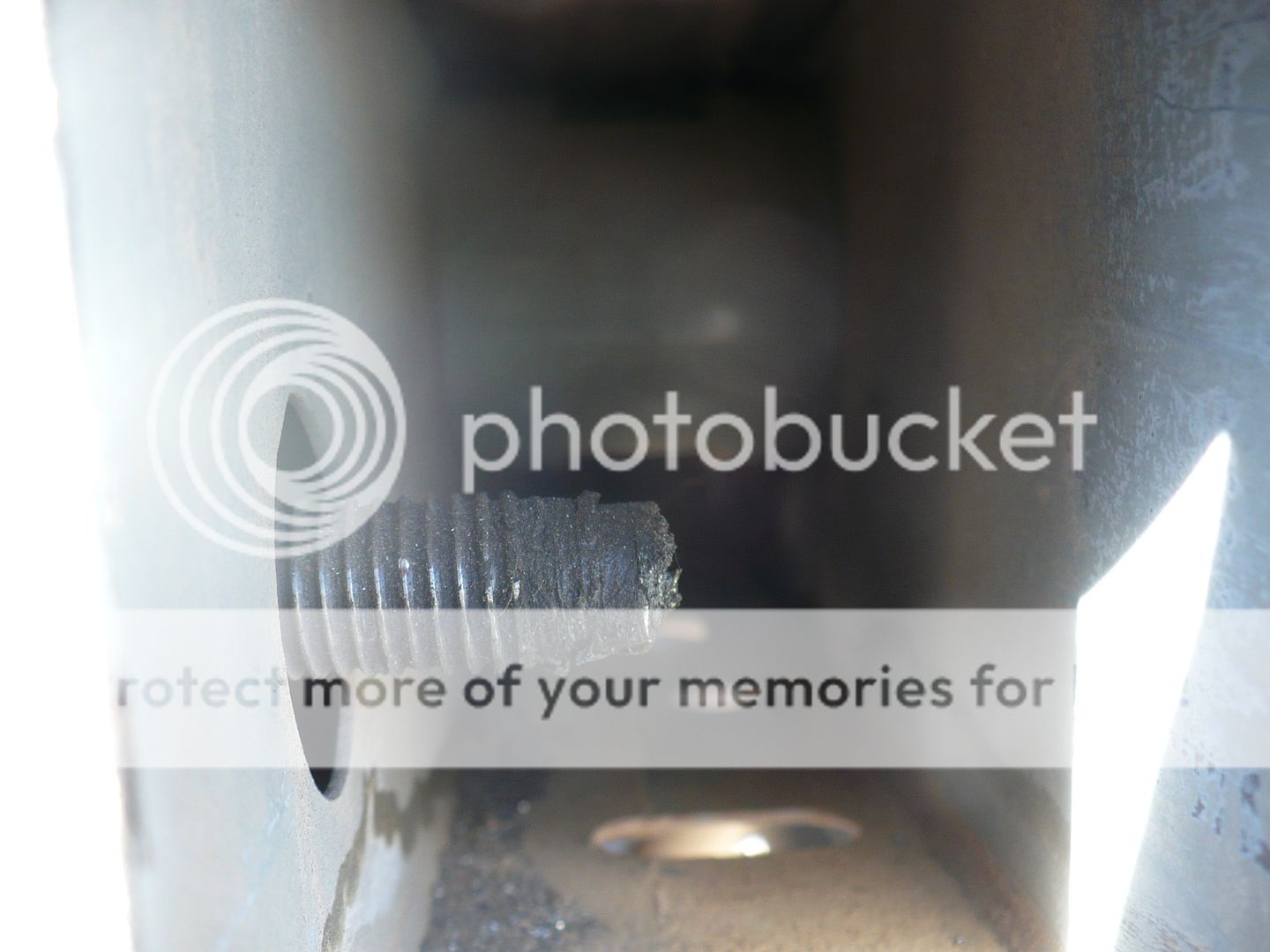

In order for anything to sit against the bottom of the inside of the unibody rail, there are a few issues.
- On both rails, the fourth hole has a raised perimeter that protrudes into the interior of the rail? I was thinking of grinding the hole larger to remove the lip. What are you considering?
- On the right unibody rail, there is a chunk of metal spanning across the bottom of the rail on the inside after the fourth hole. How are you going to deal with that? It doesn't seem like it will come out easily.
- On the left unibody rail, the screws debris shield for for the gas tank filler and vent protrude into the unibody. How are you going to deal with that?

All true but it only took minutes to fix all that:
1 - die grinder with a burr bit
2 - drill out 2 spot welds
3 - remove screws replace with threaded screws
