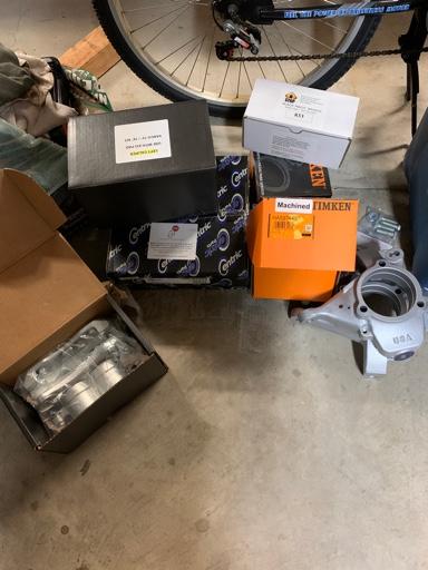

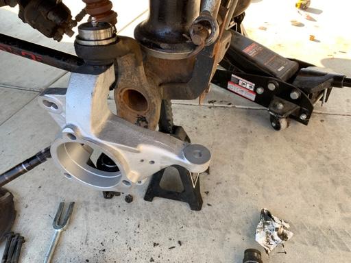

Here is the kit, notice the shiny new knuckles that will fit the new dual piston calipers.

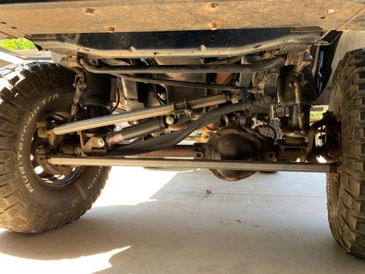

Below is what I have now. TJ rubicon 44s and a tera flex knuckle.

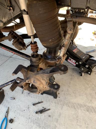

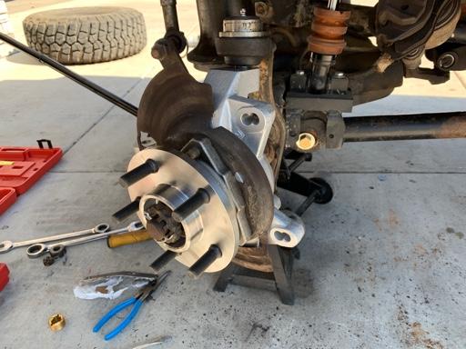

Made some progress today. Removed the old knuckles and replaced ball joints. Huge pain to remove those ball joints!
New machines unit bearings go on and new rotors and calipers go on as well.

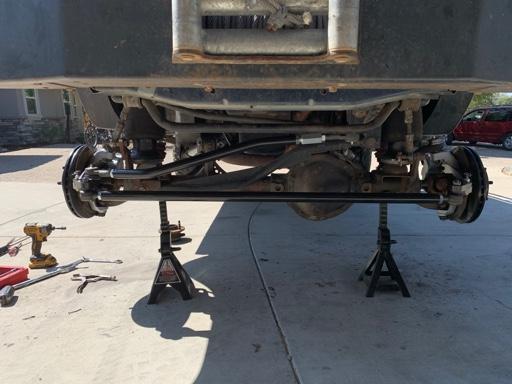

Here is where I started, minus the drag link that is already removed.
Below is the tera flex knuckle in the passenger side.

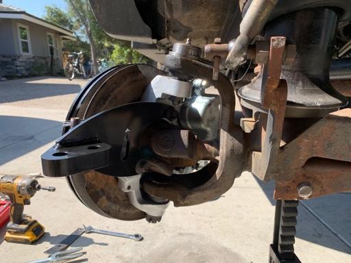

And now the new knuckle with new ball joints.

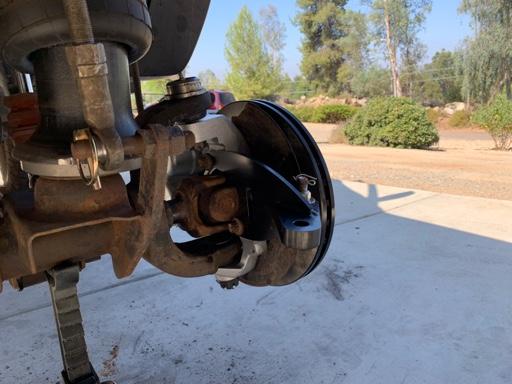

Below is the new unit bearings installed

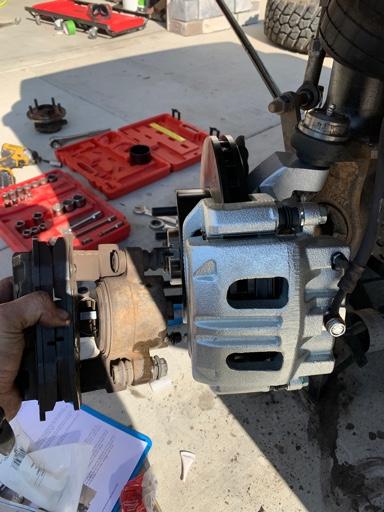

And now the new calipers installed. The old one is held up for comparison.

.......or U-turn steering over the teraflex or WJ conversion ??
Your original pic shows a track bar and draglink not in parallel.................
All the u-turn will do for you is get you closer to parallel, which you probably could have done more cheaply with a different track bar upper mount, or by raising the lower mount.
I didnít do the WJ conversion mainly because I wanted the UTurn steering in addition to better brakes. Getting better braking power was most important and the teraflex wasnít compatible with the VANCO knuckles. When I had the teraflex stuff installed I really didnít understand how the geometry was supposed to be and sort of got had by a shop who was selling teraflex high steer setups.
I was prepared to raise the lower trackbar mount if needed but wanted to put it all together and see

I got everything put back together, a reasonable driveway alignment and bled the brakes
Below are the knuckle adapters
Here it is sitting pretty straight and ready for tires
After the installation I took it for a spin and did the brake in procedure for the black magic brakes.
What an incredible difference the brakes made. For the first time in 15 years I can actually stop this thing. A dramatic improvement is an understatement. If you have 35s on your Cherokee and canít stop, put this VANCO kit on there and you will be stopping on a dime. Seriously, I can easily lock up the front tires. Stops in way less than half the distance. Feels like a normal car when braking heavily.

It's better, but your track bar & drag link still look to be out of parallel about 1/2 as much.
Better brakes are awesome....on my car, I can stop on a dime (15" rotors & 6 piston calipers)....want to get the cherokee do be able to do similar too.....right now, with 32's, if I let the rear brakes get out of adjustment, then braking power drops dramatically.
Yeah
The track bar drops much further than the draglink but as of now there is no symptoms of that. Everything is nice and tight and straight and there is no bump steer at all. The wheel stays straight from no lift all the way up to 10Ē of lift so until I have a reason to raise the axle side mount of the track bar I am going to keep it.
