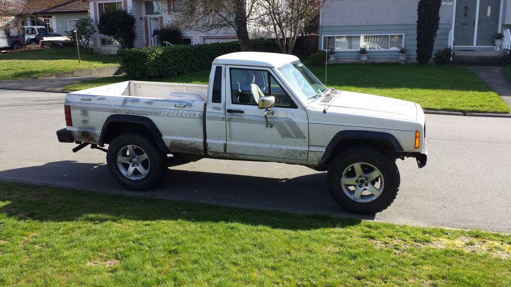

Got the tires mounted and balanced on the wheels. They look awesome.
Prior to mounting the tires i mocked up the wheels on the jeep. It looked pretty good, there may be a little tie/control arm rub at full lock. I picked up a set of 31/10.5/15 BFG AT's for street use.

Finally completed lifting my jeep this weekend. The wheels and tires are a perfect fit. I don't think I could have gone taller without some major rubbing issues. I may still have to do some bump stops to keep it from eating the fenders while flexing.
