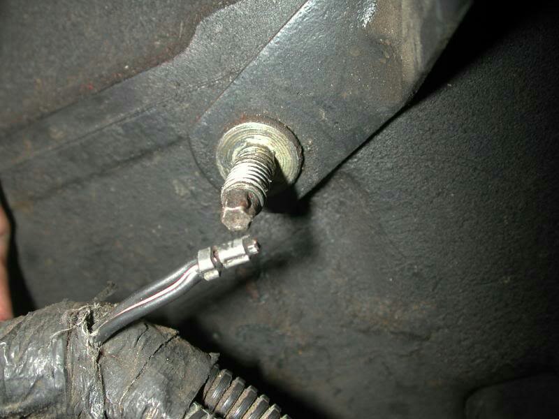

I thought there is supposed to be 2 factory ground loops at the dipstick stud?
Also, not to discount your work but the ground cable from stud to stud on the engine block is pointless. better off attaching dipstick stud<>firewall.

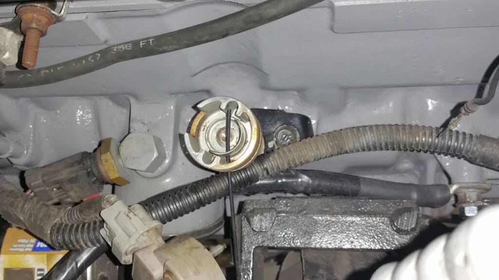

There is one small wire coming from the harness that attaches to the stud by the firewall,pass side.
Since its often a trouble maker I figured why not add an extra tying it to the front studs? Maybe to the "frame" would have been better...if still a waste?
That new extra wire I ran goes to the pair of front studs where two more wires from the harness join it. Also the main ground wire from the battery goes to the rear of that pair of studs. There is an extra wire that goes from the front stud to the vertices bolt on the motor mount to the frame.
And as far as I know there has only ever been one wire on that rear dipstick stud?? Am I missing something? ?

The engine to engine ground loop is pointless because the engine block is one big ground. An extra engine to body ground is never a bad thing though. leave it attached to the dipstick stud and run it to the body somewhere.
So if it's not creating spark, as I suspect, is it a bad coil pack assembly or simply not getting told to do so? I'm not sure how to test the plug for the rail to tell...?
again, I'm almost positive there should be another ground loop attached at the dipsick stud. 2 loops, 3 or 4 wires total.
Quick Google only shows the one wire to the dipstick tube stud.
^broken one via google^

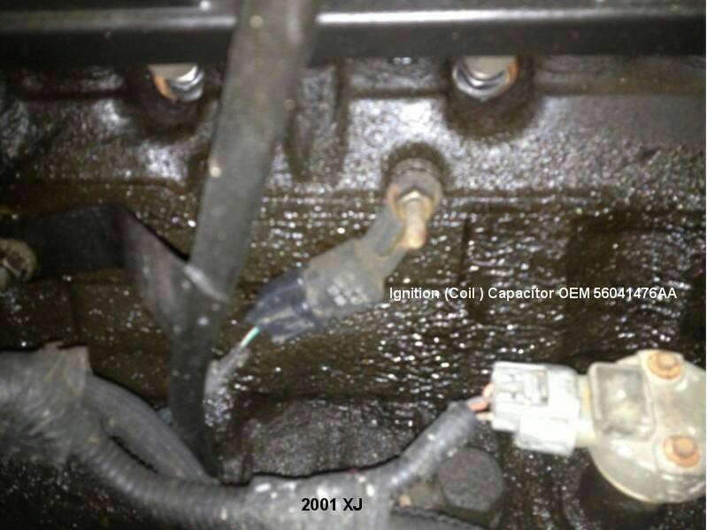

There's another stud a bit forward of it that has some weird thingy on it that has to do with...?
(God, wash that thing! :eek: )

Also, what's this thing on the stud in front of the dipstick stud?
