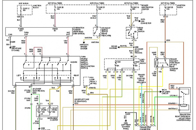

I don't have any answers, but I have one of your problems. Running my rear LEDs through a TowReady converter box everything was working fine. Then I replaced my front turn signals with LEDs (under the headlight only, not the side markers--still incan in those) and now I have the green turn signal indicators on full time with the headlights/parking lights. They will flash brighter when the turn signals are on, but besides that they are on if the headlight switch is on.
I was thinking about trying to add resistors (are those what you are calling "load equalizers"?) to see if the issue was the system thinking I had bulbs out due to insufficient load on the switch. If you have already gone that route that may indicate I would be wasting my time.
I need to take a look at the wiring schematic and see if I can figure out the logic that turns those indicators on full time.

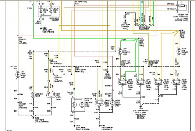

So I've went through the rear wiring, and all of the connections are solid, but I'm starting to question the brake lights themselves. Because I did the reverse lights in the hatch, and I'm using Wagoneer lenses, I moved the turn signal lights to the clear lense that was the reverse light, I added a second brake light bulb to take the place of the empty spot that was the turn signal. I had been running three brake lights, but I started having problems with one of the bulbs on each side, they would all light up with the running lights, but one of them wouldn't light up when I hit the brakes? So I clipped the third pigtail and shrugged it off.
Front turn signals still don't flash when the parking lights are on, but the flash-back LEDs are working the way they are supposed to? It stays white with the parking lights, and turns amber when I hit the turn signal(doesn't flash though), turn signal turns off, and it switches back to white. I didn't actually do anything to it, it just kinda started working since I've been back from Vegas. I don't know if it's connected to the flash-backs working all of a sudden, or if it's because I cleaned up the ground connection on the fender tonight, but the front turn signals do flash with the hazards now.
I'm guessing that the front turn signals, and the dash lights coming on when I hit the brakes aren't entirely connected. Maybe the turn signal switch is causing the problem in the front?
