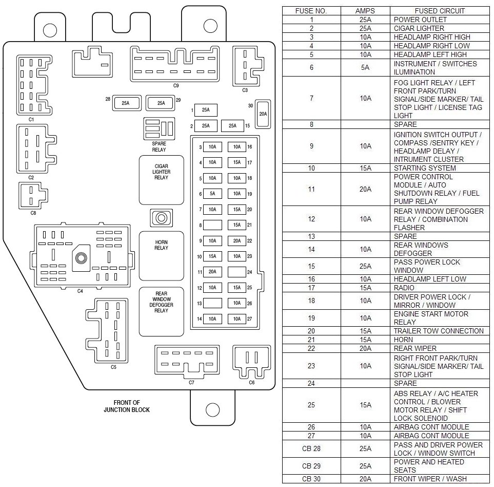

I would like to get or find good scans of the owners manual info for the fuse blocks. I have some fuses with 0 power on both sides of the fuse. #3 inside the XJ and the middle one of the small fuses by the foglamp relays in the underhood block.

These are from my owner's manual; hope it helps. I'd test the fog switch itself, as well as the rear washer pump and switch. My wiper switch and pump were both toast; the stock fog wiring has a reputation for eating switches.
