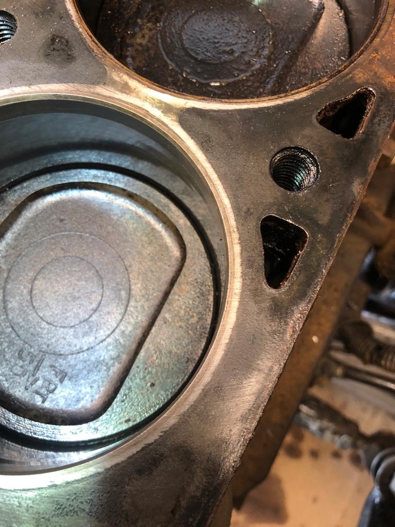

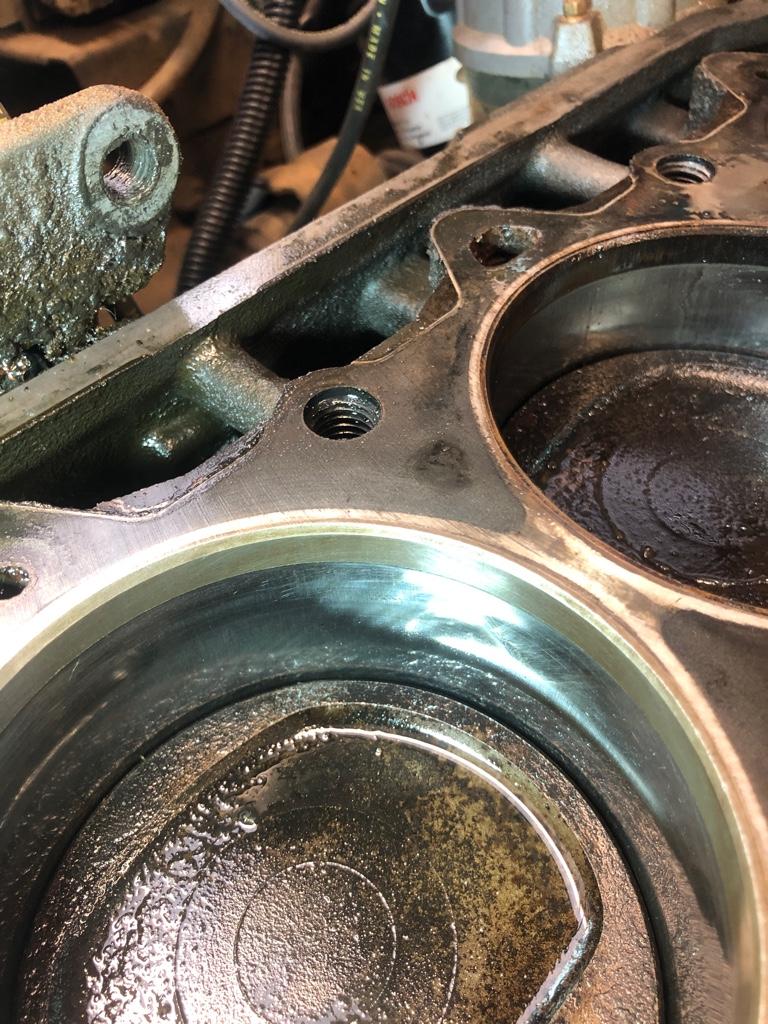

So Iím trying to pull the pistons and I expected there to be a carbon ridge at the top of the bore. However, the ridge I have seems metallic. Itís not black and it almost looks like an insert or something as you can see a ring on the deck as well.

No, that's just the ridge wear left by the rings.

Are they usually pretty pronounced?

Sometimes they can be very ridged depending on the years of service.

I agree, that is "ridge wear". IIRC, there are reamers available to remove that ridge to allow removing the pistons without breaking them. Then the bores would need to be honed. The amount of ridge formation depends a lot on how well the rotating assembly was balanced.

All the ridges seems to be equal in all cylinders and uniform around each bore. I’ll attribute it to normal wear. Engine ran smoothly. Guess I’ll get a ridge reamer. Also, I’m assuming seeing some copper on the rod bearings is normal, but just a sign of wear. The crank is still smooth so I’ll probably get new bearings since I’m there
