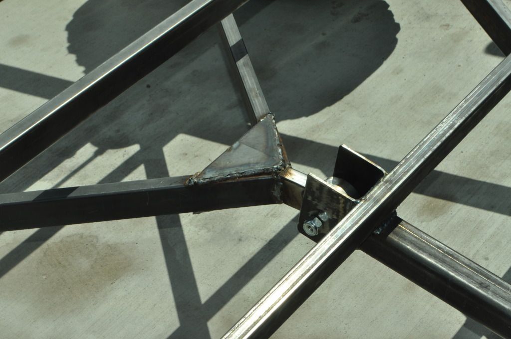

Here are some pix of the trailer frame as I pulled it out into the sunlight for the first time. I still have to mount some shocks and finish the fancy coupler but things are coming along.
Nothing like a little overkill on the draglink.

The trailer actually articulates a bit too easy. I still have the socks to mount but I think I may end up putting a very small sway bar on. Anybody know of a vehicle that uses a thin sway bar? I just want it to return to neutral after flexing.

maybe a rear stock swaybar from a XJ

I dont think its gonna flex anyhow. It will simply pivot on the coupler. I had a similar suspension on my old trailer, which was/is great for washboards and potholes, but it just pivots on the coupler, as its only being dragged behind the vehicle, and the axle isnt powered to initiate any torsional stresses. Sure, YOU can make it flex, but when its being dragged behind a vehicle, its not going to flex like a crawler would. It just pivots.
For example, here is what will happen. Notice the axle is still parallel to the frame? Its pivoting on the hitch, yours will do the same, even with the single suspension pivot point in the middle...because of where the bags are mounted. It'll work great as a supsension design, do get me wrong, but it wont flex like you are thinking.

The axle is parallel to the frame since you are running leaf springs. They have a neutral position, whereas air bags don't.

Its simple physics. I also had air bags, trailing arms, and a panhard bar, exactly like you do. It will act the same as a leaf sprung trailer in regards to it 'flexing'. It will pivot off of the coupler, plain and simple. The trailer has only one axle (as apposed to a vehicle, jeep etc), and one other attachment point, the coupler. It will pivot on the coupler. Think about it. Better yet, hook it to your Jeep, put air in the bags, and try to make it flex naturally over terrain like the above picture - take pictures, then post them.
Like I said, for everything else, this design will be light years ahead of regular old trailer springs when it comes to every other aspect of suspension. Its just not going to flex like you think.
