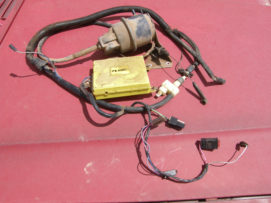

This stuff went in a box this afternoon, but I thought about this post and pulled it all together for a picture so you could see the majority of what you'll need.
Don't know how I spaced it, but there's a speed sensor on the speedometer cable behind the cluster that you'll need, and on that note, the cable itself is two pieces. You'll need to change the speedometer cable too.
