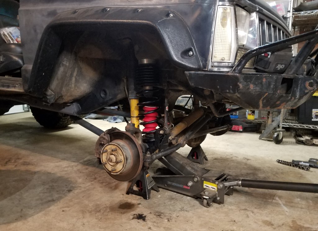

I am using the Metalcloak TJ 4.5" dual-rate coils, they give me 4.5" with the winch and heavy bumper out front. Currently have 6" of lift with spacers for the other 1.5". The ride is nice, they are softer than my old RE 3.5" coils but not squishy. I bought them because of the resting length, didn't want them to unseat on downtravel, and they don't.

i am also running the tj 4.5" dual rate metal cloak, they are nice, ride well and feel very flexy i am running acos to get me to just under 6" mine are rubbing my inner c's though just a hair at certain angles. i also got them for the extended length to keep my coils seated. they do well on the road from 0 to 90 and feel good, i have a heavy-ish front bumper, but no winch. i also run 5160 shocks, but they are too short and bottom out before i want them too, so i cant say anything about the go fast on bouncy trails yet. but the combo of them feel good on the road and off.

Not enough room for the full ACOS with those springs. I am using the top 1" ring from the ACOS and a rubber isolator for combined 1.5"

Whoa... That throws my plan out the window then.... Is it a diameter or shape thing that keeps them from fitting?

Min height of the full ACOS is like 1.75" ... Had to remove the adjustable part to get it down
It works for me because I already had it and I like the integrated bumpstop and all that, but they are kind of expensive to buy if you aren't able to use the adjustable parts
