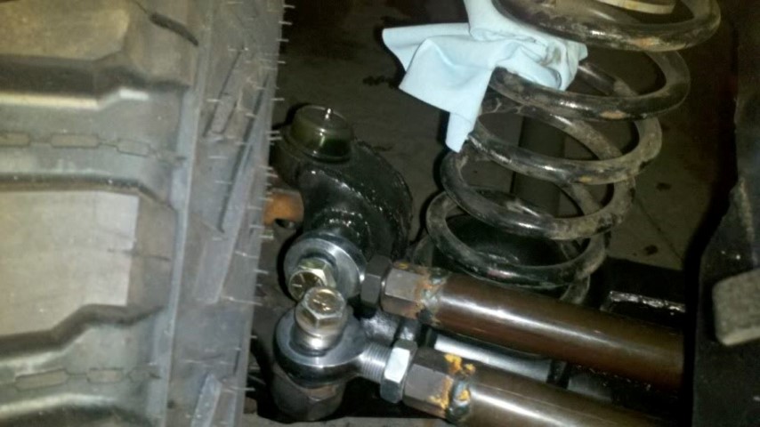

Having lots of time to work on my 99 2dr build, I wanted to get some opinions on what to do with my track bar. I think I know what I want to do, but it doesn't hurt to ask around.
So, I'm doing the IRO 3 link rock trac, IRO truss, and IRO double shear track bar set up. Did the WJ knuckle swap with custom steering from Parts Mike.
I'm real happy with the steering set up and angles, everything looks good, including the stock pitman arm.
As you can see from the picture, the track bar is way off. It looks like I need to fab and weld up a mount higher up on the truss to get my drag link and track bar parallel. The axle mount right now is just under the tie rod. Barely shows in the picture. I'll also need to fab up or order a custom track bar.

Where are you finding this recommendation for the track bar and drag link to be the same LENGTH ? Your primary consideration, and what you should be attempting to achieve, is to have the track bar and the drag link end points to be as nearly PARALLEL as possible. Equal length is a much less critical consideration.

Not here, but I can view them thru your profile page. You definitely need to do something with the track-bar. They do make raised axle side mounts for the WJ set-up.

Yes, I understand that. Sorry about the picture not coming through, when you see it, it will make more sense. According to Dallas at StinkyFab, and many others I have encountered during my research, there are 3 orders of importance. 1. TB and DL must be parallel. 2. Should be as close to horizontal as possible. 3. Should be equal in length as possible.

Got a better picture of that setup? Is it still an inverted Y link? Looks like draglink and tie rod in that pic to me? Looks like a poor and WJ knuckle from that pic.

The setup we did on 4643 is the best way for sure, but you are too far along to make that work without redoing a lot.
I would advise this kit.
https://www.stinkyfab.com/products/sfr-otk-track-bar-kit-for-jeep-xj-mj-zj
You will need to grind the axle side bracket and your truss a little to make them work but it will work
Thanks, Cal. I was actually looking at that setup, too. No problem on the fab on the axle side. Easy enough for me to do. Looks like the StinkyFab Frame bracket is offset a bit to the front. Is that correct?

The bracket is offset a little toward the front of the car yes, but not as much as you probably think it is. The bracket is built to take a 2 5/8" wide joint so that you can use a larger johnny joint or heim if you choose - since it is wider than other brackets it looks WAY further forward.

Update. Shout out to Dallas at StinkyFab. Traded emails with him on Monday. Really helpful, answered all my questions in a timely manner. Ordered the 2 brackets on Monday evening, and they arrived today. Great service! Thanks to Cal, too, for recommending StinkyFab's brackets. I have used parts from Dallas before, so I knew of the quality.

I decided to modify the axle side bracket and cut into my truss a little bit. Got it as far over as I could without hitting the coil bucket.
