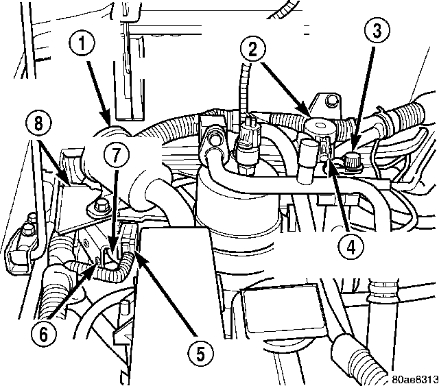

Did you investigate the code you pulled? EVAP purge solenoid? Number 2 in this diagram. Google it.

Last night I met up with 4x4 XJ and hooked up my DRB, I found the P0443. I ran an EVAP activation test, found the solenoid didn't buzz. I swapped it with a known good solenoid, still no buzzing. Swapping the ECU for a known good one, still no buzz. I checked the connector and found the EVAP solenoid had no power. We replaced fuse #10 in the kick panel and now the EVAP solenoid works and the code shouldn't come back.
