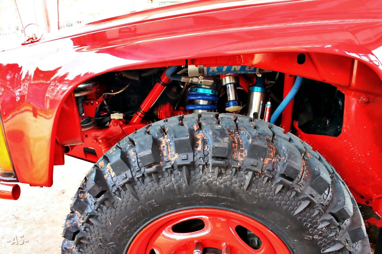

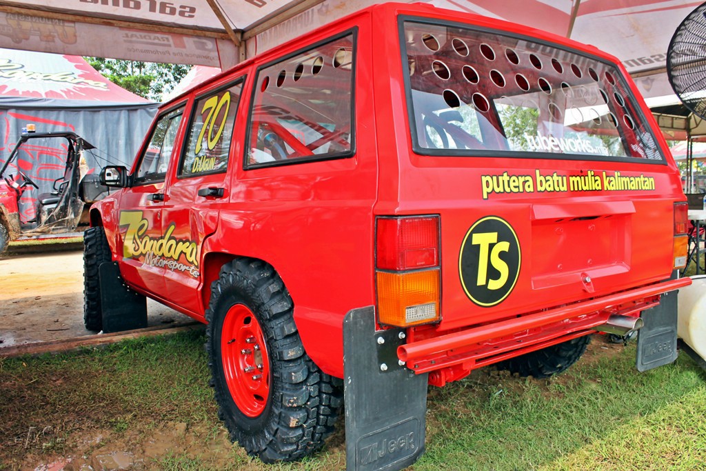

It it quite low. TOTAL Suspension travel 12", 5-6" for compression, 6-7" for droop. We still need to cut the fenders or even raise the fenders, as the front tires need more space....
As for the rear, we modified the area where the AXLE travel up for compression, so that it still have 6-8" of wheel travel.

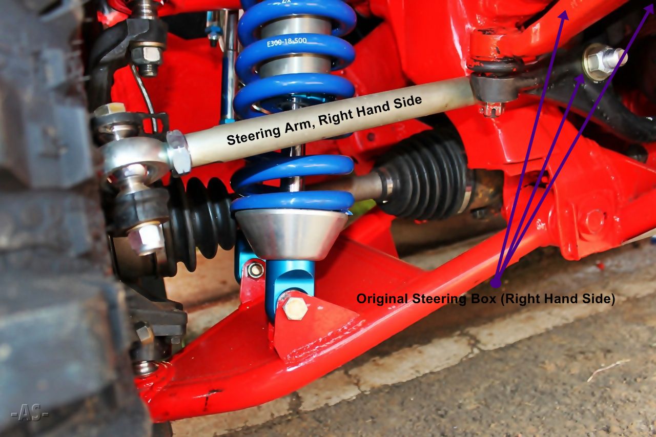

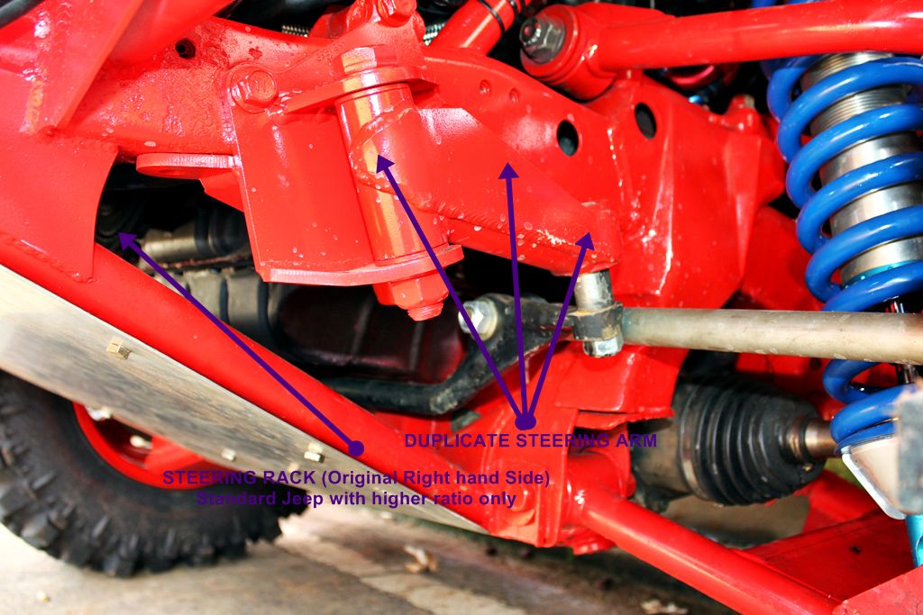

What steering rack are you using? - The Indonesian Cherokee is right hand side Driver, so the steering rack / boxx is on the right side, It is using the standard Cherokee / Jeep Steering Box as of right now.

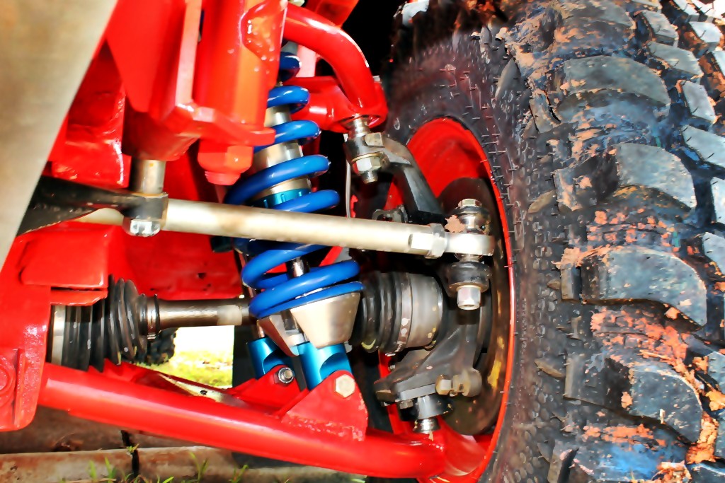

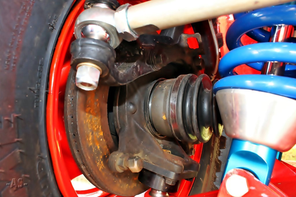

Left Hand Side A-ARM, Steering Bracket, etc
img_9347-jpg.140378

Actually, the whole KIT is for TOYOTA Front PARTS, BUT not the whole Toyota front clip.
We ordered a +4" inch kit from Total Chaos, then we went around looking to buy front half clip of Toyota 4WD PICKUP/HILUX. We then take the whole Front Axle Housing, as well as the front Upper and Lower A-Arm Mounting, as well as the spindle / up-right.
img_9332-jpg.140492
Next, we installed the front axle housing along with the A-Arm mounting and the spindle / up-right on the Jeep Unibody Chasis and welded everything as it should be. So the front is still one-piece Jeep Unibody, but we modify it to allow mounting point for the A-ARM, etc and strenghtened the fron using triangulation cade.
