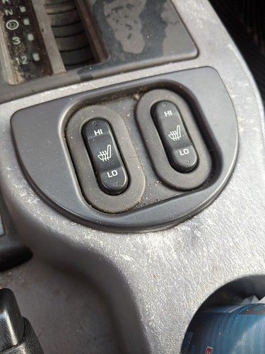

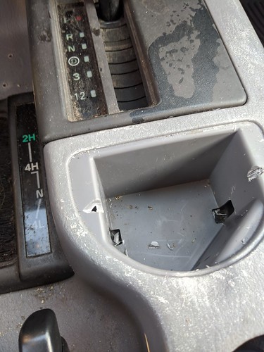

I snagged this switch a couple years ago and finally got around to installing it in my 98. I can't remember what year it came from though, but it's at least a 97-01. It seems like the switch doesn't quite fit right. I pulled the ashtray out and tried to pop it in, then noticed 2 little tabs underneath that don't seem to line up with anything on my console. I even tried carving out a spot for them to fit but it didn't seem to help. I'm not even sure it's compatible at this point. The latches at the very bottom don't grab like I figured they would.
I can't seem to find much info on the factory heated seat option. I guess most people aren't too concerned with luxuries.

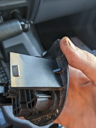

These are the tabs that I was referring to (the ones by my dirty thumb nail). I had to notch the console a little to get them to fit.
Dang this thing is dirtyyyy

I put heated seats in my '00 that did not come with them.
Getting the ashtray out was a bear.
Putting the switches in was a piece of cake.
I am looking at my pictures of the install.
And my console appears to look different then yours.
I don't have any really good pictures showing it though.
But I have a theory.
So '99 was the first year of the heated seats in an XJ.
Thinking the console is slightly different in this area so they can put in the switch bezel in when the Jeep is optioned with heated seats.
I don't have a third parts picture posting thing, refuse to get one, but if you go here:
https://www.cherokeeforum.com/f59/wh...5/#post3563481
And look at Post# 91265 you can see the shot I do have.
I can't tell if the big slot is wider or longer then yours but don't think it is.
What I do see is that little notch at the 6 O'Clock position.
Where you modded your console.
So I think you are on the right track just need a little more work done there.

I'll have to keep massaging things until it works. I really don't want to have to resort to screws underneath, but it's just not snapping in like I thought it would. And man, I really need to clean that thing up some before getting pictures. I didn't realize how gross it was.

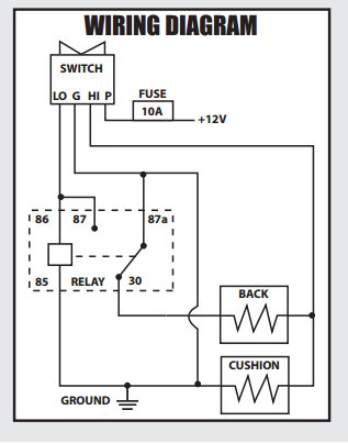

Ralph77, I looked into wiring diagrams and found something really neat. I was wondering how to go about making hi/low work on this thing. It's pretty simple. In high, wire them (back and seat heaters) to come on in parallel. That way you get full voltage in each branch circuit. Since their resistances are both equal, you get the same (higher) current for each pad. However, to get LO you would wire them in series. Since they are getting half voltage each, they also get half of the current. That also means that each heater pad (in series) is only getting 25% of the power (watts) they would in parallel.
I'll get it all figured out and make it simple. And probably before it starts getting cold. I hate a cold butt.
