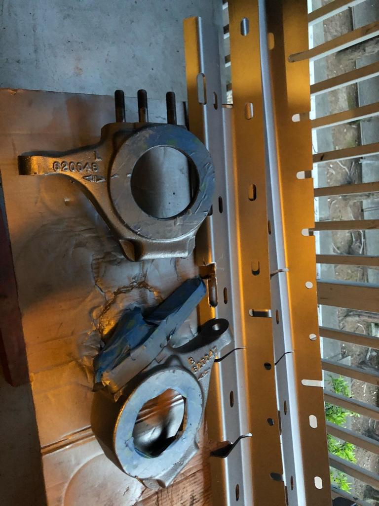

D44 cut turn: I am half way through the process and I’ll post the pics that I have so far. Basically I used a cut off wheel and was really careful to cut only the weld on the inner C. When I was sure I had cut all the way through I took an 8 lb hammer and a map torch and hammered them off. Quite a tight fit from the factory.
Dude don’t sand too much, they are supposed to be a tight fit. Like heat the knuckle up in the oven or grill and put it on the tube at night.
If you are not narrowing, you don’t have to take them off. Just cut the weld and turn on the tube.
