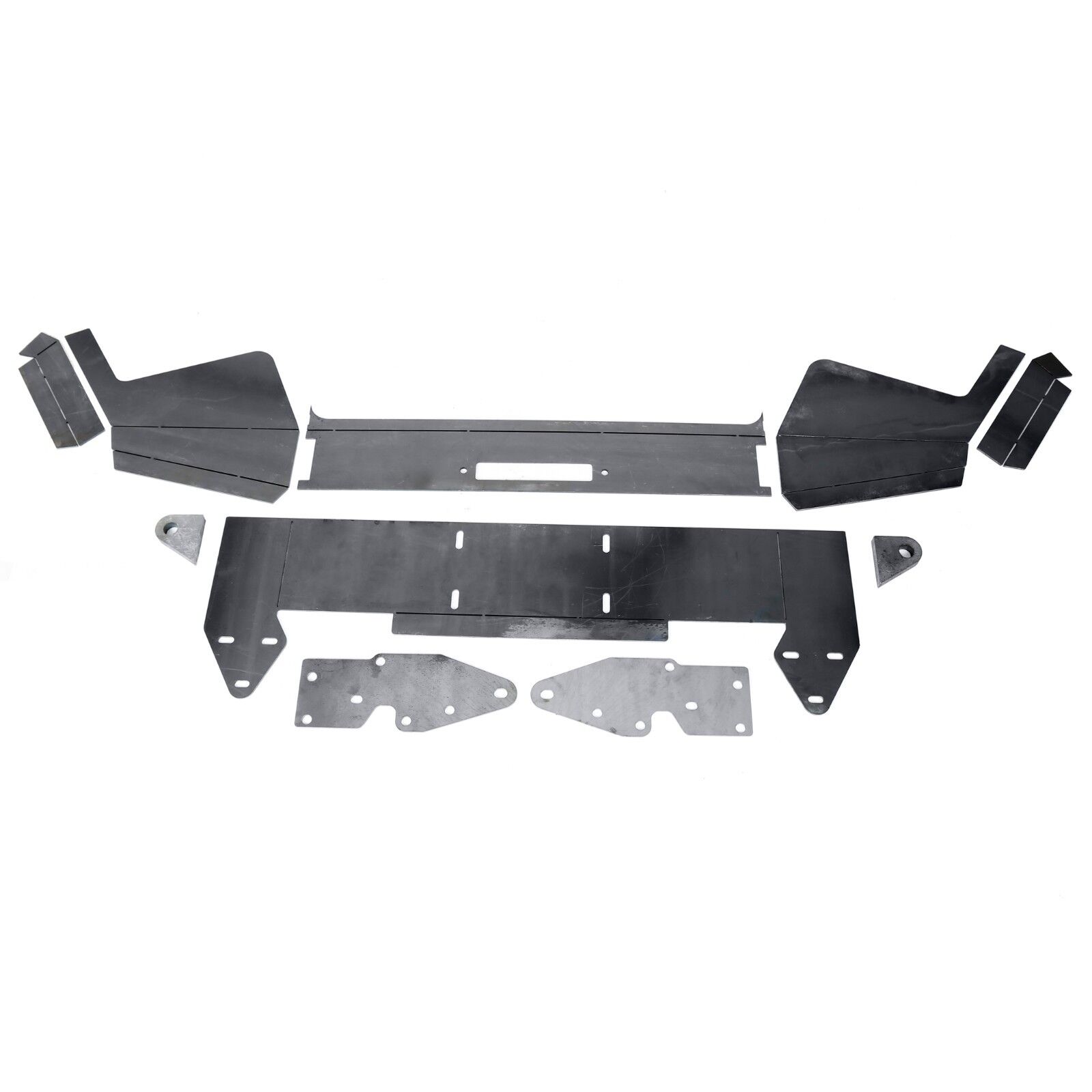

Hi All, anybody purchase or know anything about these JCR DIY clone front winch bumpers on E-Bay??? Looks like a perfect duplicate at half the cost. Sorry for the size of the image cant seem to make it any smaller.

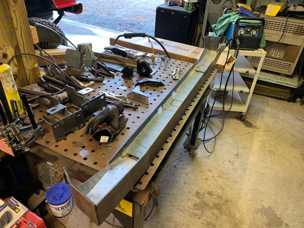

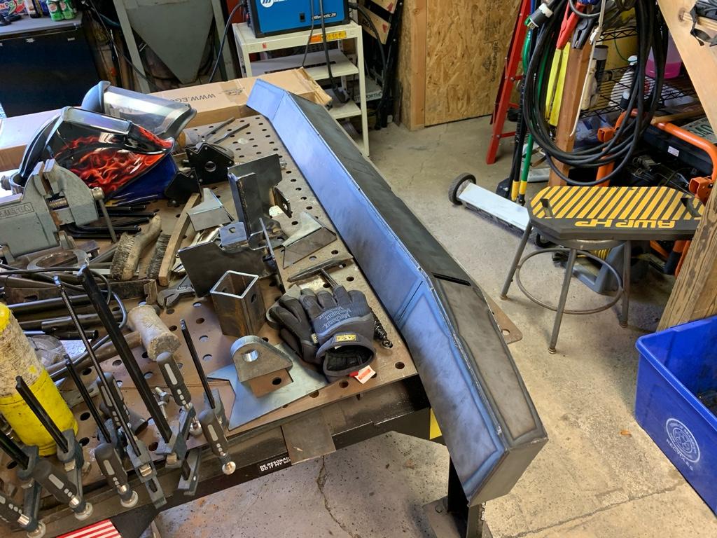

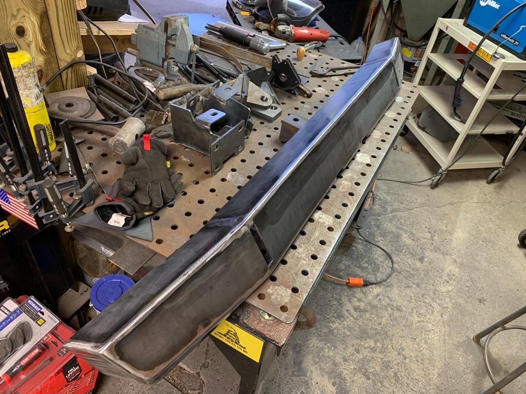

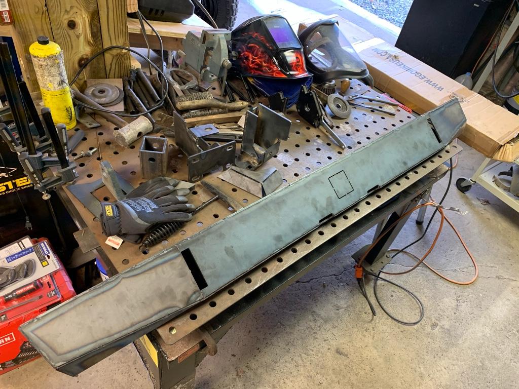

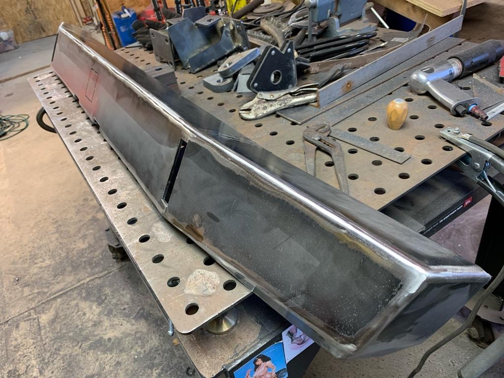

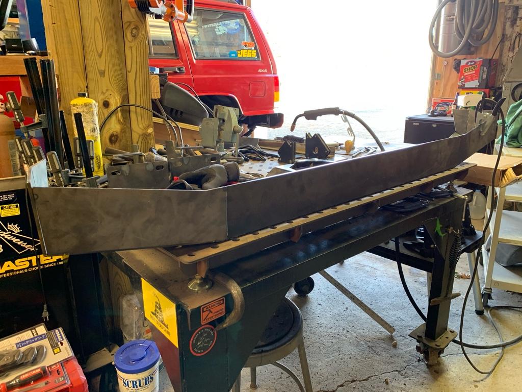

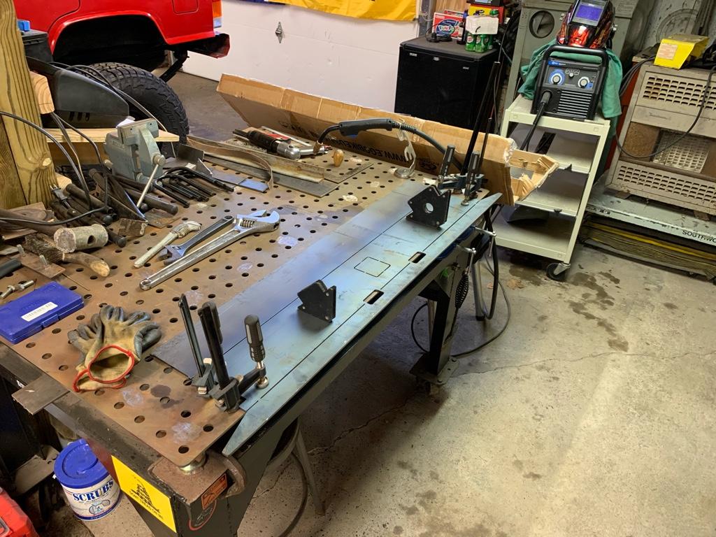

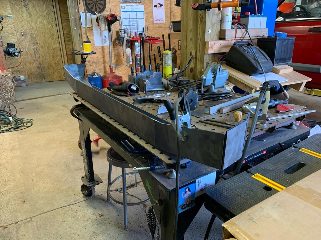

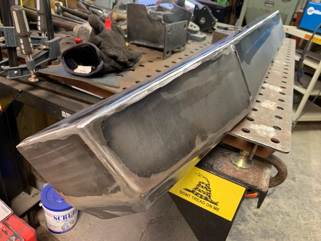

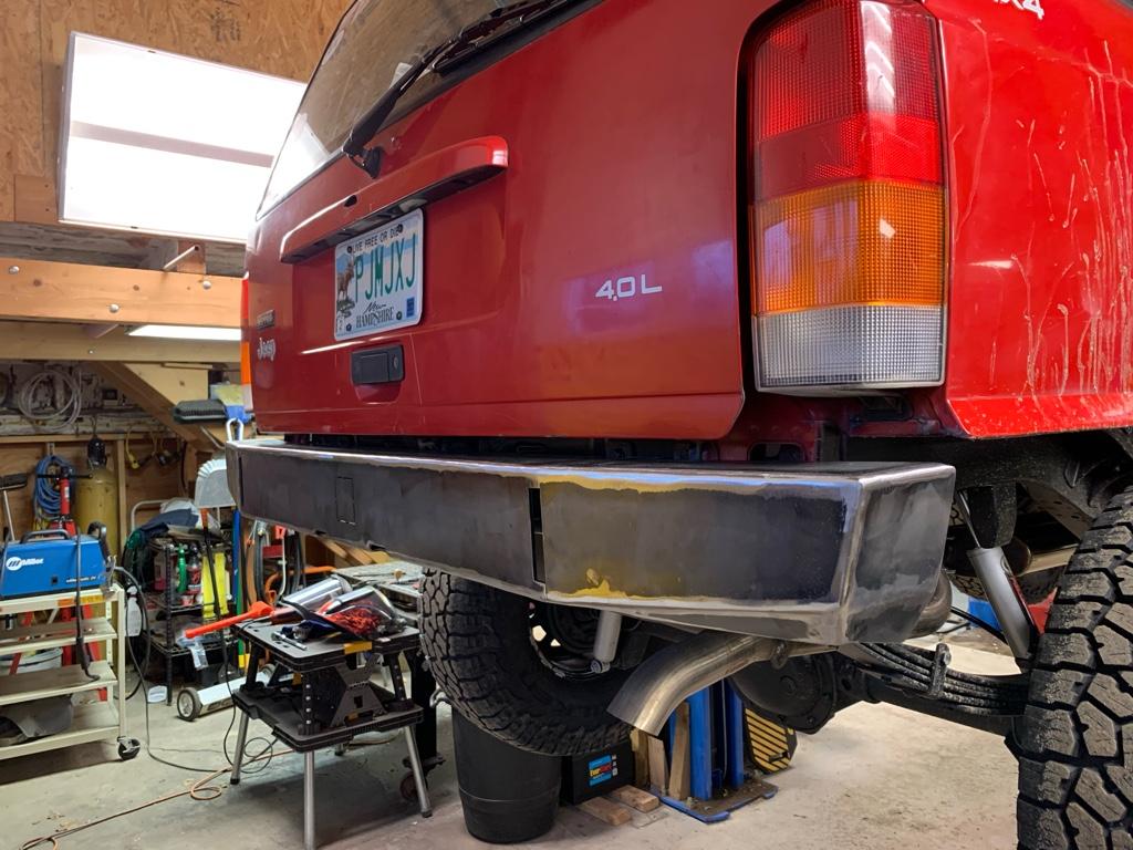

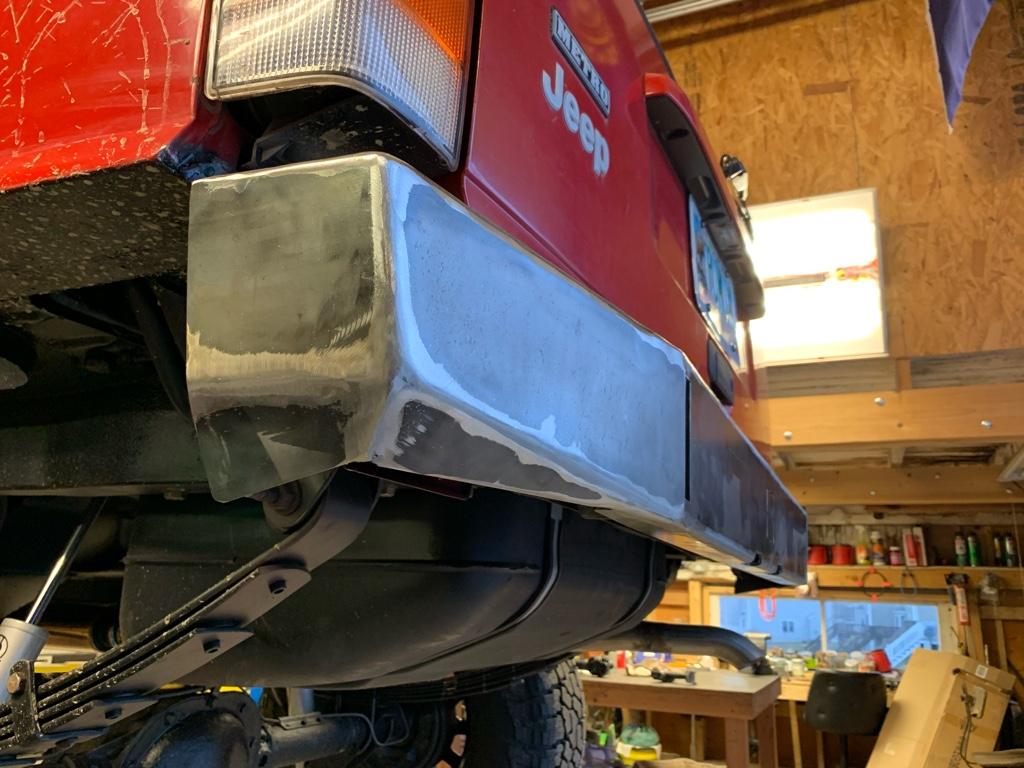

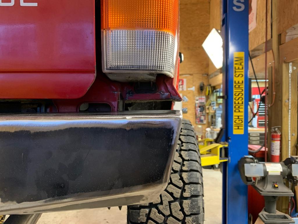

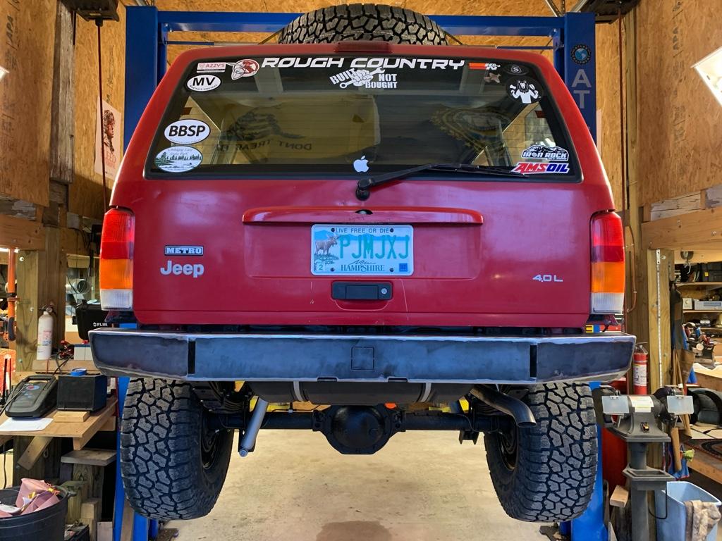

Got this rear bumper just about ready for paint.
The lines are great, nice simple layout. Been welding and grinding up a storm, itís a tone of work...but Iíve enjoyed it. Like mentioned above, Iíll be glad to be done with it soon...lol.

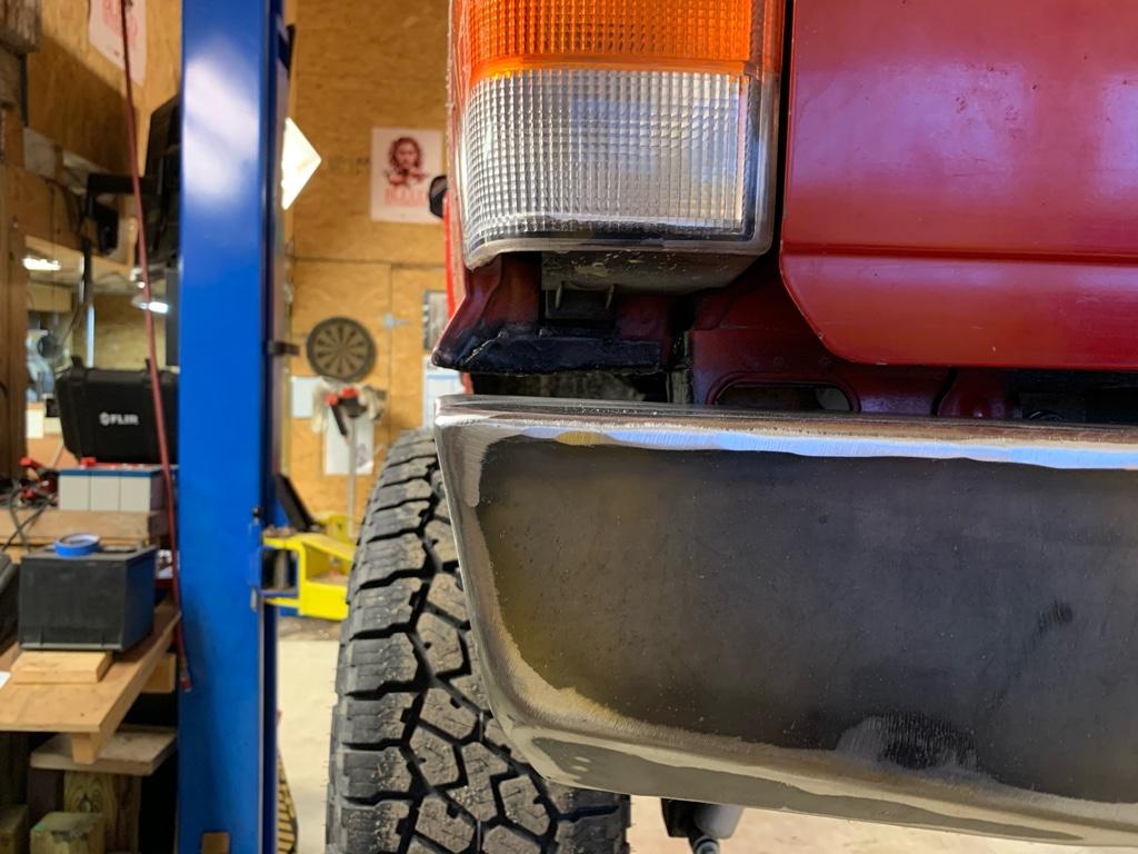

The bumper itself looks good, but the mounting "sucks", at least my DirtBound had tie-in brackets to the frame rail.

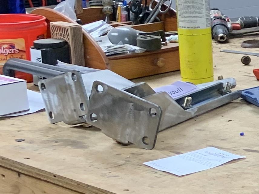

There are tie-ins to the frame, I just didnít post a picture of them...
1/4Ē plate, welded to 1/4Ē 2x4 tube, pre-cut and drilled to grab 5 holes per rail, pre welded grade 8 nuts paired with grade 8 bolts, 5 per side. Iíd say that doesnít ďsuckĒ too bad.

I was looking at all the pics, that's definitely better.

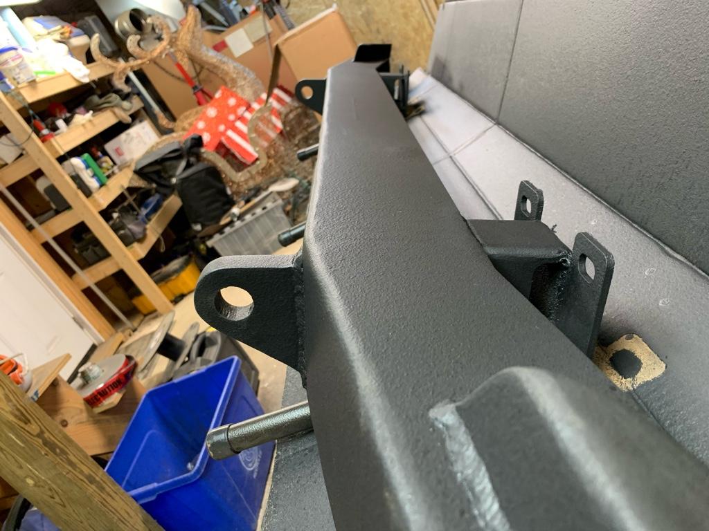

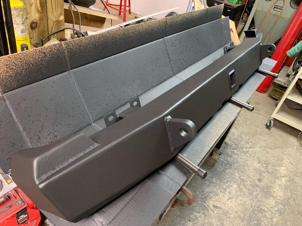

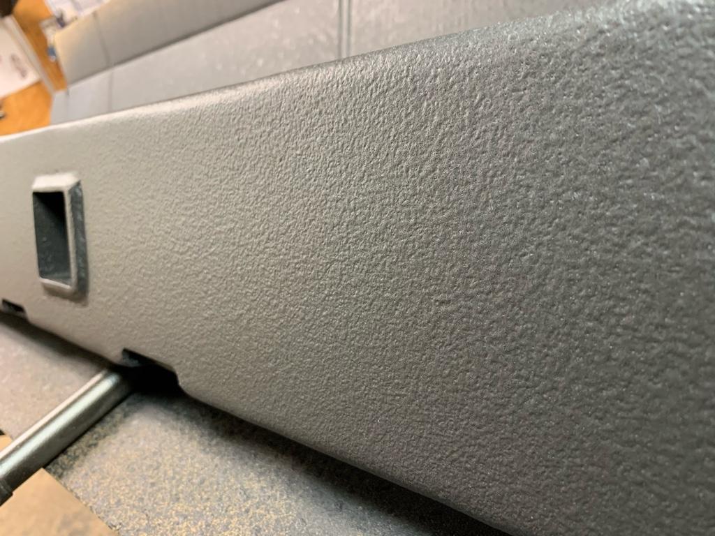

Got the bumper finished up. Iím pretty happy with how it turned out.
It was a lot more work than anticipated. Iím not sure Iíll do the mate DIY bumper for the font, or buy one to bolt on. Iím sort of burnt out as far as working on the Jeep...I need to get to wheeling it/having fun with it. After a while I might reconsider and do the front one...we shall see.

That came out really good.
