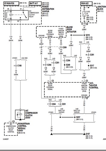

The ECM does control everything in the A/C system.
The A/C compressor relay is controlled only by the ECM, nothing else is in the circuit to cut power. The high and low-pressure switches connect directly to the ECM .
From the 2000 FSM
