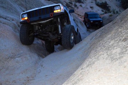

Here are a few pics from its first year of wheeling (and mine haha)

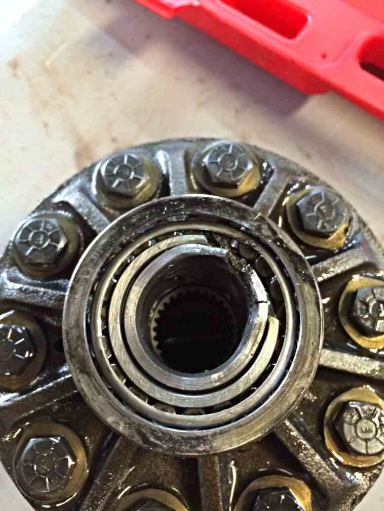

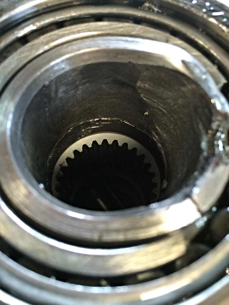

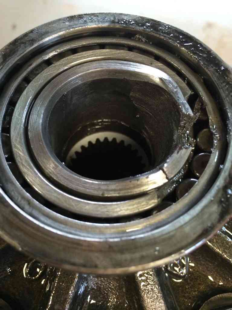

Tonight I started tearing into the d30. To find a bit more damage than I had hoped for.
Man o man am I glad I pulled the shafts and the front shaft for the drive home from Reno. That would have been epic on the freeway when it started to let loose.
So now I'm debating time and money to either throw another carrier from rustys for 80$ or try and grab a grizzly for 500$. Either way I am scrambling right now with only 4weeks till sf.
What do you guys think. Remember thes are not long term axles for me.
Man thats bad. well I am glad you didnt drive on it!
also rwkhaus on here has decent prices on d30 carriers and fast shipping and good shipping prices. I think another open carrier and slap the locker in for now and call it good since you don't want to dump a ton of money into the things.
if it was a more permanent setup id say grizzly all the way. hell, it'll be fine for the con, SR, and DV
Woah! Thank god you pulled the shafts out. I agree with Sam, if it's short term go for the cheaper option and throw the monies at bigger things.
grizzly say 500$ shipped. open carrier say 80$ shipped. save the 420 for better things.
