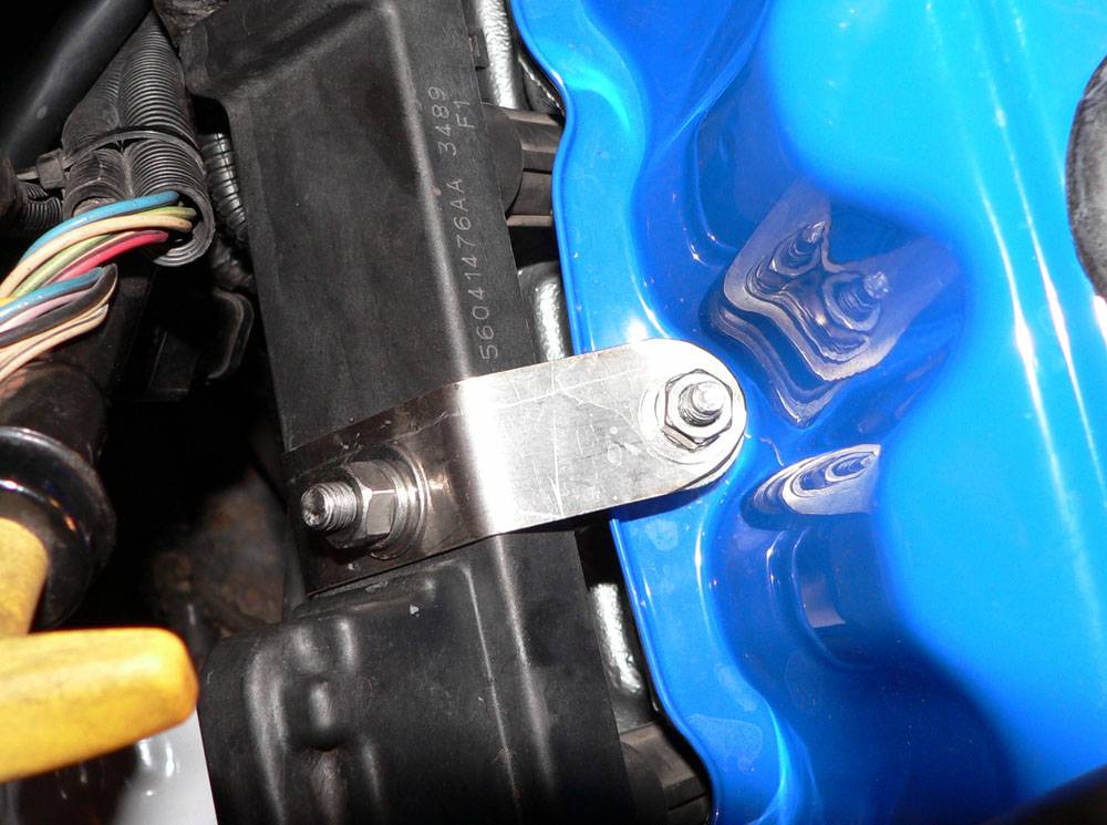

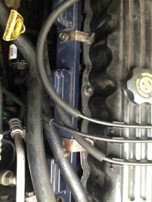

My 2001 XJ has a 7120 head, using a Banks header and coil brackets, like the one shown by J1MBOB. A Banks header will cover the exhaust ports of the 0331, 7120 and 630 heads.
With the stock air box and hose used, it looks stock. My 01 just passed California's biennual emission testing and inspection. This may not be a consideration for the OP but those who live in stricter inspection states need to know this.
