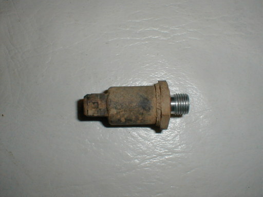

I think the nut was already factory torqued on mine. If that is even the style I bought? Slept since them LOL. As I recall you can buy just the black part now too. And it would have probably include re-torque specs if they even exist? But that is the new style sensor. The old / OEM one for Renix was very different as I recall. IT had no nut top side:
yea i have the black aftermarket sensor in the above pic.
i put it back in with normal "wrist torque"
seems to be fine....i have a renix diagnostic module and the knock counts seem to be okay and the ignition advance seems normal so on to the next.....thanks to all replied :cheers:
