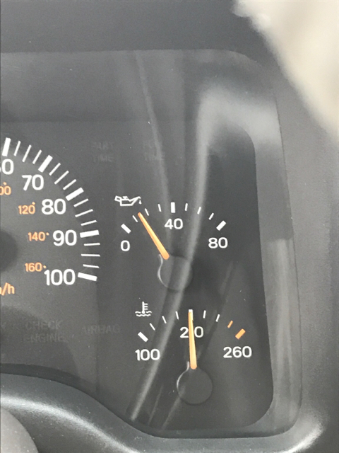

Is this normal for a 97 4.0 with 190k miles and 10w40 with Lucas added?
Re: 97 XJ 4.0 Oil Pressure with 10w40 & Lucas at warm Idle. Is this normal? (See Pic
the dash guage is not 100% accurate but that's about where my 90 sits with 270k on it.
once it warms up it always seems to go back to the same place for me.
10-20 psi at warm idle is normal and common.
Try changing the oil pressure sensor. Its not expensive and it backs out with a 1 1/8 socket. I got like 10 more pounds after swapping mine out. The Lucas has to mix with everything for a while too.
