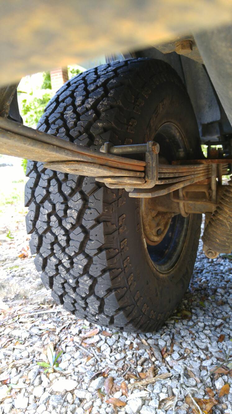

My wife managed to get a couple of ok pictures of the rear spring/shackle for me.

The shackle looks like it's pretty much straight up and down, but it's hard to tell. From what she said it sounds like it rides a little stiff in the rear. I don't know if I've ever ridden in a Jeep with a bad shackle angle, so idk how much difference it will make, but since I'd like to fix it anyway I'll probably do the no lift relocation right away.
It also looks like it has the 5 leaf OME spring pack which has the higher spring rate of the 2 they offer, not sure which height. Does anyone know if OME stamps part numbers on their stuff? Will I be able to tell what exactly is on there? I think I'm gonna look into getting their lower spring rate ones since this jeep doesn't have much weight to it.

The shocks don't look like air shocks to me, but since they're black and unlabeled I'll have to wait until I get home to find out exactly what they are and determine if they warrant replacing.
Nice and clean. Just like mine when I first purchased...and still today! HA!
I have the OME Medium leaves (CS033RB) and it does not have a problem with sagging; I tow a 2500lb boat, it drops maybe 1/2" static. Most people think air shocks are "insurance" against sagging.
I also removed the "extra" left, and still netted 3.5" over stock lift. The rear shackle angle on mine is vertical with a 3/4" Rusty's lift shackle. I need the reloc brackets, but it doesn't ride bad at all; firm. I run Bilstein 5100s.

OME leafs have part numbers painted on the top of the pack. And shackle angle makes a HUGE difference. Get some relocation brackets before making any other changes to see how you like it.

I made my assumption about which these were based off of their current catalog, I didn't see the CS033's in there, only the 34 and 35. I guess they got rid of the 33. I'm googling the specs of it now - It could be that that's what is currently on there, I dont know how long ago he installed the lift.
I did learn after looking in their catalog that the "lighter" duty CS034 is actually a stiffer, static spring rate than their "heavier duty" CS035, which is a lower rate and has an overload to make it "dual" rate. Pretty confusing.
Did your CS033RB's come with an overload leaf on the bottom?
