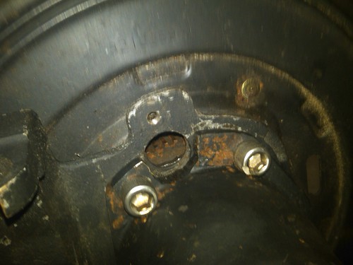

The Dana 35 backing plate and brake assembly.
And the Dana 44 backing plate and brake assembly.

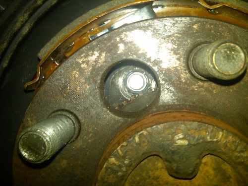

This is the orientation of the sensor and the tone ring on the Dana 35 and is what we are trying to recreate on the Dana 44.
After a lot of careful measuring, I determined that in order to get the tone ring where it would properly match up with the sensor, its outer edge needed to be exactly 1 3/8” away from the surface of the retainer plate. I used the retainer plate as a reference point as it was close by, easy to measure from, and it’s the surface your ABS sensors will mount up to. You can see the marks I scribed on the flange in the following picture indicating where the tone ring has to be mounted.

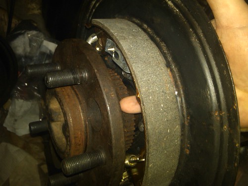

I realized while writing this up some of you may have already removed your retainer plates. I figured you could use the wheel mounting surface for a reference, but I can’t get an exact measurement with the axles and brakes already installed. As best I can tell it is 1 1/16” from the WMS to the outer edge of the tone ring.
I wanted to remove as little metal as possible when installing the tone rings so I asked the machinist to turn the flange just until there was a nice machined surface for the rings to press onto. Turns out that at exactly 2”, the rough casted surface is machined off, leaving you with a nice clean shoulder to press the rings onto. The inside diameter of the tone rings are then machined out to 1.999” for an interference fit. Unfortunately, I don’t have any pictures of either part as the machinist pressed all the parts on before I could take a picture of them. Here’s a picture of the finished product (after a fresh coat of paint) with the dimensions drawn in to help eliminate any confusion.
And the pretty pair all ready to be installed.

Next up, and ironically what I found the most challenging, was the sensor mounts. Here’s where all the voodoo, mystery, and magic surrounding ABS brakes comes into play. The ABS sensors are essentially magnets. As the tone rings spin past them, each little ridge causes a pulse to be sent through the sensor and up to the ABS module. In order to get a good pulse, the gap between the sensor and the tone ring has to be within FSM tolerances. This is easily adjusted using a feeler gauge. That’s it, pretty simple, huh?
It would be, except that the bolts that hold the backing plates (and thus the ABS sensor mounts) on the D35 are closer together than they are on the D44. This means a little fabrication is in order. I tried like hell to make this a no-welding-required project, but found out in the end that in order to do it right, two small welds, each about ½” long, will have to be made on the mounts. You can do it without welding, but it will make things more difficult for you down the road. I’ll show you each of the attempts I made starting from no welding and working up to what I believe is the best way.
First, a picture to demonstrate the problem. As you can see the bolts are further apart on the D44, no two ways about it.
If you look close in the above pic, you’ll see I ground a notch into the end of the mounting bracket to make it fit right up against the bolt. This was easily done using a Dremel with a small grinding stone.
When installing the mount, I sandwiched it between a washer and the retaining plate. This worked OK, but I found that when you torqued the nut down to FSM specifications, the mount had a tendency to get spit out from behind the washer. You could make it work if you held it in place while tightening the nut, but it really wasn’t ideal.
Next attempt was to cut open the bolt hole and spread it to create tabs to be sandwiched on either side of the bolt.
This worked out much better during installation, but I found out while putting in my second set of bearings that torquing down the nut had caused the tabs to deform, rendering them almost useless for a second installation.
Both of the above methods were at best a one time use modification. Ease of install and durability however were not the only issues. Due to the brackets being off center, the sensors are also off center. This prevents the sensors from being able to line up perpendicular to the tone rings at the proper gap. The sensors adjust in an arc, so once you got them close enough to the tone ring, they lined up at an angle instead of flat. This caused sensor adjustment to be very difficult. With a lot of trial and error, I finally managed to adjust them “close enough”.

Here’s a quick drawing of correct and incorrect sensor alignment. I couldn’t edit the image to give an actual representation of the sensor/ring alignment, but it gives you an idea of what I’m talking about. You’ll have to actually mess with them to see exactly what I mean.
We’ll refer back to the above picture in just a bit. So on to the right way. Cut off the ends of the mounting brackets and get yourself a couple of pieces of appropriately sized scrap metal to extend the mounts with.
With the axle shaft in place, loosely install the sensor mount using the remaining bolt hole and then loosely install the sensor on the mount. Using the bolts as pivot points, rotate the mount and the sensor around until you find the orientation that gets the sensor looking as much like the “Correct” picture above as possible. Snug the bolts to hold things in place and then figure out the proper angle and shape of the extensions. Weld them on, and drill your new bolt holes in them. Regardless of the shape of your bracket, the bolt holes should be exactly 2” on center in order for them to slide smoothly onto the bolts. The welding doesn’t have to be perfect. Shoot, it doesn’t even have to be pretty. You could probably even JB weld the pieces together if you trusted the stuff. Just so long as it will hold the two pieces together when you torque down the backing plate nuts.
A little bit of primer/paint and you’re good to go.

Next, install your sensors and swing them into position. Insert a feeler gauge (I had good luck with a .035” steel) between the sensor and the tone ring. As you tighten the sensors down, they will actually press themselves right up against the feeler gauge. Get them snug and then pull out your feeler gauge. It’s a tight spot to work in, but easily done once you get the hang of it. You can see the feeler gauge in this picture.
When you’re done it should look something like this.
