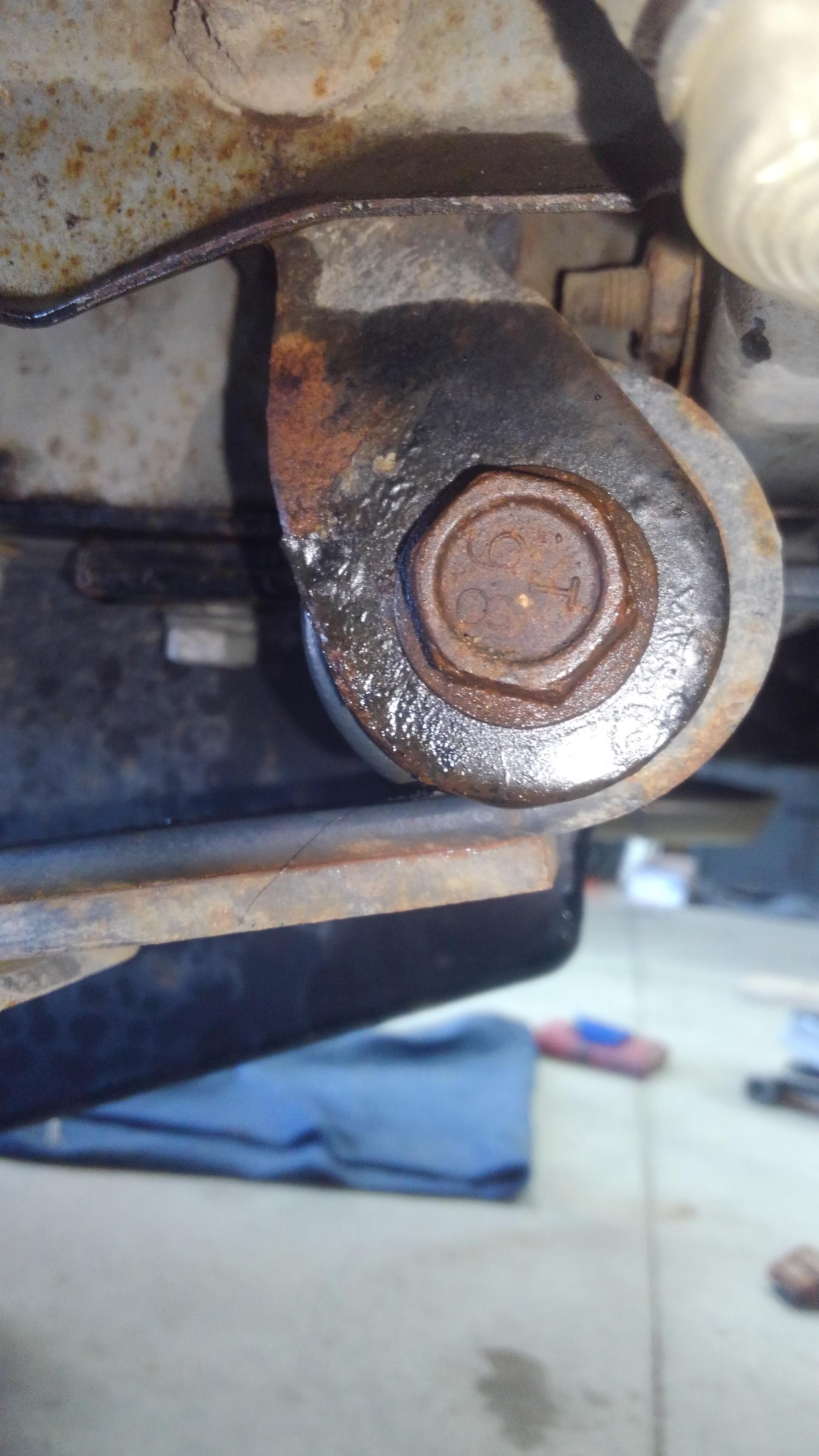

  #23
Old October 17th, 2020, 07:34
Tim_MN's Avatar
Tim_MN Tim_MN is offline
Freakish Hand Strength
Join Date: Mar 2003
Location: Minneapolis, MN
Posts: 7,139
Re: Rear Suspension Issues
The leaf spring eye bolt is in backwards, and banging on the bumper bracket and gas tank skid plate mount.
With the tire removed, post a picture from the side showing the shackle angle and spring arch.

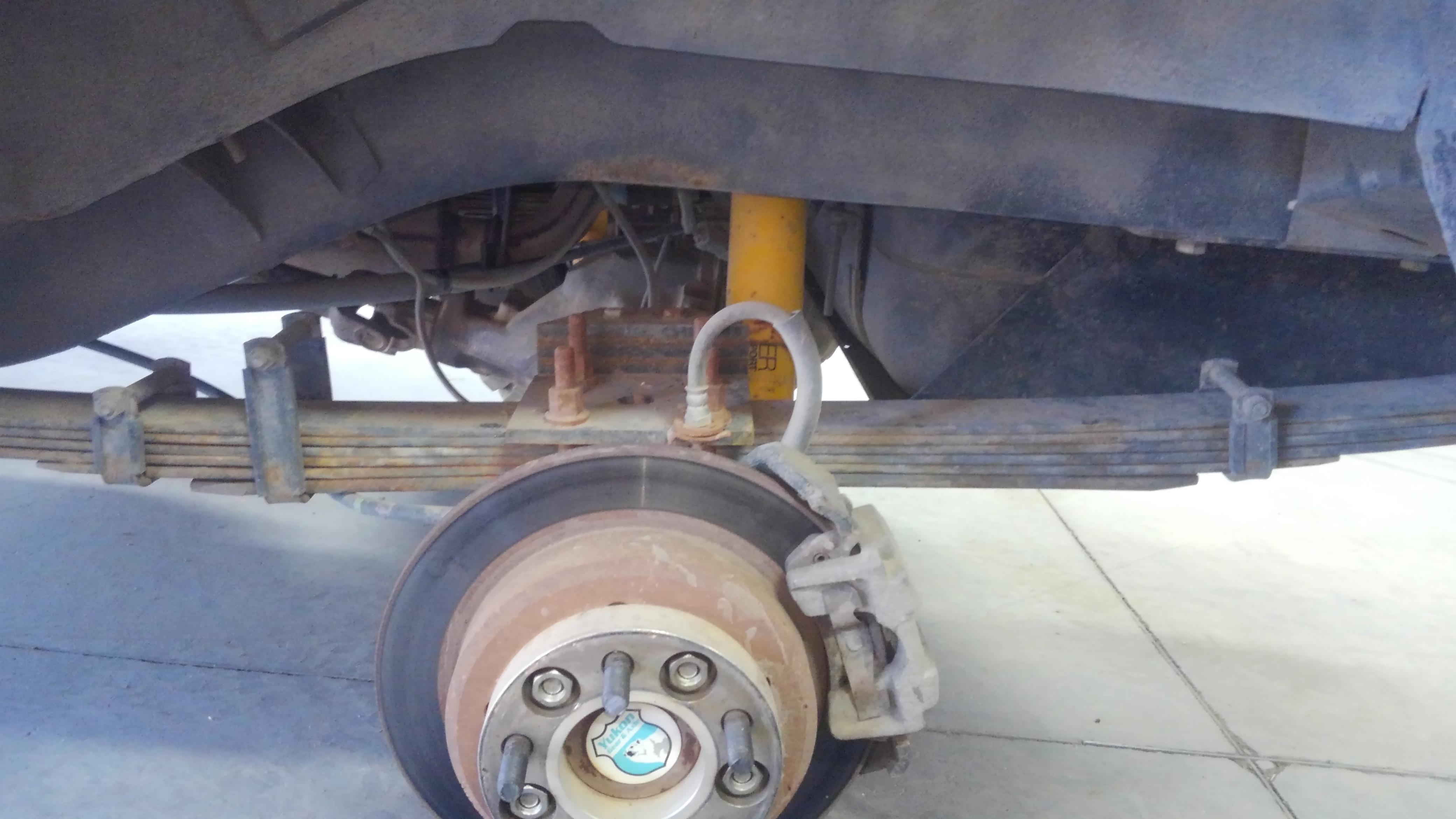

  #27
Old October 17th, 2020, 10:55
NOTNSUV's Avatar
NOTNSUV NOTNSUV is offline
You Guys ROCK!
Join Date: Aug 2012
Location: Spring Creek, NV
Posts: 328
More pics. Duplicate threads now. Will relo and/or drop brackets help or hurt?

  #28
Old October 17th, 2020, 11:36
RCP Phx RCP Phx is offline
Join Date: Mar 2003
Location: Phoenix,Az
Posts: 14,108
Well you didn't take a pic of the shackle angle but your springs do seem a little flat.
  #29
Old October 17th, 2020, 11:38
NOTNSUV's Avatar
You Guys ROCK!
Join Date: Aug 2012
Posts: 328
Like this?
Sent from my E6810 using Tapatalk
1999 XJ Sport 4.0L Black
OME, ARB, JKS, AJ's, JCR, Rusty's Offroad, BFG, Black Rock, Vision-X, Warn, Spectre, Napier Precision, Kenwood, Daniel Stern...
  #30
Old October 17th, 2020, 11:46
Evan03 Evan03 is offline
Join Date: Jun 2017
Location: Idaho
Posts: 575
Shackle bolt is sticking way out. Does it have a witness mark on it.? Othere side?
Springs look fine to me. The flatter the better.
