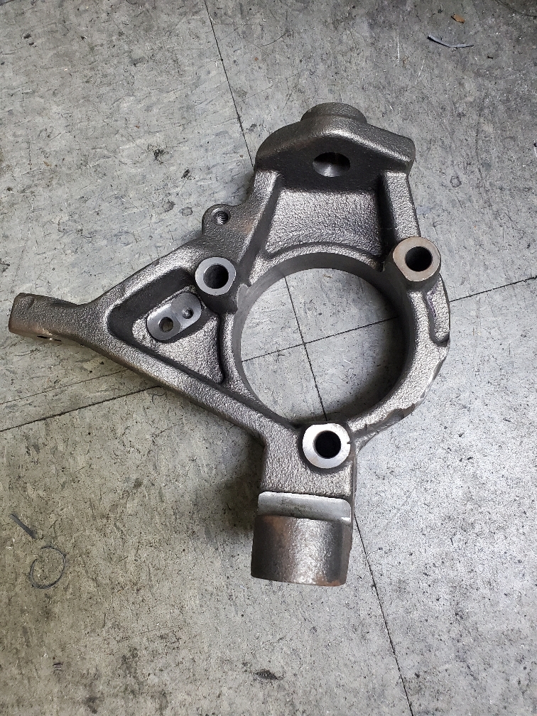

i was originally in the same boat but a fabricator buddy of mine had desined a set up that only requires you to modify your existing knuckle and uses the 3 bolts that hold the unit bearing on. I just got the brackets the other day and just got back into town so i will be messing with them tormorrow. With the setup he had designed i was told it would actually fit 15 inch rims but will verify as soon as i can. with everything i think im about the same price as the kit wilwood offers and that is with knuckles that i scored for 60 for the pair. I was asked if there was a market for the kit but i onle really see people asking about wj swaps and thats it
What calipers and rotors will you be using with those brackets?

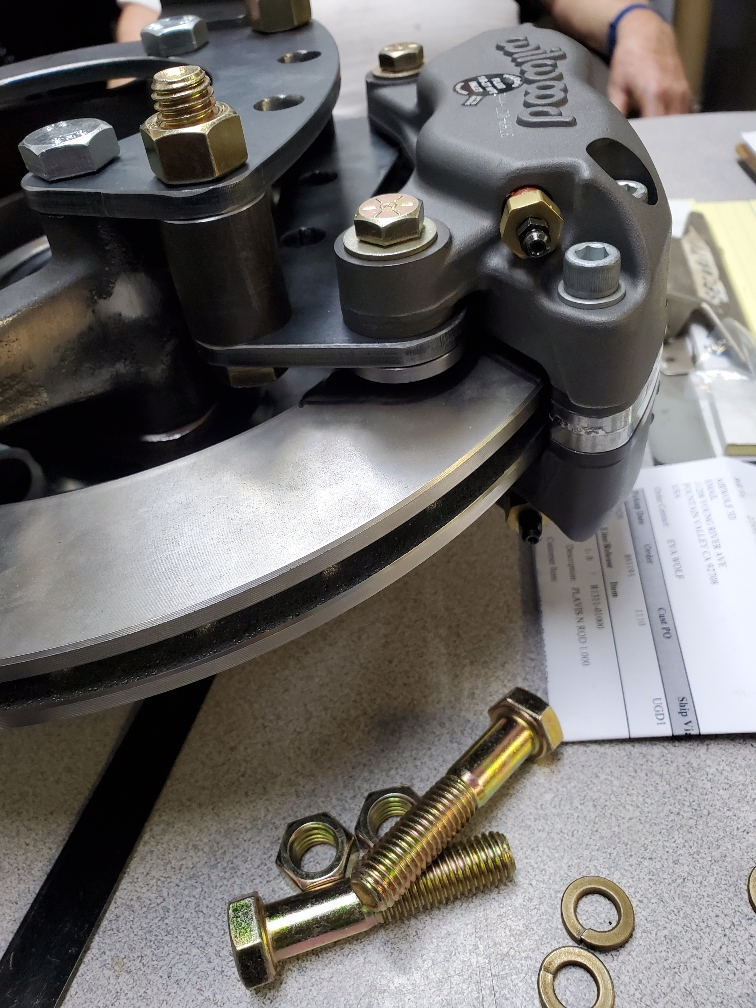

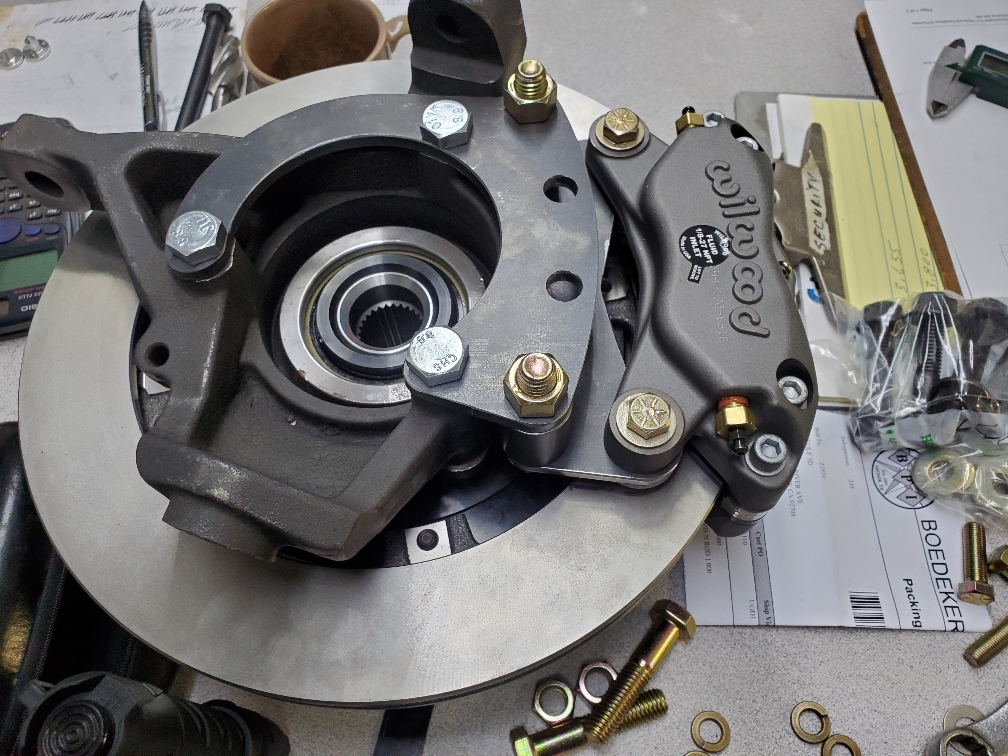

Dynalite calipers and the wilwood 160-5844

1.75 piston. I am hopefully gonna have it together this week and will upload pictures when I have a chance

VANCO Big Brakes and U Turn steering
Here are some photos to give you an idea of what exactly is going on

How big is the pad? And how do you change them. There are no visible retention pins in your photos so do you have to separate both halves of the caliper to change the pads?

They are top loading with a cotter key(which you can barely see in the pic) to hold the pads in.
