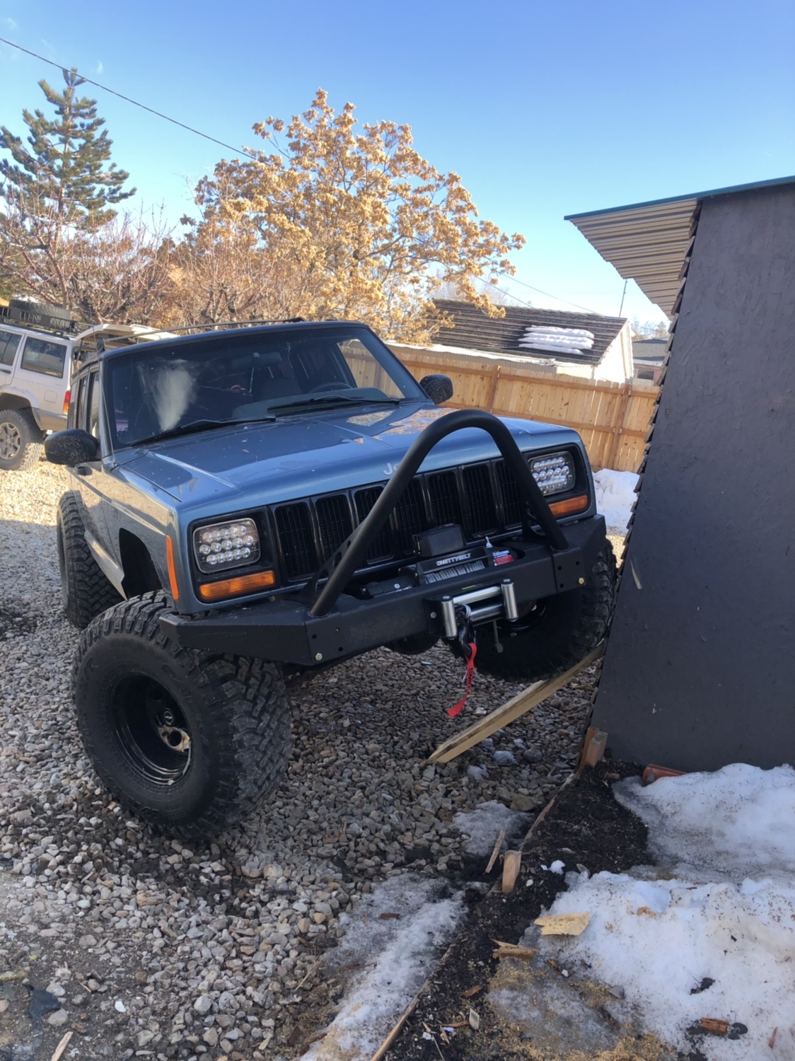

Here is an old photo of mine.
4" lift and 33 X 10.50-15s, on stock rims.https://flic.kr/p/7gw7nr
The fenders have been trimmed and the flares moved upward.
