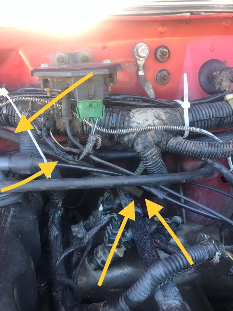

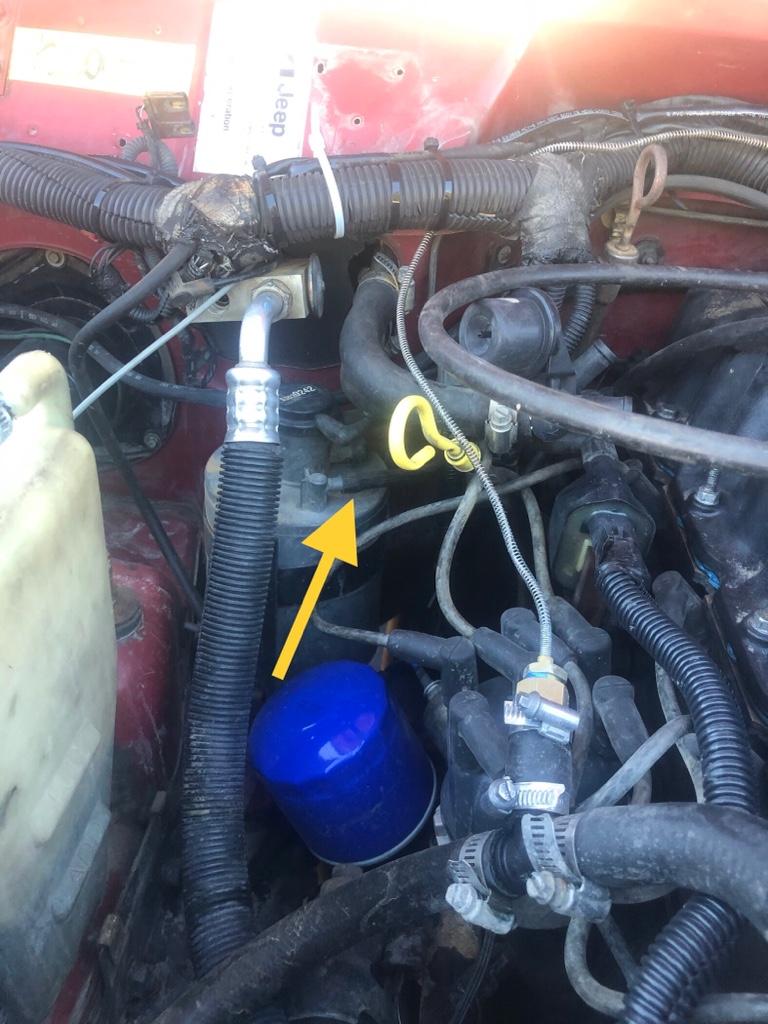

So I had a smog text done on my 89’ xj. I failed because a fuel evap line was leaky and upon inspection I found a loose hose attached to the emissions canister routing to the rear of the engine bay on the drivers side. The smog tech told me that my problem most likely is fixed once I place that hose back to where it belongs and I was hoping some of the fine people on NAXJA could recognize this hose and tell me where it goes... Below are pics with the yellow arrows highlight the loose line. Please let me know if I need to include more info as I am not anything more than a shade tree human with pretty limited mechanical knowledge! On a side note. The previous owner swapped out the emissions, cooling, and motor from a 93’ xj. Smog test otherwise passed except for this fuel tank emissions leak.

If that's the same hose in both pictures, on a stock Renix, it goes to the aircleaner. My 1988 has a large plastic line that connects to that hose, runs around the firewall, then along the fender well, the doubles back between the washer tank and air cleaner, then connects to the tube on the clean side.

Hard to tell from your pics, but one of the lines (forward most) should run to the air cleaner. Another (in the back) to the fuel tank. The last one (on top) should connect to the intake manifold.
If you failed because EVAP didn't hold pressure, it may be the line that runs back to the gas tank. I believe they pressurize the fuel tank and lines by way of the fuel filler hose/gas cap. If it holds pressure, you're good. If it loses pressure, fail.

The roller over valves connect to rubber lines which then connect to a metal line right around the fuel filter area. The metal line looks just like a 2nd brake line and is routed just under the rear brake line. That metal line runs all the way up to the engine compartment where it then connects to a rubber hose. When the tech tests for EVAP pressure, he pinches this section of rubber hose. I think if you failed the pressure test be cause of this missing connection, it would also be an obvious visual fail.
The EVAP system relieves vapor pressure from the tank. Vapor moves up to the charcoal canister under the hood. After that it gets sucked up into the intake and burnt with the fuel/air mix.
Yeah, that's what I meant. From the pics it appears to be the one running to the air cleaner so that's the one they would pinch off.

the cooling system has been switched from closed to open.
Looks like the heater core is bypassed too. I assume the vac line for the heater control valve is plugged off, because it's not connected to the valve. Looks like a temp probe was cobbled into a line bypassing the core as well.
