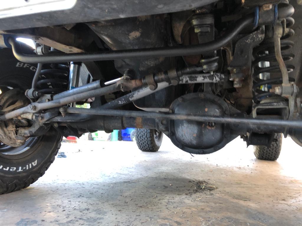

This is where I’m a little unsure. On my current set up with the heim joint, the pivot point is below the bracket but on the IRO double shear I’m considering the pivot point would attached into the bottom of the bracket. I’m curious if the 3/4” drop basically just accounts for that difference and would still be pretty much level.
Can you share some pictures of your steering and track bar. Directly from the front and pictures in general of what youve got going on.
The zj pitman could help or could make it worse depending on what youve got going
First realize that the RE 1600 trackbar is one of the worst. I've had my RE 1660, 1665, and 1670 now for over twenty years!
