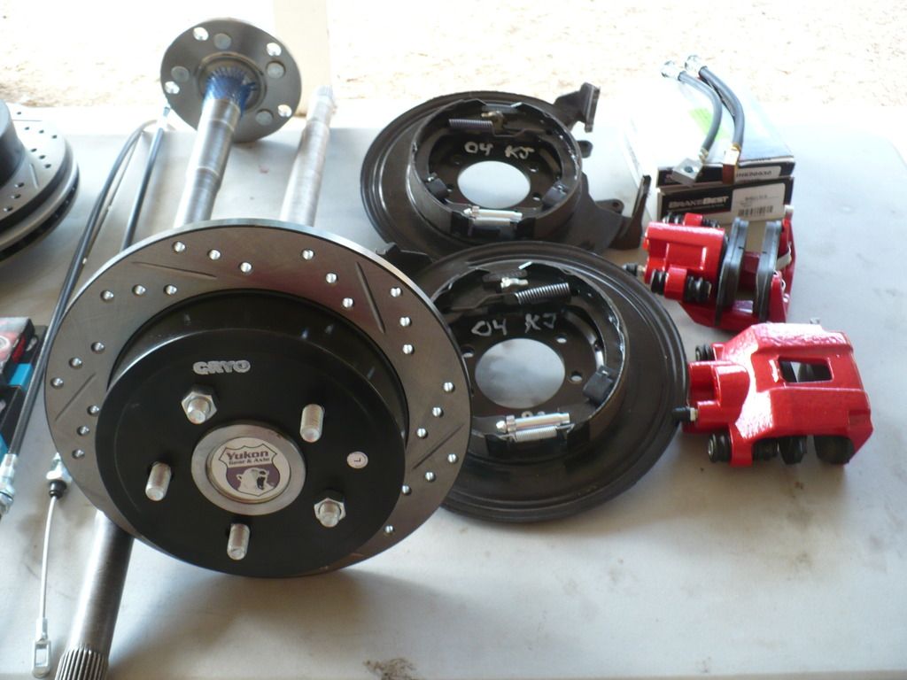

Just curious, any pics of brake lines/ e brake set up?

Didn't take any pics but the brake lines were easy enough to just bend by hand where I needed them to point. I cut the mounting tabs off of the stock ZJ soft lines to free up some room.
