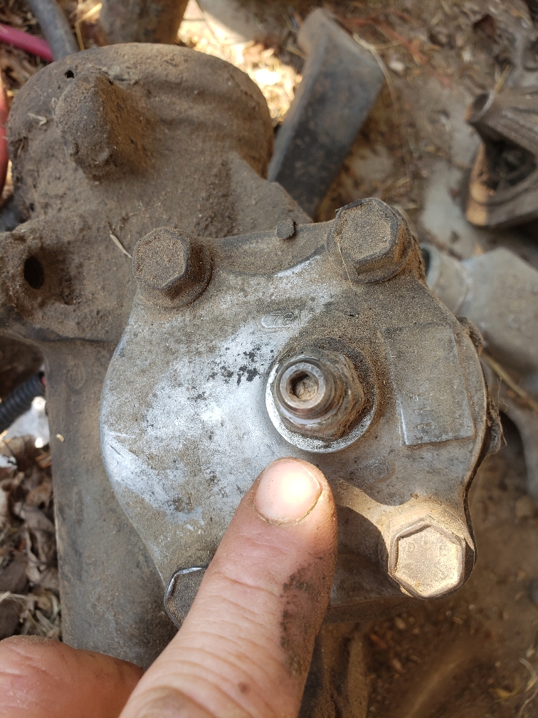

At lunch I got on the topic of Jeeps and XJs. Guy had a pic on his phone of one that was hydro ported. It tapped on the front cap and then one of the top bungs was threaded. ???
He's on 33's. So, aired down for wheeling needed some additional help at time.

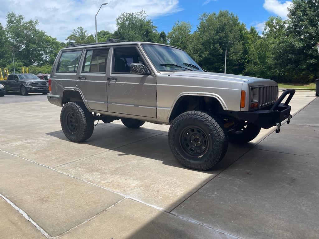

I forgot to post my build specs lol
2000 Sport. OME 3” lift with 2” pucks up front to level it with the rear leafs. I went with the 2” pucks because the rear leafs are apparently made for overland setups, and well.. I’m not doing an overland. Adjustable RC track bar is stock location, IRO HD tie rod and adjustable upper and lower CAs, new steering link, new(to me) front axle that’s fresh on fluids. New Falken Wildpeak AT3W 31x10.50R15.
For a $1000 Jeep and maybe $2000 in parts, i can’t complain.
I’ve seen that too. Muddy beards off road on YouTube did a video on it. It looks like it’s pretty inexpensive too
