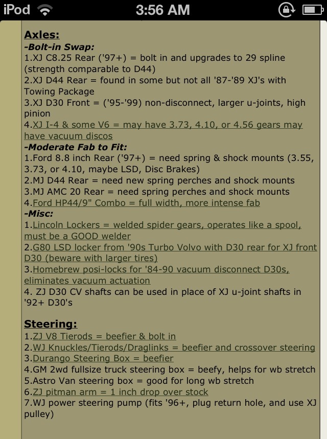

I know this is oem section but if my pump is out, what if I got a wj? Reason for asking is this
At the bottom it's saying to do a cheap upgrade is a wj pump. Are they stronger than the stock Cherokee pumps?

Got the belt tensioned to 140 from the krikit, sadly though, it still squeals like a pig after its warmed up. After tightening it I took it for a spin, got it going and then came to a stop and tried turning the wheel and it just screeched, could just barely turn it compared to before but I'm taking it as a sign I need a new pump. Reason for asking to move to mod is because since I'm on the hunt for a power steering pump, I want to bring up the question about the wj pump, is it better? Or should I stick with a stock pump?
