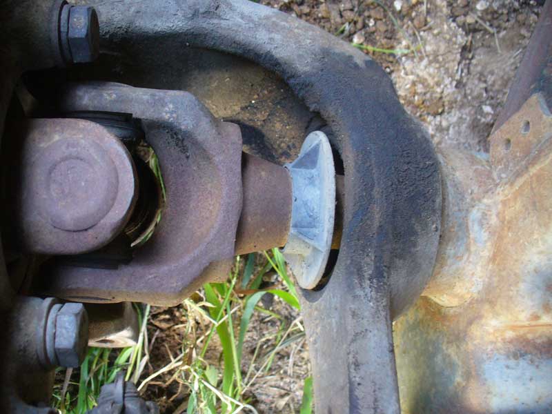

And on a tangentially related subject, I noticed that this "new" axle does not have the plastic dust shields (or whatever they are supposed to be) at the point where the axle shafts enter the inner Cs. My old axle has some plastic flanges there. I suspect they were left out because they would not fit the shafts on this new axle. These shafts are machined differently, I am guessing they are aftermarket. I am wondering if the lack of that bit of protection has anything to do with the failure of the seals and if I should be looking for some sort of replacement.

A lot of folks cut those little plastic flanges off their axle shafts- they don't do much at all for keeping stuff out of the tubes. I'd suggest that while you have that D30 apart you weld some mini skids on to your LCA mounts and add gussets to the C's. You'll probly melt your BJs during that process, so you might consider new ones. This is all much easier with the axle removed from the Jeep.

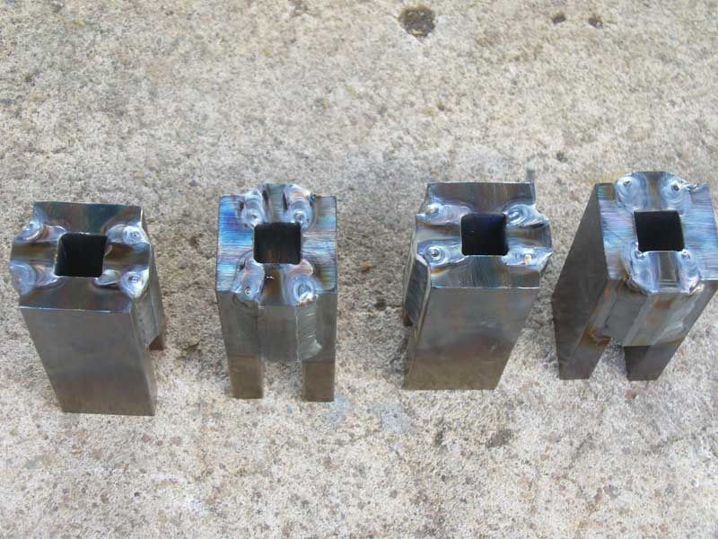

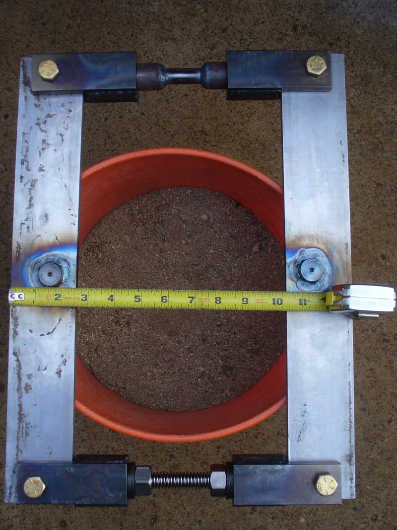

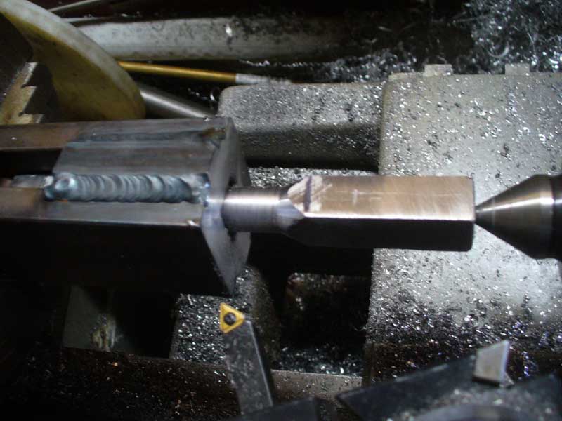

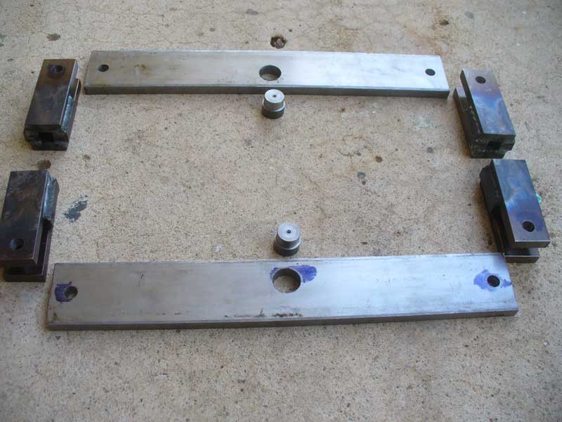

I think I have what should be a workable case spreader. I haven't finished with my mounts for my dial indicators, but I don't think those will take too much more time. With any luck I will manage to take care of this job tomorrow.
Never having played with a case spreader I am not entirely certain of what I have built here. If anyone sees any likely problems then please speak up. Here is what I have done:
Sides of these are 1 1/2" x 4" x 3/8" thick, spacers are 5/8" square x 2" long, leaving me with a 5/8" square hole in the center. I probably could have left off the welding of the faces, but it just seemed too inviting to not weld it up. Just meant I needed to clean up the faces afterwards.
Here is the cleaning up of the faces:

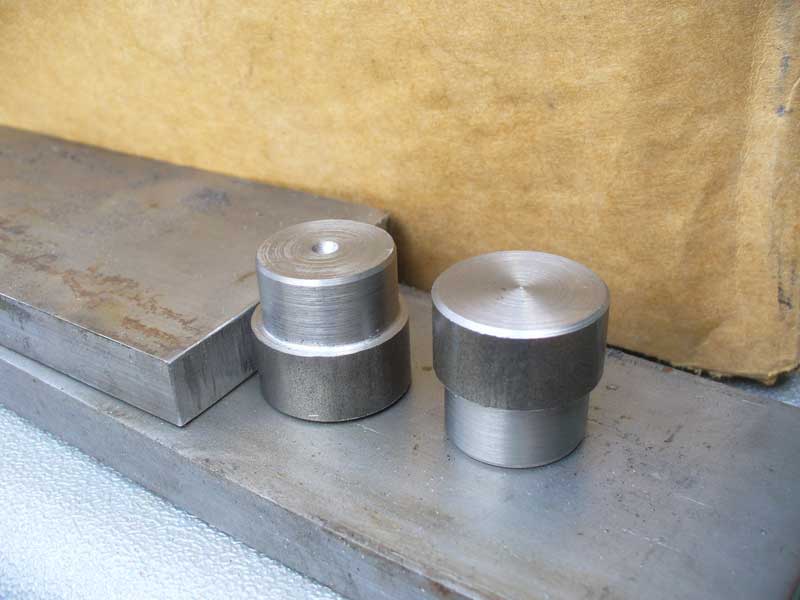

I made inserts for those two holes that seem to be at the side of every Dana axle. 7/8" is what they measure. I could not find 7/8" round bar on the shelf, so I turned some 1" down. I found 7/8" was actually not going to fit, so they are about 1/64" undersized. Still a pretty tight fit, but with some effort I can get them in.
Here is the layout of most of it (before the faces were cleaned up):
This is the full assembly. 5/8" acme threaded rod for the bottom. 5/8" round bar with DOM stops welded on. I have a full 2" of engagement both top and bottom. This should be pretty close to the right width for a Dana 30, and I should be able to safely open it up another 2" for a larger axle. I haven't measured to see how wide I need to be able to go in order to accommodate a Dana 80. If I need to I can make wider spreaders pretty easily. The end pieces are the important parts. Bolts in the corners are 1/2" Gr. 8.
Look like it should work?
Re: Project Scope Creep: Educate me on R&Ring an ARB locker in a D30
I doubt youll need it but it seems good

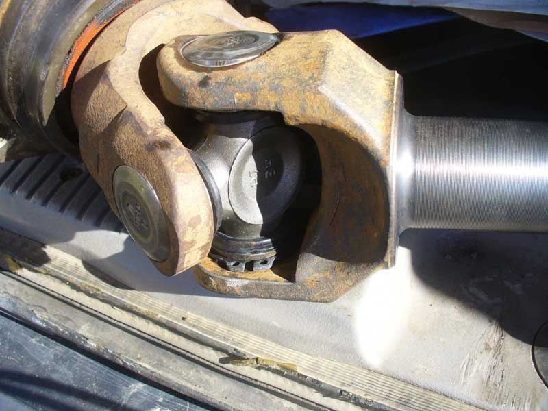

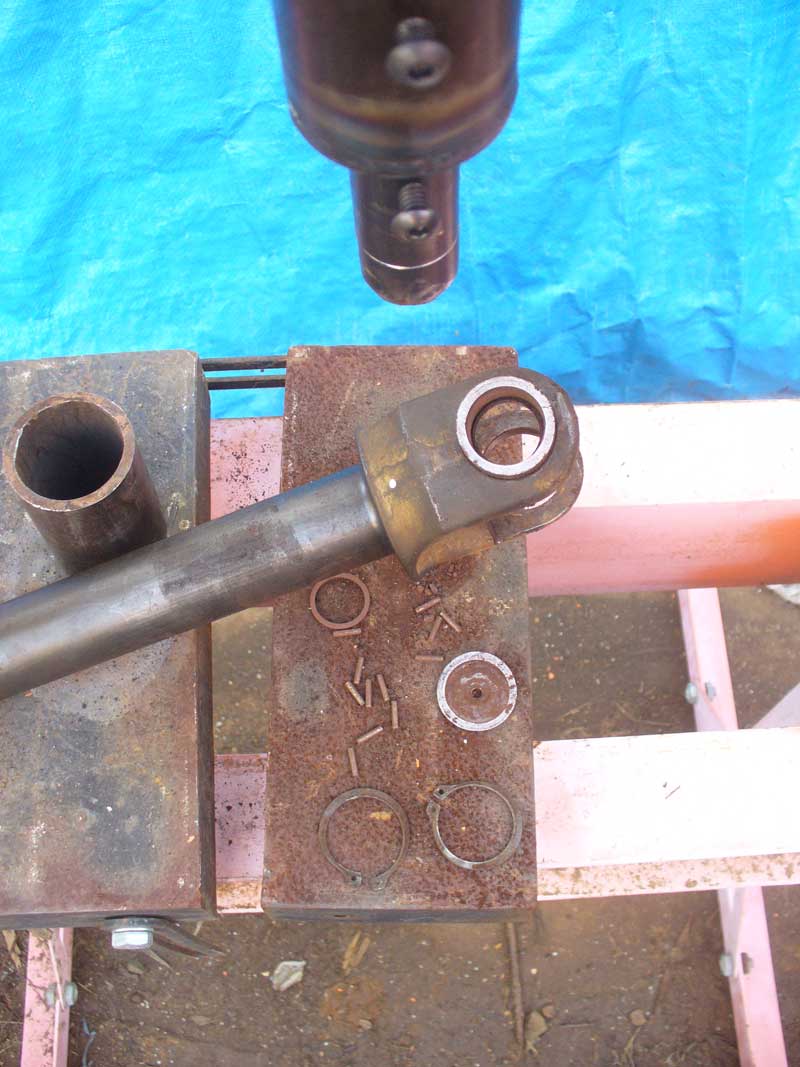

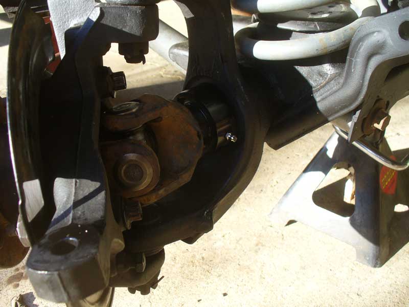

With the free time I got during Christmas I got the axle mounted into place and the U-joints in the axle shafts replaced. I understand these can be done with a hammer, but I opted to use the press instead. No problem pressing out the first cup on each side, but twice I had this happen while trying to get the second cup to go back out the way it came in:
Replacement full circle clips needed to be found. They are an M30 and can be obtained from Fastenal. Three to a package.
I wanted to pick up a set of bent nosed external ring pliers at the same time, but those were not available. A pair of screwdrivers does the job, just not quite as gracefully.
I know opinions are mixed on the subject of a seal at the outside of the axle, but given the joys of pulling the carrier I decided that $50 for a pair of aftermarket seals was a minor risk with more potential value than loss. We will see how these behave long term.

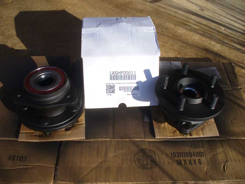

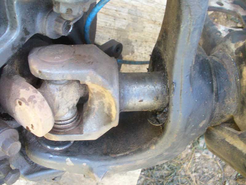

The last detail was the unit bearings. Messing around with the axle shafts I could feel that the old bearings were done. The fine red dust around the axle nuts/retaining rings/cotter pins should have clued me in. Plans call for WJ brakes, so I didn't want to buy premium bearings. I ordered a pair at $50 each from 1A Auto. Spray painted them so I can distinguish my rusts down the road:

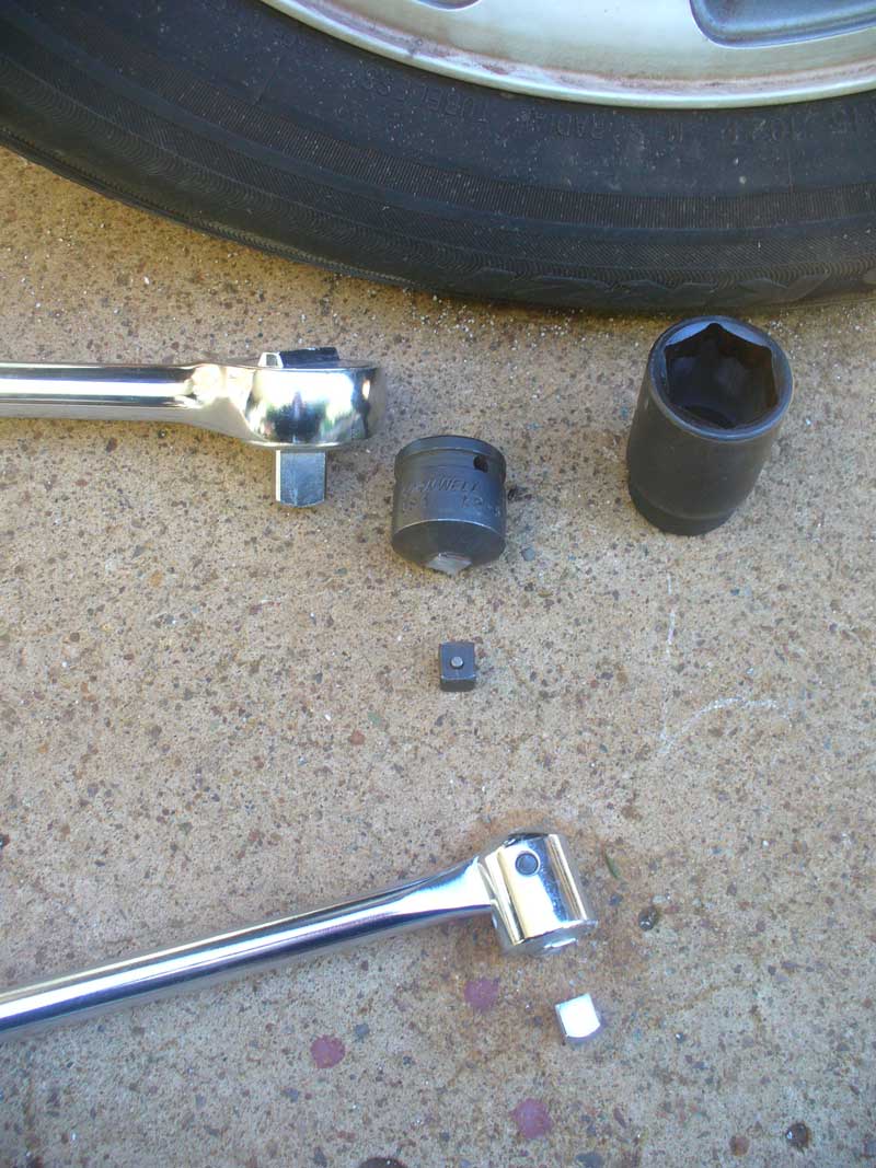

Thought I would be all done this afternoon. Even toyed with trying to make it to the Adopt-A-Trail tomorrow morning. Figured I really shouldn't because I will not have had a chance to check things out yet, but that dilemma got solved for me without question:
Napa is supposed to have a 3/4" drive 36mm impact socket arriving for me tomorrow morning. We will see if I break the 3/4" drive too. I am guessing whoever put this together had no way to measure torque and so just went to town with an impact. If worse comes to worse I may have to find someone with an impact in order to get these things apart.
