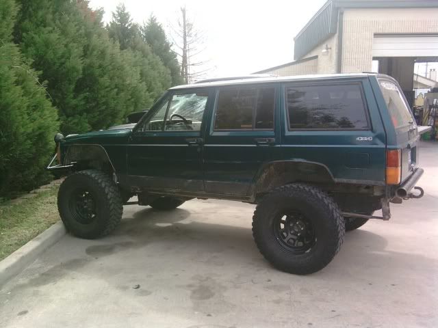

Okay i may seem ignorant... And for the most part this is going to be because i am .. Sorry in advance..
I Just got a 95 Xj this weekend.. Traded my dirtbike for it Because my knees cant take riding anymore and i have had a blast the few times i have been..
Anyways.. Any input will be great..
I will start out with what i know.. (This is not much) Go easy on me i know about cars... But all i have every done is old cars.. My 69 fairlane500, a 65 mustang and my 1970 gmc that is almost done... But i know nothing about lifted anything lol...
Anyways the jeep:
1995
inline6
auto
5'' lift is what i was told... on 33'' tires
Has dana44
and quick connect sway bar...
Now the problems i am having that i dont know how to fix... (Rear end needs a bearing and seal.. Needs new brakes pads Are the other problems but no big deal i know how to do that lol)
This thing drives like shit on the road.... You hit a bump and you would think you are going be tossed off the road... (Drives great in the mud up hills, rocks and everything else That you do going slow)
But on the way to the shop where i do most of my work i was scared to get this thing over 40 unless it was a perfectly smooth road...
What do i need to be looking for? What should i do?
Atm i am on a very low budjet... But want to get a list of things going that i should do...
Here are some pictures and i can get more of what ever you like to help you guys help me!
Thanks cant wait to learn about what the hell this thing is! Lol

You need to check all of the front end/steering parts for play. It sounds like the usual "death wobble" type issues. It also sounds like there is alot of bumpsteer. This is caused by the angle between the drag link and the trac bar being different. This can be addressed by possibly a dropped pitman arm or relocating the trac bar.

I'm no expert, but you may want to get some shorter rear shackles. Those are huge and it looks like your leaf packs are really flat.

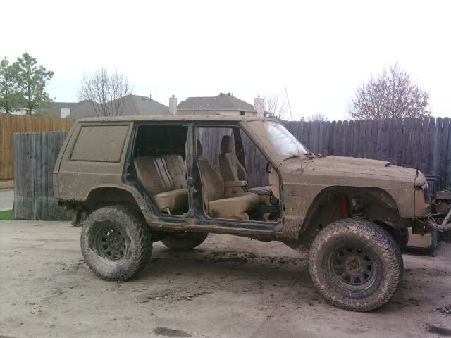

Originally Posted by shawnxj View Post
make sure the front axle is centered on the vehicle from the second picture it looks like it's being pulled to the driver side.
Yeah got down there last night its a stock trac bar and it does sit to the drivers side... Suggestions?

And yes the shackles are huge and will be addressed in time... At the moment i am just trying to get this thing to handle a little better up front.. And fix a few things that need addressed first..
