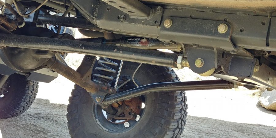

You are wondering why aluminum arms vs.steel? When steel bends it stays bent!
This is my BDS lower control arm after hard wheeling! Aluminum arms are lighter as well as they will bend back into shape vs bending under big impact. I bent one of the lower steel arms in my BDS 4 link kit, and when I decided to replace them I went with aluminum ones.
So, are you saying that aluminum arms are stronger than steel? or that they have more "give" or flex to the actual metal arm?

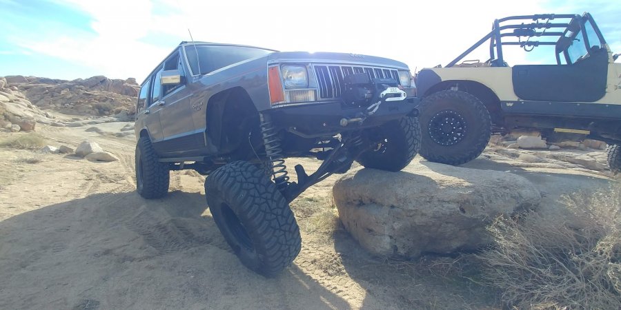

That is an awesome build. Very nice!
