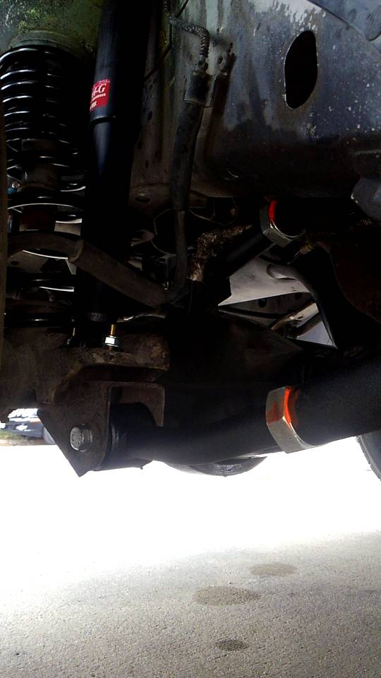

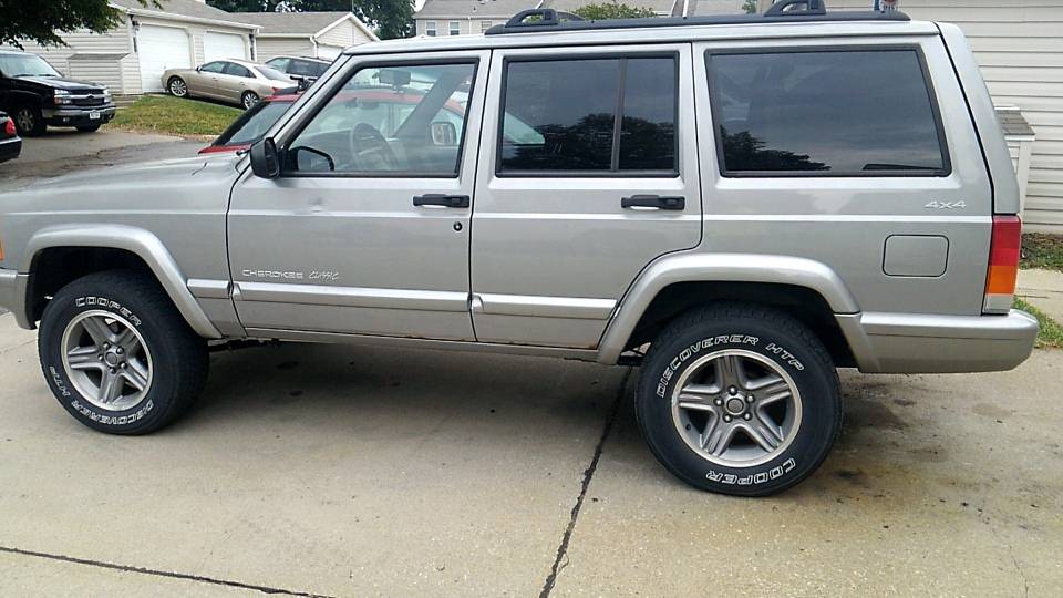

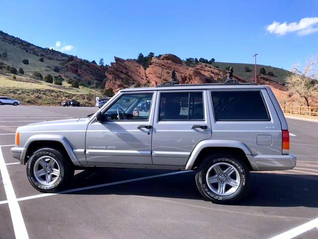

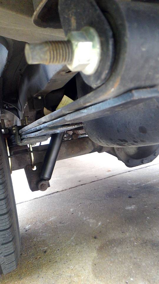

Regarding the CC782 V8 coils, I just finished the refresh of the suspension today about lunch time with my oldest boy. I think they work great and tide is firm initially but am sure as others have mentioned, they will become more compliant in a month or two. Along with that I did the rear Husky leafs and added an OME add-a-leaf. (Have the 2930 coils and 033rb packs and other goodies collecting dust for another day) I'll attach a couple photos from today and one from purchase about 2 years ago. 225k on her today and she is like Brand-used now! It's a great budget move and similar to Upcountry package. I'm running 225/70-16 now and have 245/75-16 to mount in a couple weeks.

Before
After

Shawn57nomad not sure about others but the photos are not showing for me.
