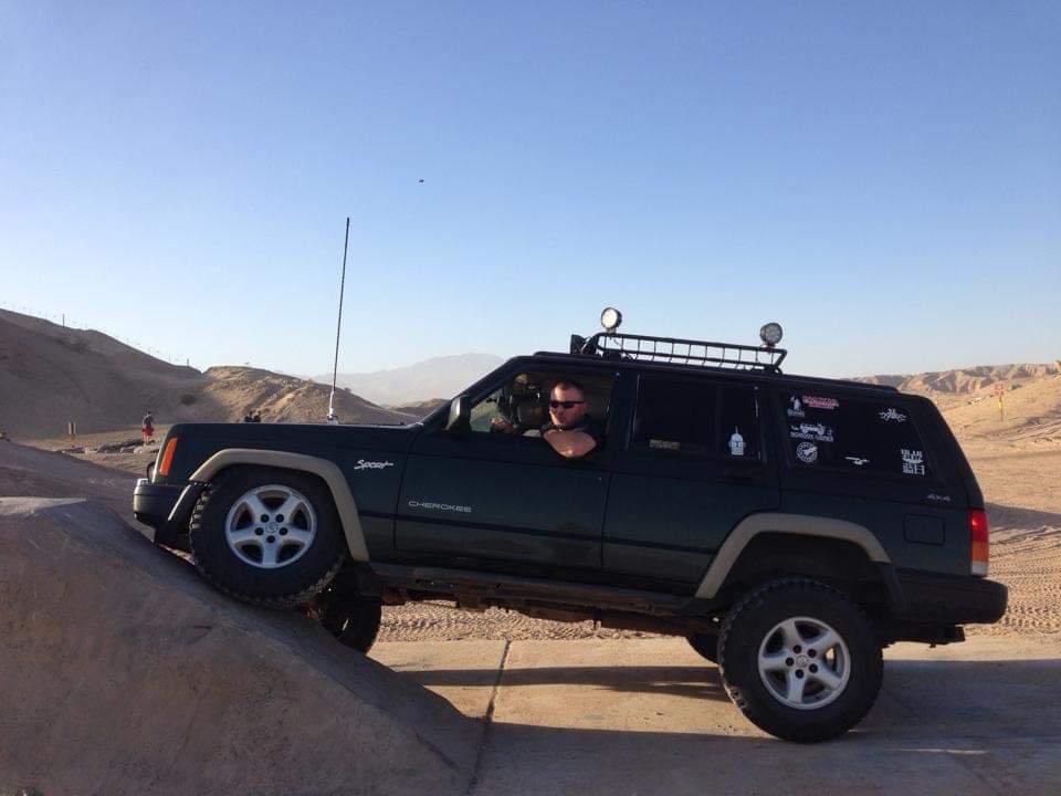

Ive had them on two XJs. They ride pretty stiff for a month or so then soften up a bit.
This is my last Jeep, a 97, at max flex with swaybar disconnected. MOOG coils, Crown HD leaf springs and Monroe Oespectrum shocks. I am seriously considering going to OME shocks on my current XJ but havent pulled the trigger yet.
